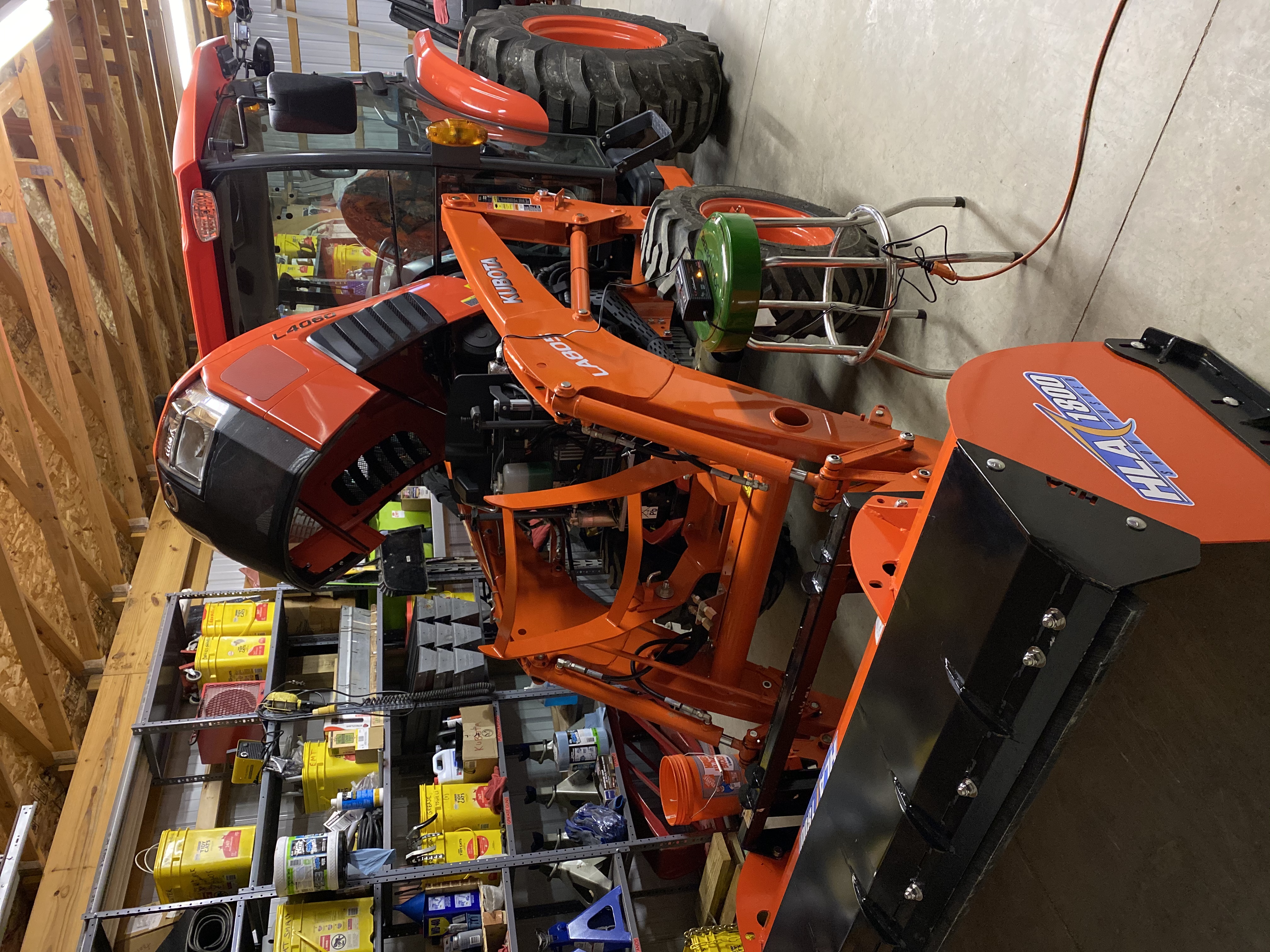

Here is where I installed mine (left side):
