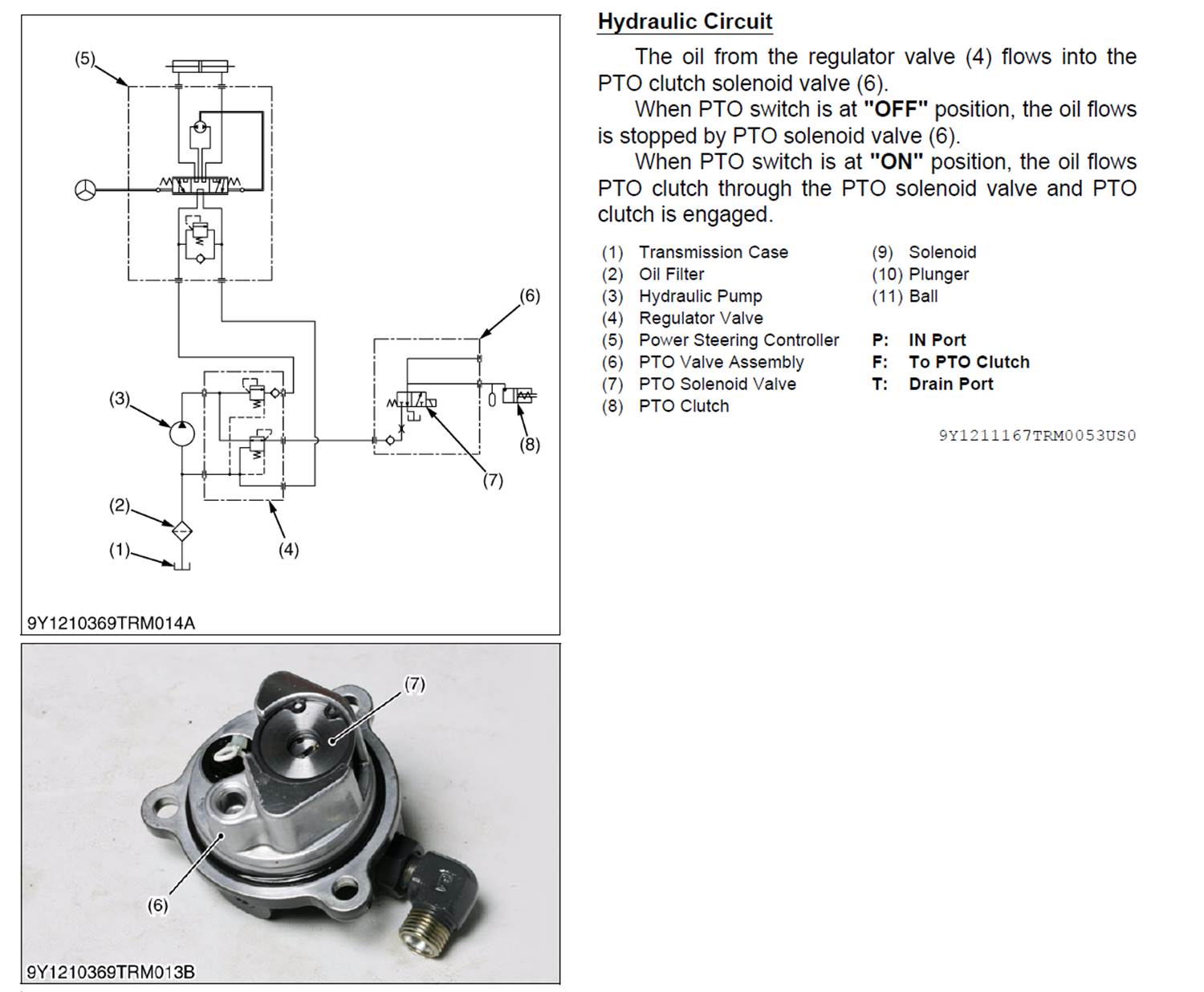

/ L5740 PTO Switch Sticking #5
Firec,
Do you have a WSM manual? The PTO solenoid valve is referenced in the Transmission section. It looks very easy to access. Hopefully the attachments below will help.
The yellow switch interfaces with the Intellipanel and shuts off the lamp. It then outputs a signal to the PTO Solenoid Valve.
Looks like a hydraulic line needs to be removed along with 3 bolts. There appears to be some O-rings that may give some resistance when removing.
Good luck and let us know what you find.
