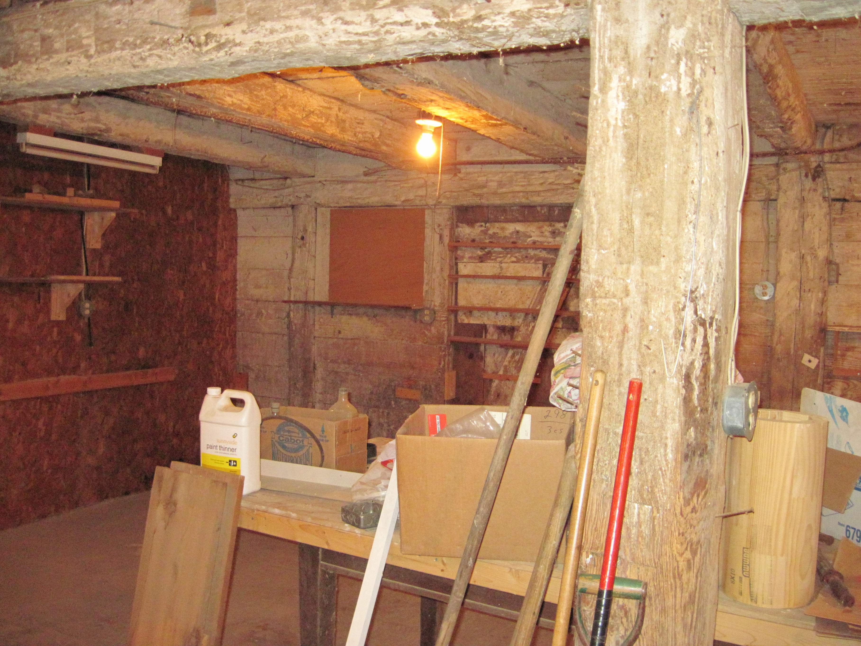

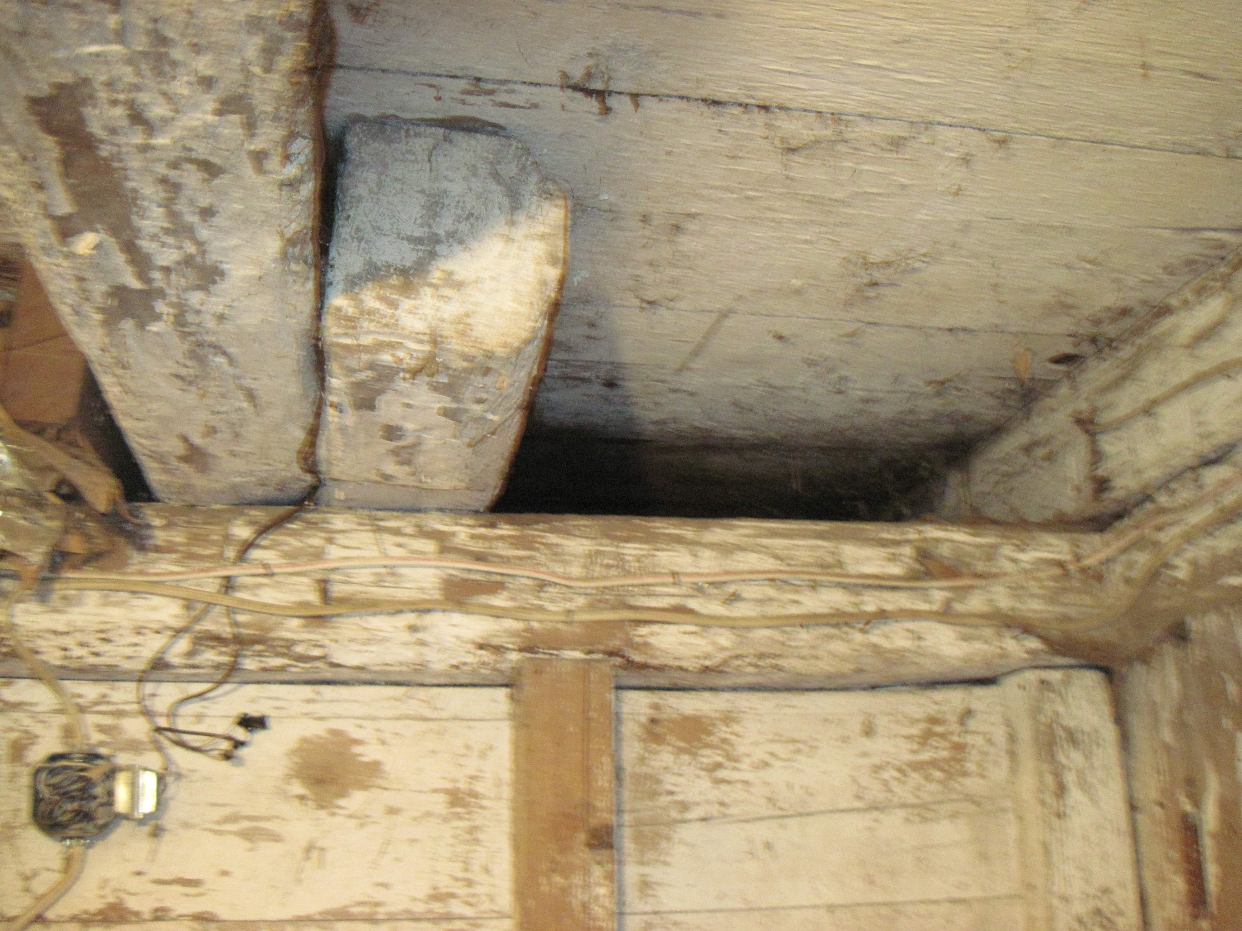

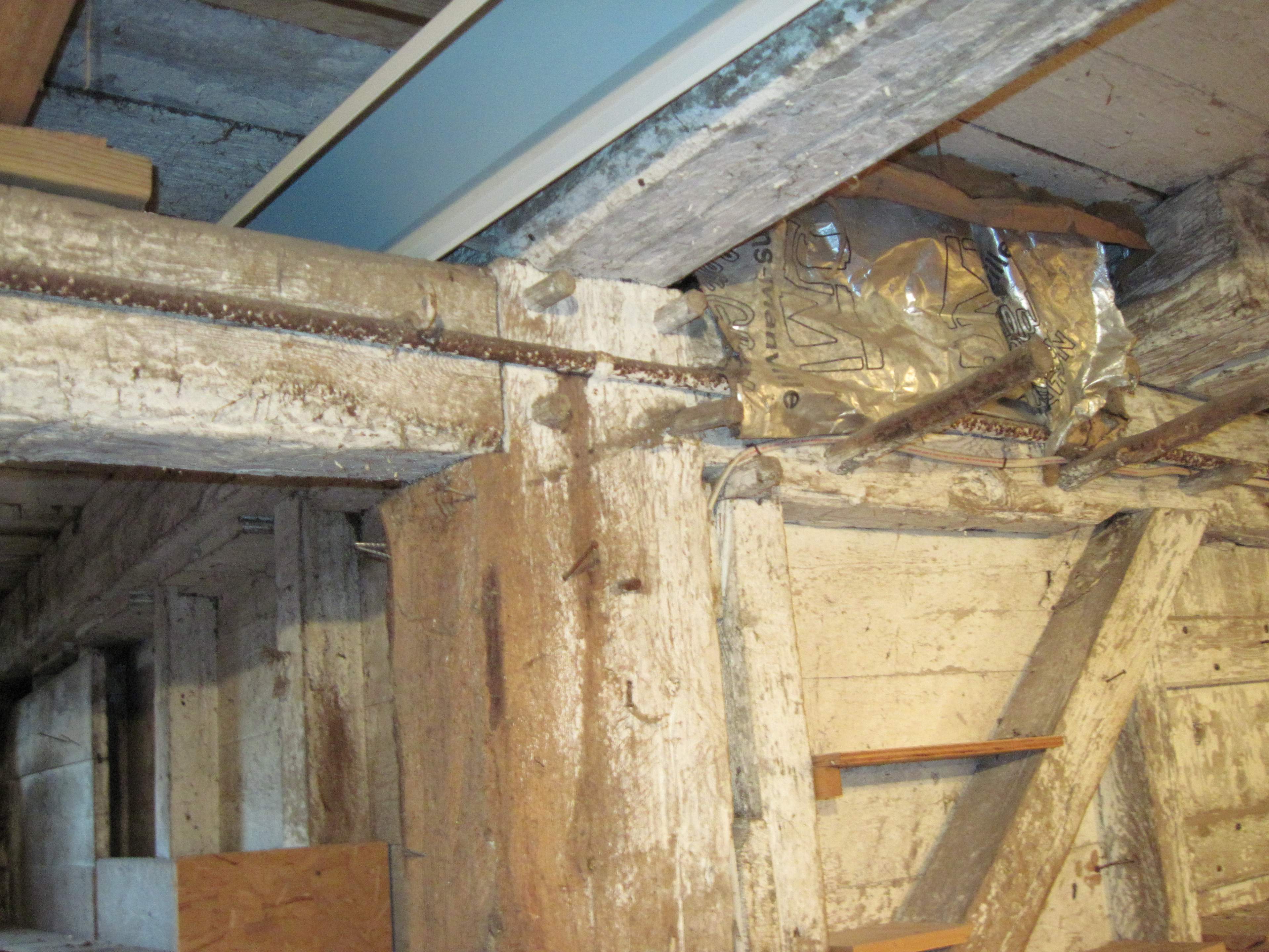

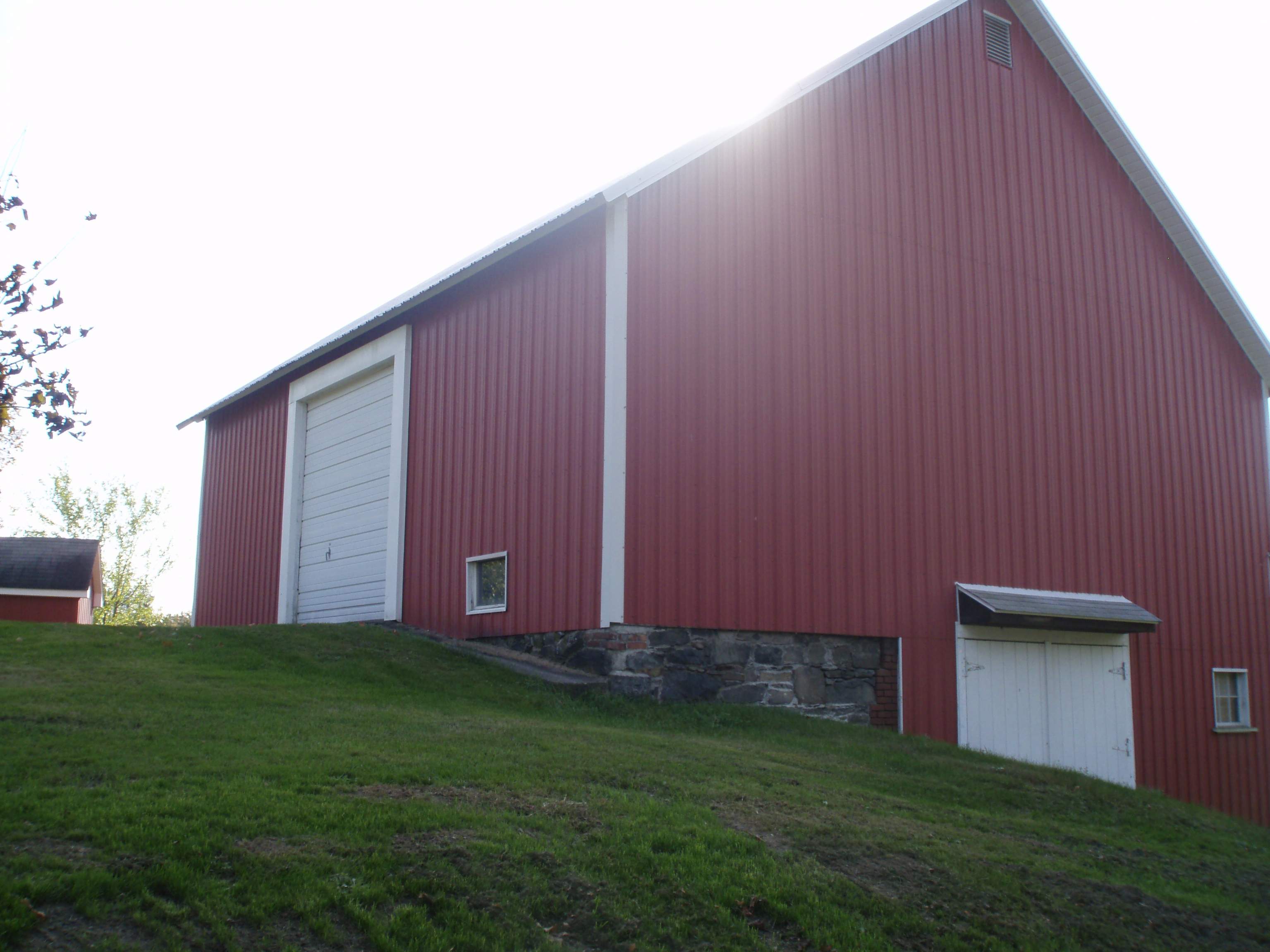

My Problem, Again--Is the SECOND FLOOR (i.e., wooden planking) of the Barn Strong Enough for an "L"? Or Even a B3030HDCC?
We have just purchased a house with an old "post and beam construction" barn, which the owner beautifully re-skinned, 10 years ago (he is a contractor) with laser-straight steel siding and roofing.
My question has to do with the ability of this barn to handle the weight of an L5740, with FEL and 8' Woods hoe, plus 200-600lbs. "on the hook" (hoe). We understand that there are "barn experts" that may come, for a fee, or just for their own edification/enthusiasm, to render opinions, educate the owners, and generally help preserve these vanishing, beautiful buildings.
However, I haven't found this expert yet, and I'm afraid the tractor I'm interested in might "slip away" if I don't make an offer on it, prior to getting my "barn expert's" expertise.
So that leaves you guys and gals! IF you're interested in reading a novella and then offering commentary, of course. LOL :)
The barn is 38' by 40' by however high (50'?). However, that interior space, on the second (upper, wooden-planked floor) is LARGELY EATEN UP by these weird, approx. 10' x 10' "quadrants," that are formed by 8" hand-adzed beams. These "quadrants" take up the outer, four corners of the barn.
These "quadrants," (please go see my next post, which has a poor pic of the end of one, looking from the center of the barn, near the overhead door, on the second floor) with their low, 3'-4' high "parapets," are really just made up of the 8", hand-adzed horizontal beams, and the material you see UNDER that beam are just simple barn boards, not holding any weight. The WEIGHT, if I understand what I'm seeing, is that, downstairs, somewhere under that horizontal, 8" beam, are 10" vertical beams, sitting on the original concrete of the barn. (I'm sorry the pics aren't better--I can possibly find some more later.) You may be able to see the brighter, yellowish END of one of these 8" horizontal beams, where the P.O. chainsawed them off.
Originally, these 3'-4' high, 8" beams ALSO ran ACROSS the floor of the bar, so that you couldn't have driven anything from the front of the barn to the back (I don't get it?). The P.O. cut them with a chain saw, and he said they "were so hard they were almost petrified--you should have seen the sparks flying when I sawed them." And since he's a successful, 60-70 y.o. contractor, and this is a "post-and-beam construction" barn, I'm SURE he'd have known it if he was hitting nails with his saw. IOW, this wood is TOUGH.
But does that make it strong? I dunno.... The barn is straight as an arrow--he said he had to do ZERO "furring strips" before he ran is 7/8" x 4" horizontal "stringers, that he then bolted to, from the outside, with gasketed hex-head bolts, to hold the skin on, 10+ years ago.
After he removed those lower, 8" beam "ties" that connected each quadrant to it's cousin, across the barn, and then he compensated for this by installing 2" x 8"'s (or 2" x 10"'s?), overhead, in a "collar tie" arrangement, so he feels he adequately made up for the removal of the lower beams, so that, again, one COULD drive straight in, to the back side, IF one trusts the barn planks to hold.
The pic showing the modern, metal, overhead door makes it look like that door is 14' high, but it's not--it's only a 10' high door. IOW, the barn looks GIANT in these pics, but it's still only 38' x 40', but it's cute as a button, and has a lot of charm, downstairs, with a "milk room," and all the various treasures and delights that those who appreciate barns, (as I do, but I know BEANS about their construction and strength), do.
As I will mention later, he parked a 60's AMC "Scrambler" (3,000lb--I looked it up) just inside the overhead door he installed on one side, which I described above, which also gives you the only interior view ofthe barn, with one ofthe cut-off "parapets" showing.
But he did not feel comfortable driving it any deeper into the barn. He even reinforced the floor, JUST under the car, as I will explain, as he obviously felt he was "pushing it."
If you look to the extreme left hand side of the photo marked "10 Inch Beam, Downstairs," you can just make out the dark, end of one of two 4" x 6" beams the P.O. felt necessary to hold up his 3,000lb. muscle car. But LOOK how the thing is built, generally!
For those of you NOT familiar with the "Post and Beam Construction" method, it uses "mortise and tenon"-type wooden joints, literally PINNED together, as you can see, IIRC, by FOUR, vampire-killing-spike-shaped wooden pegs at that joint (for any of you "Dark Shadows" fans out there--I know, showing my age). Generally, I've noticed there's only TWO such spikes at most junctures, so that one must have been something special. The
Also, if you look at the photo marked "General, 3' On Center, First Floor, 8 inch Floor Joists." you will see what I mean about me not worrying about falling through the whole floor with the tractor--those floor/ceiling joists (what are they called when you're downstairs, CEILING joists, I guess?) are, to my eye in the photos, and my memory, about 3' on center, and, like the rest, 8" hand-adzed. (Only the vertical members seem to be 10" and NOT ALL of them ARE 10"--some are only 8", IIRC, but I think MOST of the vertical members, downstairs, ARE 10".)
If you will see the photo named "Downstairs, Livestock Area--Brick Wall," you will see that there are a fair number of BRICK WALLS in the downstairs area. I'm an English Major, with a grad. degree, who likes to work on cars--I CANNOT TELL if these are "load bearing walls" or not, and I guess if they're not under where the P.O. used to park his Scrambler, OR, more importantly, WHERE I HOPE TO DRIVE THE TLB, then I guess it doesn't matter, but it still feels like there's a lot of strength here.
I have a business model in mind that would involve me placing not-so-heavy items inside these quadrants, for storage, by lifting them OVER the parapets, with the hoe--probably with those neat "T-hooks" (or "J hooks?) that I saw on here on TBN that had cut holes in their hoe bucket for.

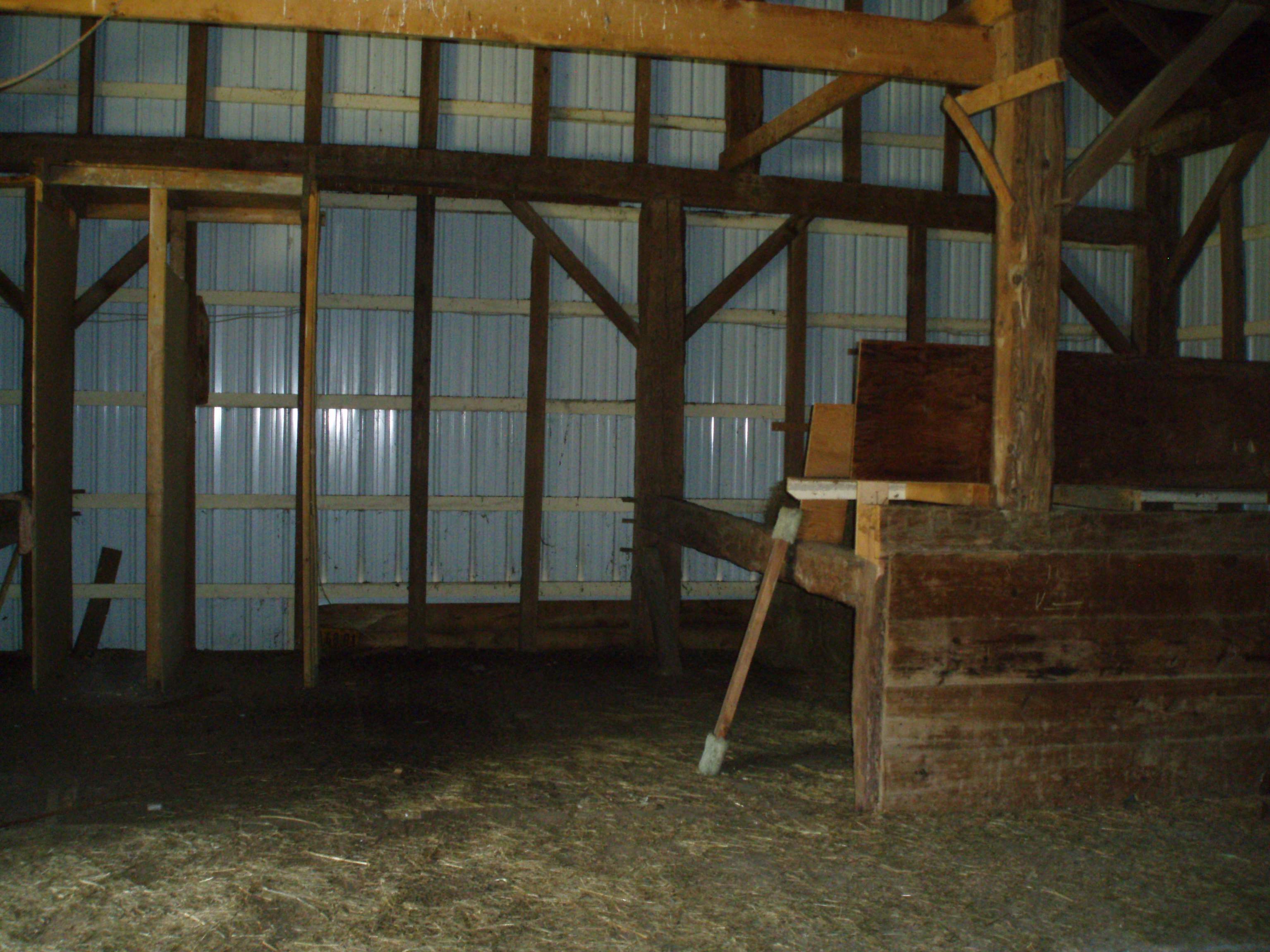

The barn originally appears to have had a third floor, as most barns do, for a "hay mow." I don't know if or why the P.O. removed this, but it's gone--all but for the beams which held (part of?) it up, and an old ladder, made out of TREES, runs up the side, to the peak of the roof.
I don't know why it was done that way, but these hand-adzed "8" quadrant" beams (which enclose each 10' x 10' "quadrant" do NOT look like any more can be removed--apparently, they went ALL THE WAY ACROSS THE BARN FLOOR, at like 3-4' high, but the P.O. DID cut them so that there is an open area to WALK around in, to reach the quadrants.
The bottom floor of the barn is poured concrete, which the P.O. re-did in a section (for smoothness?) for a workshop, but the rest is the ol' rough, strong stuff-which is fine.
The upper barn floor has the traditional, uneven-width, up to 16" wide x 2+" thick planks, but the P.O. only parked a 3,000lb muscle car JUST inside the overhead door he installed, and he reinforced the upper, planked-wooden floor, by "sistering" in, UNDER the second floor, two 4" x 6" wooden beams, under where his AMC "Scrambler" sat, and he was apparently afraid to drive it in more than he needed to to shut the garage door, best visualized by looking at the tall, overhead door (in my follow-up post, unless all 8 photos will fit in this one, and I just don't see them?). He drove in just far enough to shut the door, and that's as far as he dared go.
Since he is older and wiser than me, not to mention a contractor, I come, hat-in-hand, to the collective "BRAIN TRUST" here.

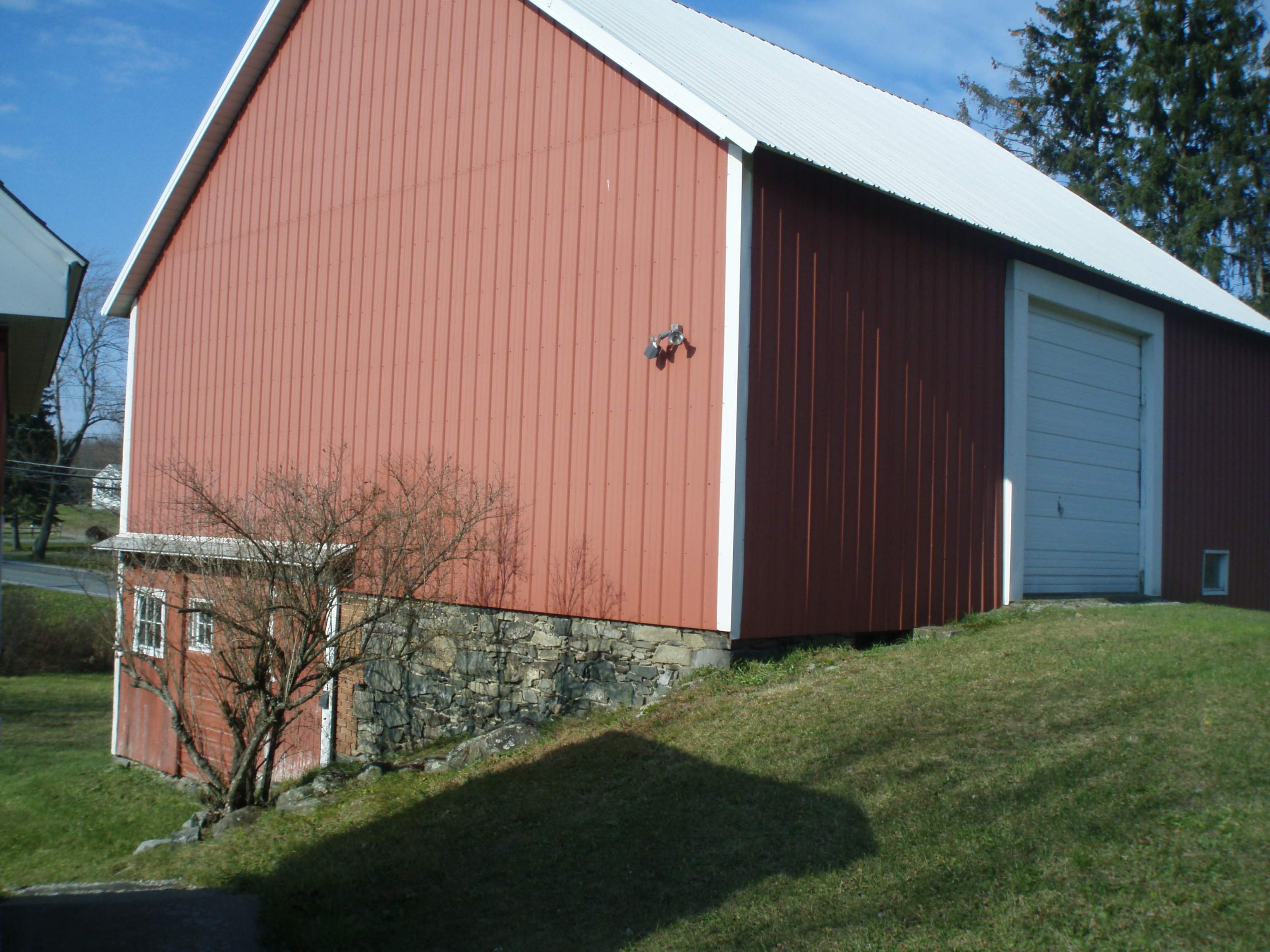

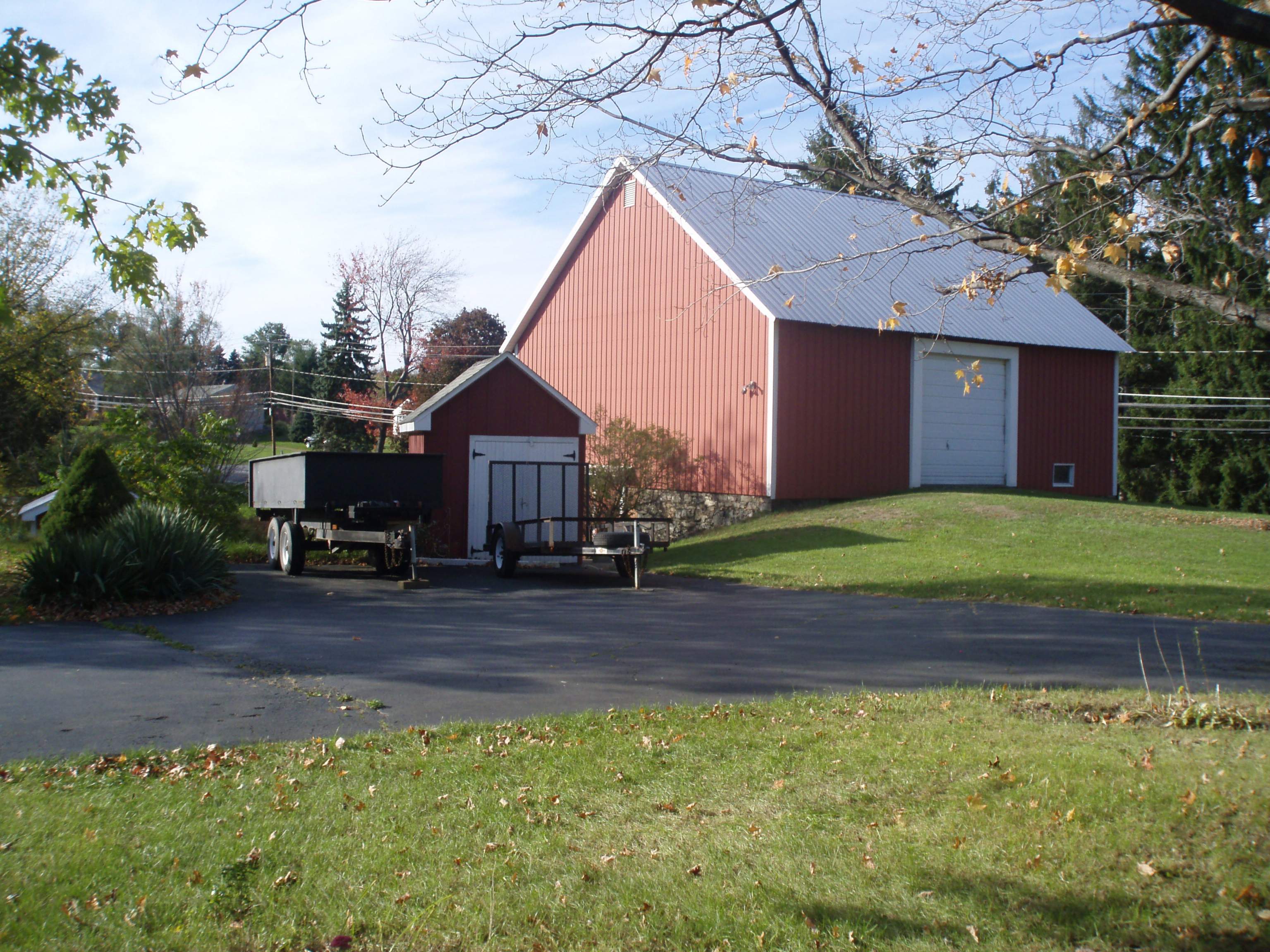

Okay, here's the first group of photos I originally uploaded, that got bumped, and show the outside of the barn.
Unfortunately, I REALLY should have seen that the "Parapet Photo" had gotten bounced out of my original post, as I'm sure that would have made things much easier.
The photo lableled "Barn Parapet" clearly shows one of the four, weird, 10' x 10' "quadrants," at each corner of the barn. I believe this is the right hand side of the pair that you would see at the back of the barn, if you pulled your AMC Scrambler into the overhead doorway.
The yellowish end of the original 8", waist-high beam shows where the P.O. cut it--as I said, he cut TWO of these out. Looking overhead, however, I believe you are seeing a 2" x 8" or 2" x 10" plank that he used as a "collar tie," to replace the missing strength from the missing 8", waist-high "cross beams that were original to the barn.
18. How TALL is a cabbed, L5740? I hate to keep asking all of these dimensional questions, but I find Kubota's official site unhelpful, at best, compared to that Great Plains site I showed you guys (shown to me by a fellow TBN'er).
19. If anyone can tell me how to get that side-by-side, spec.-per-spec. page up, on Great Plains Kubota, again, I'll be eternally grateful.
The P.O. has since swept all of the hay, so the planks are visible, and looked rounded-edged, but BEAUTIFUL, but that had not yet been done yet when the pic was taken. It also looks a little "dingy," as he, by not living there for the three previous years, was unaware of an infestation of bats (in a tight, metal building--arrggh!) but they're gone now. We plan on having professional remediation done, as I understand their feces can be toxic--and there was a LOT of it. I put a "basement window bubble" over the only open window IN the barn, in the "Torture Chamber," so I'm hoping that's where they were getting in.
20. So--do I dare test it with a machine equal to the weight of an L5740, with bucket's dragging for safety, or don't even bother, because I'll break a plank?
I do find it odd that there's so many brick walls in this barn, especially the one room in this barn that's got brick on two sides, and bedrock on the third (i.e., the "Torture Chamber"). The inner-most side is wooden, but I find so many brick walls in a barn unusual--am I correct in that, or is that normal?
I also thought it adds strength but again, if the planks are going to break, the brick walls don't matter, as they're necessarily over the bricks.

Lots of reading there:
Tractor stuff first.The L5740 is a Grand L,has the tilt wheel,HST+ ect.Is a four cylinder,400 hrs would not bother me at all.I have a L4240HSTC with the 854 loader and loaded R1(Ag) tires...I figure it weights 6500-7000lbs.The L5740 may be slightly heavier. Price?,that tractor may have sold for $37,000 new don't know if the asking price is fair or not..
The barn:We have a similar barn,but not with a drive on floor.Ours was built in 1860,post and beam.I would not put anything that heavy on a barn floor that old without having a structural engineer look at it.
On the Kubota QA...they use Skid Steer mounts.
   / L5740--Need Opinions on Value--Have Pics! #4
To answer your question. only you can determine if it will hold the weight.
if you have any concerns just buy steel columns @ lowes and some timbers or steel I beams to support the floor where you will be driving or parking.
also rough cut lumber could be added to you floor as a driveway path instead of plywood
Ask the original owner if he ever parked equipment in the barn and where/what it was
As to a L5740 I have one.... other than a cough of smoke on startup its been great.... higher rpm than I was used to coming from old iron gas motor. highly recommended on this site as a great machine.
   / L5740--Need Opinions on Value--Have Pics! #5
You could place dimensional lumber such as 2x10's running in from the door as a track for the tires to ride on (2 laying side by side for each track, staggering the joints, with the ends meeting over the lower supports). Much like the old country bridges.
This would solve your concern of going the the planking. As to whether or not the barn would support it, buy or rent a number of basement support poles, and temporarily support the floor from the basement. Just put enough tension on the posts to keep them from falling over.
Load the floor with either your new tractor or a vehicle of similar weight, the slowly start to screw the jackpoles as if you are removing them.
Have a few 4x4's cut to barely fit under your supported floor. As you lower the posts, if it sags to much your 4x4 will become impossible to remove. Replace the jack post, and then use another 4x4 that is a 1/4 or 3/8 shorter. After lowering the post, if you can remove the 4x4, that section is holding well.
If the floor settles the 3/8" solid onto the 4x4, your floor can't support the weight.
Of course this is a simplified version of the process. After you remove one post, you still have the others to remove one at a time. The 4x4's will be the fail safe in case it starts to collapse.
This is how I would go about testing the floor. Be safe, always make sure you have a clear escape path and don't work alone.

Ok, first of all, I read every single word, and there's no way I can answer all of those questions, but I'll try and get most;
The main one: Would I park any of my tractors in there? Nope. Not even a lawn mower. I don't trust those old barns. My grandmother had one of these really old barns with two floors and I was scared to death every time I went in it. They had horses on the bottom and equipment on the top, though nothing has been in it the last 20 years. Not only would I be worrying about my nice tractor to end up on the bottom floor, but I'd be worried while I was on the bottom floor that my nice tractor would be on top of me. I'd keep the idea of that 5740, but I'd look at making a lean on part of the barn on top that looks alike on top, but it would be supported by mother earth, not a 100 year old (probably rotted out) tree. If you put a nice lean right where the door is currently and then just have the two doors you would be safe and secure.
407 hours is brand spanking new. It still has the paint on the bucket. I would start to be worried at 1000 hours, but even then, no big deal. They are made to last.
The FEL arms are not bent, they are made like that for better visibility.
The tractor your looking at is a "Grand" L 5740. All of the xx40 series are the "Grand L's". So the one your looking at has all of the items you mention. If it weren't a "Grand L" the similar size economy model would be an MX5100.
I don't believe Kubota made an air ride seat for the Grand L's, but I've seen some members on here retrofit theirs to have one.
And just to let you know, I love my equipment being inside, nothing I have is stored outside, but that 5740 will do just fine outside, especially because it has a cab. Also don't forget they make those enclosed car ports for cheap that you could store it in. I wouldn't trust it in the barn, though.
   / L5740--Need Opinions on Value--Have Pics! #8
zzzzzzzzzzzzzzzzzzzzzzzzzzzzz
   / L5740--Need Opinions on Value--Have Pics! #9
Whether you park this tractor or some other machine in the barn, remember that it's not the total weight that matters, but where it is concentrated. When attaching or removing a backhoe there are times when most of the weight of the hoe and tractor can momentarily be on the dipper, or the stabilizers. The strength of the floor at those spots needs to be high. And they aren't always in the same location.
I think the general answer to your structural question is that the building is not built for concentrated floor loading. The area under the tractor parking spot would likely benefit from more support. Maybe there's a local experienced builder who could have a look and give you some ideas.
