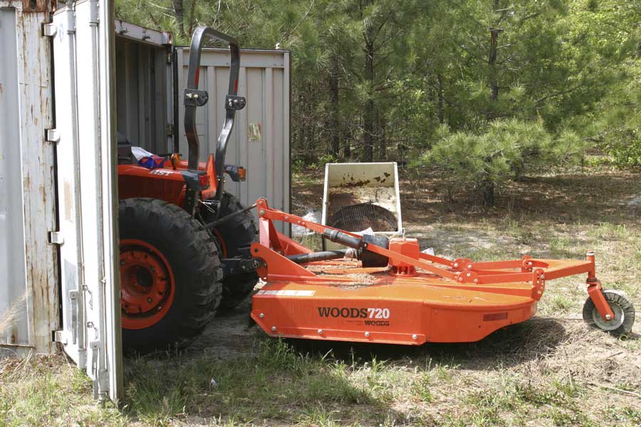

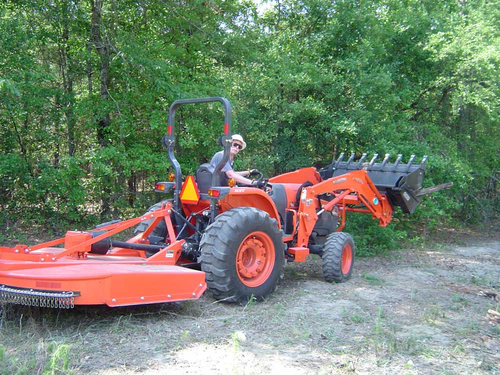

   / L5740 and rotary cutter #6
DRPAD:
See my post on Woods Brushbull 720. It is 6 feet and about 1300 lbs with the chains. I posted some pictures and info on the Brush Bull 720. I would not want to pull anything wider unless I was cutting smooth level fields. If I was doing wider fields I would get a lighter bush hog. The beauty is my 5240 has lots of power and I find that I run the PTO speed at 400 rpm ~ 1900 rpm engine speed

Nice looking rig, SCDolphin!
