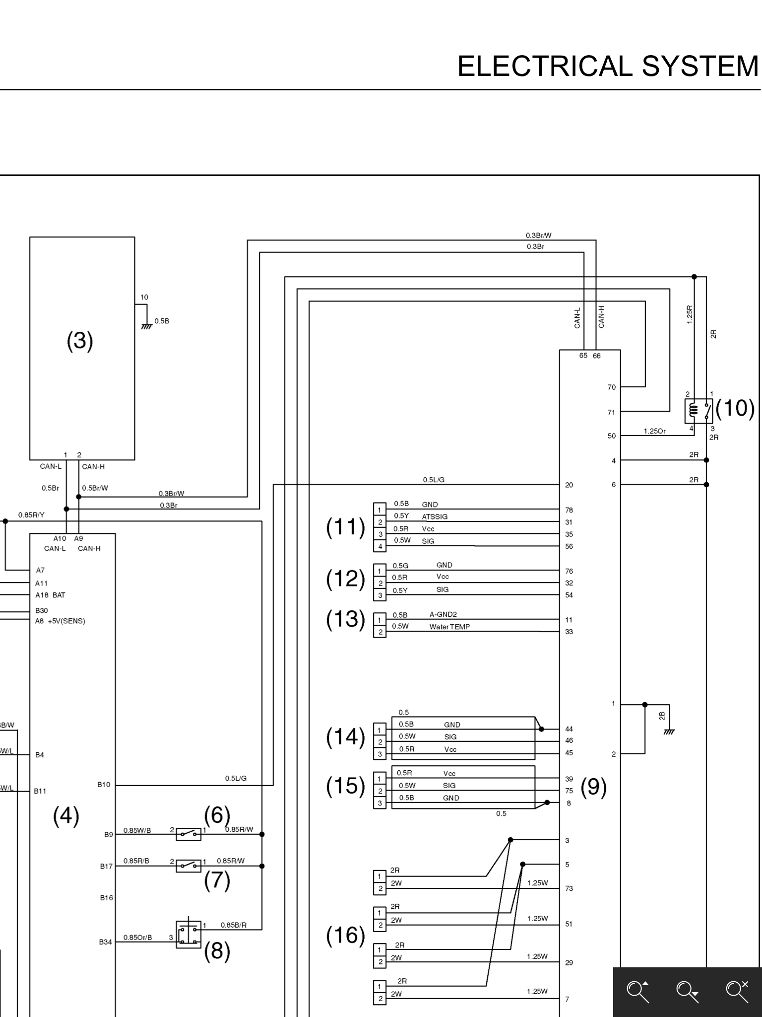

I have a Kubota L5460 and was working some brush when the engine died suddenly and I got an error code 20. The transmission controller fuse was blown so I replaced it and got the tractor to start, but now I have no throttle control and the engine goes to max RPM upon starting and stays there. I think the likely cause is that I took a limb hit on a wire plug somewhere underneath, but I can't seem to locate it (it's REALLY tight quarters under there!). Does anyone happen to know which connector may be involved and where it is located?
Update: Fired up the tractor and repositioned it for easier access and now on later starts I'm back to the error 20 again.
Many thanks in advance.
   / L5460 goes to max RPM & no throttle control after error 20 fuse replacement #2
The WSM says error code 20 is "Communication error between ECU and IntelliPanel".
The diagram shows 2 wires (Brown and Brown & white) between the ECU and panel.
I would start looking for a separated connector where brush may have caused damage.
In the clipped image, 9 is the ECU and 3 is the intellipanel.

Checked 4 electrical plugs that I could see on the right side of the transmission housing and all looked good. No obvious broken wires or plugs.
Anyone know where the ECU is located on an L5460?
   / L5460 goes to max RPM & no throttle control after error 20 fuse replacement #9
Main ECU is inside the squared off plastic coming out of the floor board under the steering wheel. I can't see my own attachment.
The Engine ECU (not mentioned for error 20) is under the seat. I got confused with the two when searching.
