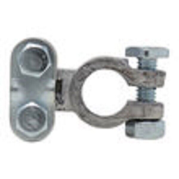

So, I broke down and called Marshal Machinery in Honesdale PA where I buy a lot of my parts. I explained situation in the detail I provided here and they were kind of stumped. They said they'd have a technician call me back. Nick called and I re-explained the situation. He seemed puzzled as I did everything they'd do. He said he would call me back in 20 or 30 minutes so he could research, look at diagrams and speak to other techs. I was starting to lose hope but he did call back and said consensus pointed to a bad power supply from the battery, either the ground or the power cable. Given my test light results, they suspected the ground. So I went up half-heartedly, took off the ground wire, cleaned it up on my wire wheel along with the rusted mounting bolt. I put it all back together, held my breath and hit the key - she started right up!!! So that enough for today - tomorrow I'll put back the dash, steering panel covers, etc. PHEW !!
I guess I over complicated a basic, easy fix. Oh well. Thanks for looking guys and have a good week.

I used it to clear debris around the pond that I dug out with the backhoe. Just brought it up to wash off the mud. Shut it off, had lunch, won't start again. This time it turned out to be the positive cable which used one of those crappy grote connectors (see pic) the bolts loosened and the cable was barely holding. Cleaned it up, put it back on and all is well.
