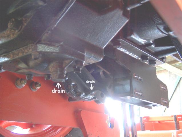

The 50 hour service is upon me and I looked under the tractor to find all the drain plugs. I could only find one plug to drain the transmission/hydraulic fluid which was in the center in front of the rear wheels. The Owners manual shows another one on the mid mount PTO which is not there, and two more further toward the rear, which I cannot find. I have the BH90 attached. Is the BH hiding the plugs or is there only ONE drain plug for the transmission/hydraulic fluid? /forums/images/graemlins/confused.gif

Finally found the right answer. There are three drains for the Hydraulic/transmission fluid. The big one in the middle right in front of the rear wheels and two drain plugs even with the wheels facing the inside. There is not one by the mid-mount PTO as the manual states. The attached photo shows the big one in the middle and one on the side. The third drain plug is directly across from the back drain plug and looks similar. /forums/images/graemlins/smile.gif
