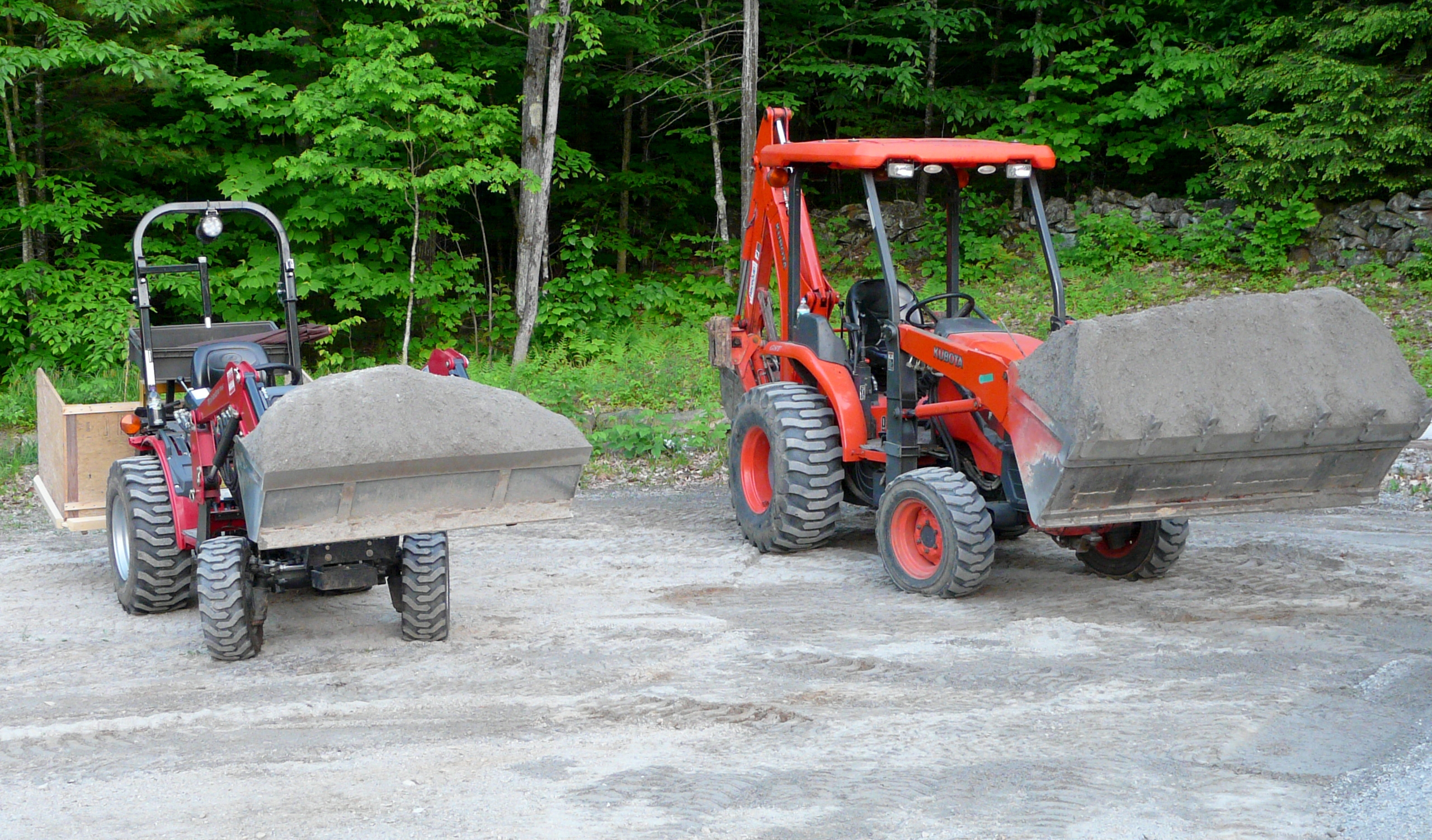

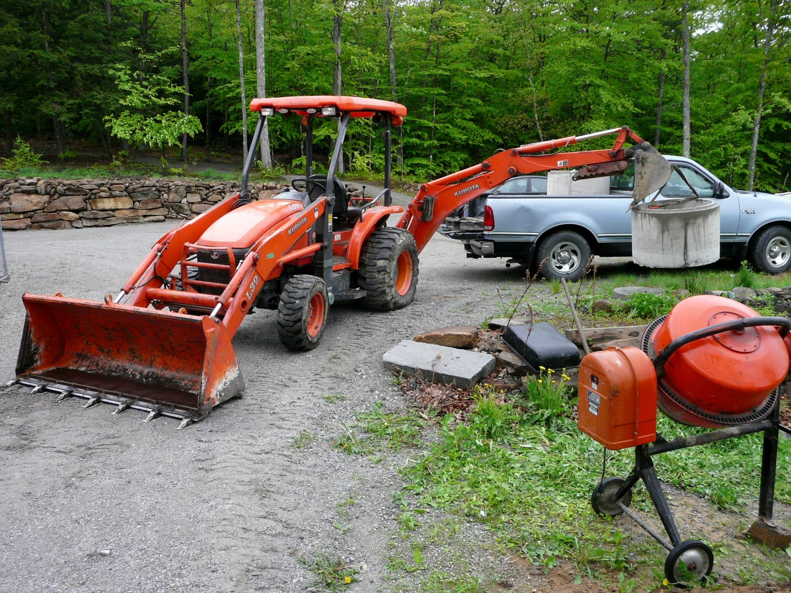

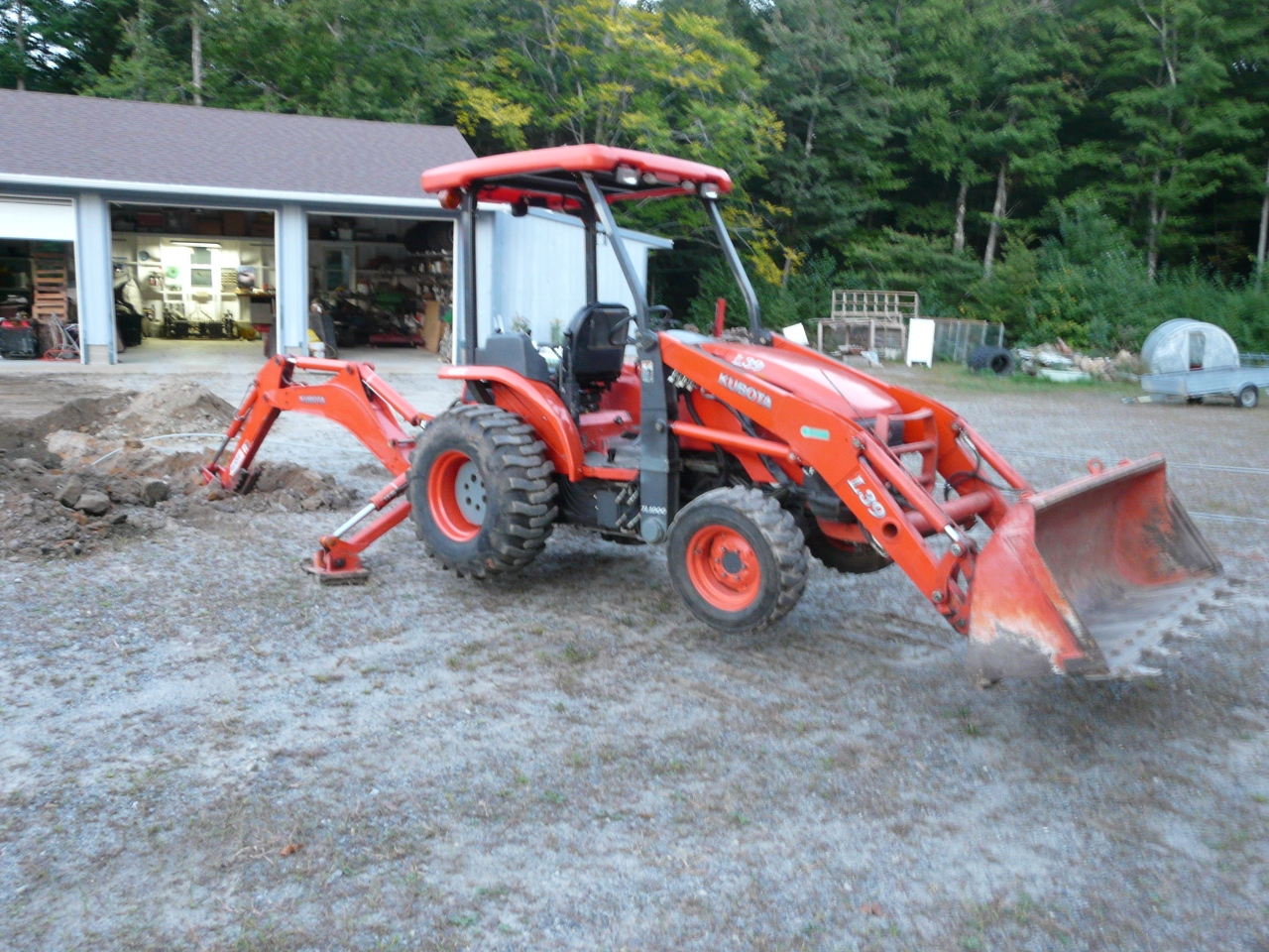

Disadvantages of a TLB
HP to weight and PT0 Power not usually as good as Ag based tractor.
Tiny tires for weight.
No Factory Cab
Loader frame not removable.
Needs huge counter weight without the BH if you plan on doing loader work.
L39 has same front axle as the Grand L's (Should have been from M series)
I'd still want a used Good L45 over a brand new L4701.
I would not trade my +2,000 hour 11 year old L39 for a new L4701 with BH plus a bunch of implements.
