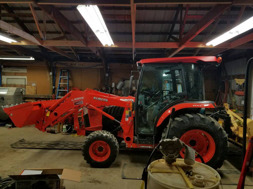

Hello all! Long time lurker and only second post. Any help is appreciated.
I just purchased a low hour L4760 without a FEL and for the life of me I can't find anything used. Going the dealer route and paying for a new one is a last resort. The LA1055 is the loader that is supposed to go with this tractor, from what I have read. Are there any alternatives? I looked at Bush Hog and could not find anything made for the L4760. Anyone else making non OEM FEL's for this one?

There are 3 sizes of OEM Kubota loaders for the Grand Ls. My L4060 can take the small & middle one. I think the L4760 is the one that will take the bigger loader. All the Grand Ls are the same frame except the L3560, so not letting us spec the big loader on the smaller or mid size Ls is a marketing thing I think. The numbers on Kubotas typically indicate the lift capacity in Kilograms.
I'm happy with mine. Just dug up a photo & I guess its a LA805. I haven't pushed it to the limits (1,800lbs or so) yet like I did on my old L3200. Hard to beat the OEM solution for proper fit. 20161207_104340.jpg

Do you think a LA805 would work on my tractor?
Kubota states the LA805 is only compatible with the L4060:
Kubota | LA85
Since the dimensional specs are identical for the 4060 and 4760, the LA805 might fit the L4760 but I would check with a dealer first.

Staying with the OEM specified loader is preferable. Finding another Kubota loader besides the one matched to your tractor can be tricky because Kubota seems to build certain assemblies that are almost, but not exactly, the same from one model to the next. Just enough different to preclude interchangeability. Try before you buy with anything used like subframes and mounting brackets. You might get lucky and it fits, but don't assume as much.
