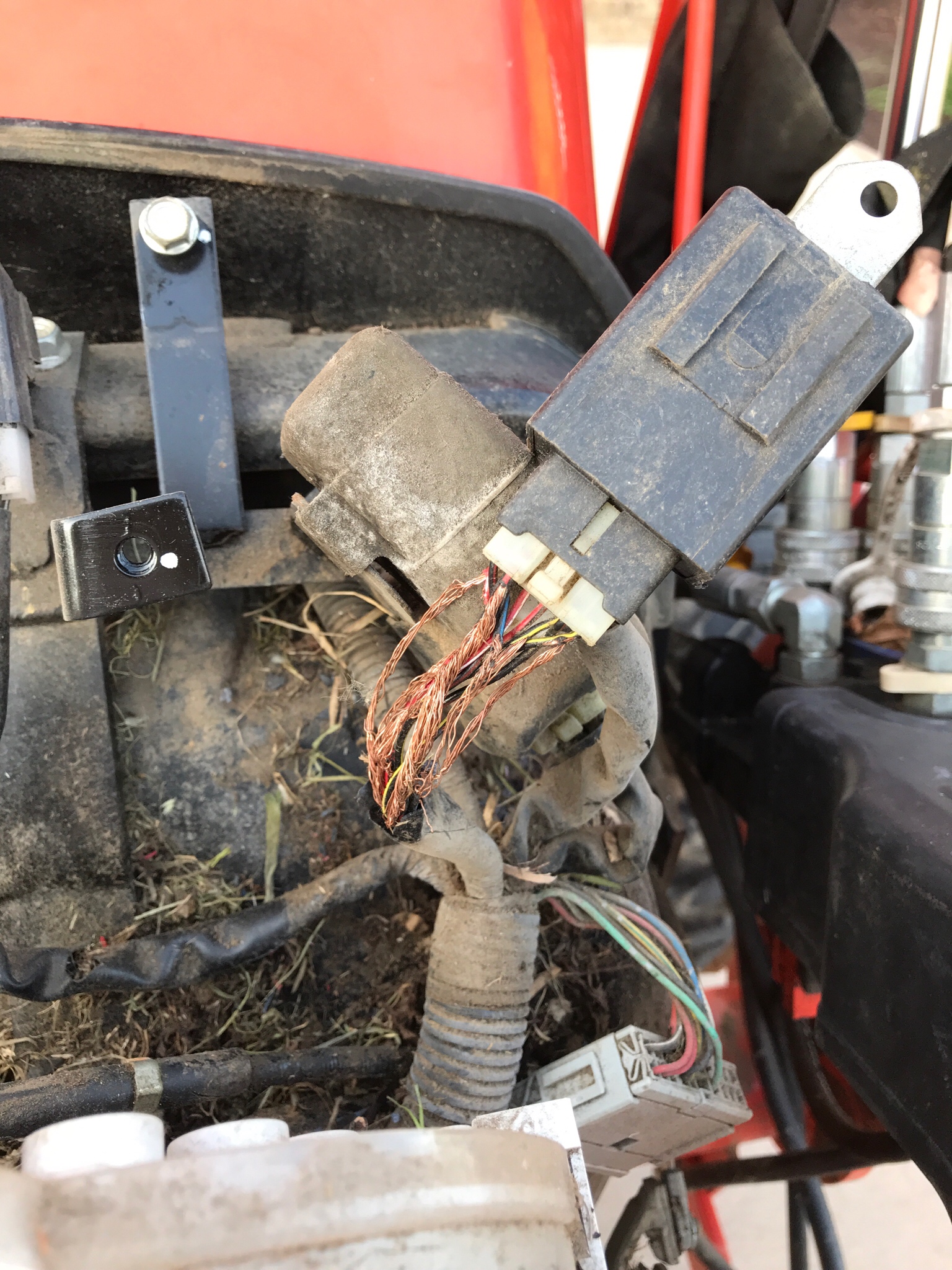

I think there were 12. I didn't take a picture but after closer inspection, I was able to use heat shrink tube to seal the bare copper on about half the wires and then solder new pigtails on the pins after releasing them. Then I spliced the pigtail onto the existing harness wires. Worked perfect and it's a robust repair. I hope they don't come back.
   / L4600 Suspected faulty ignition #12
I can稚 find new pin connectors for the plug but there is enough wire to solder a new one on or if the copper in good, I used shrink tube. I値l be able to make a stout repair once finished. They had anti rodent tape at the local auto electric store and it was $45 per roll!
