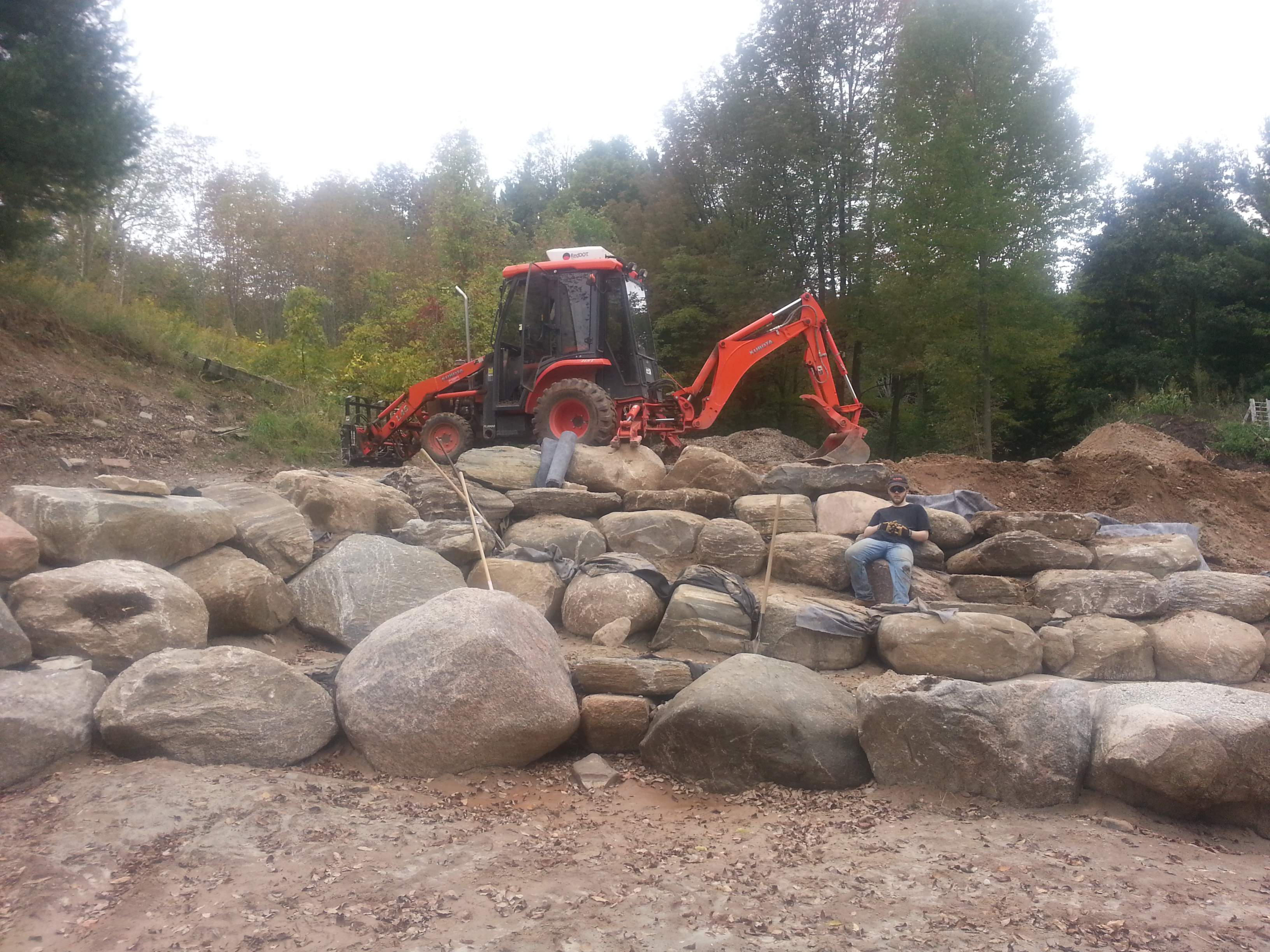

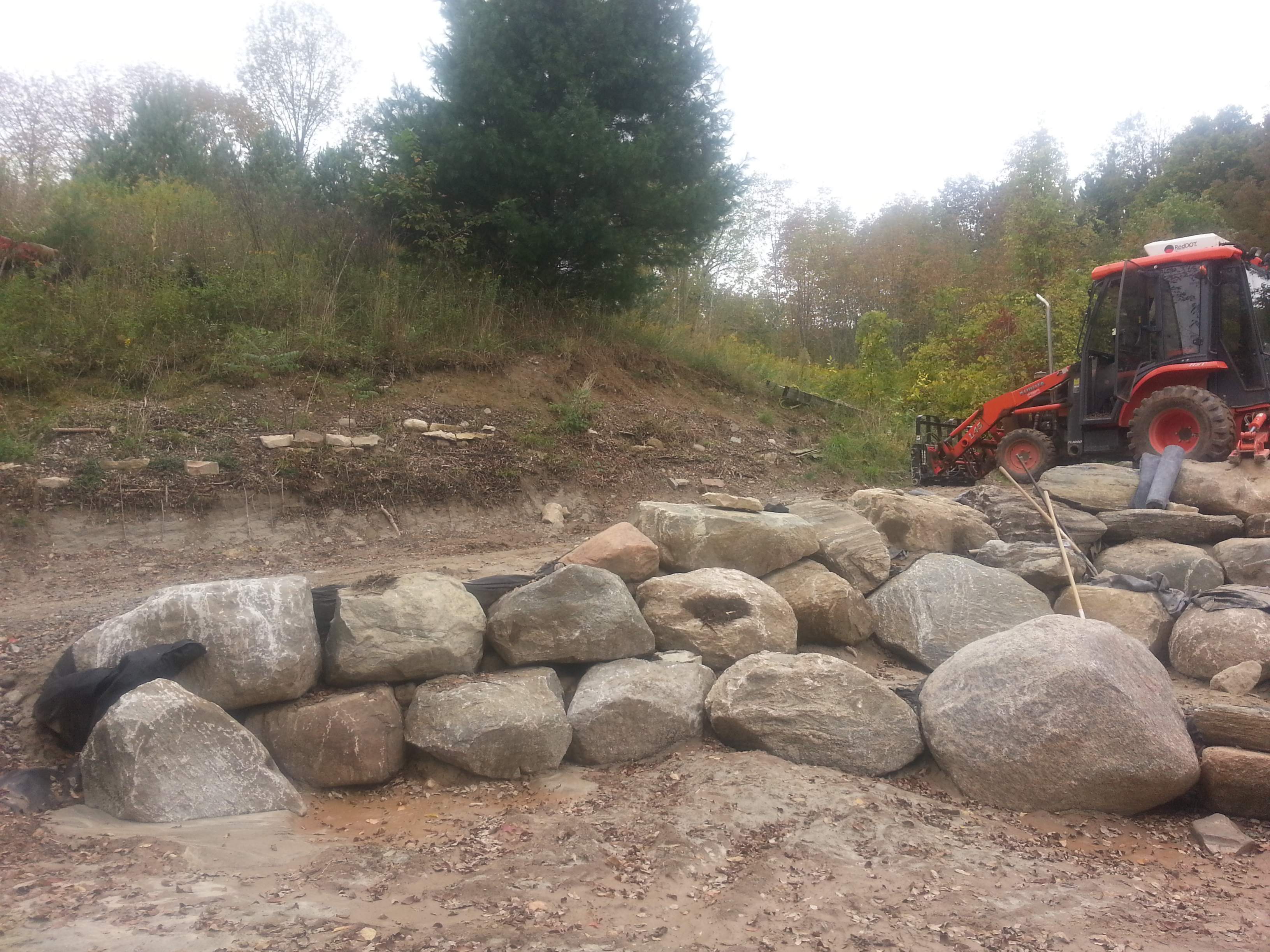

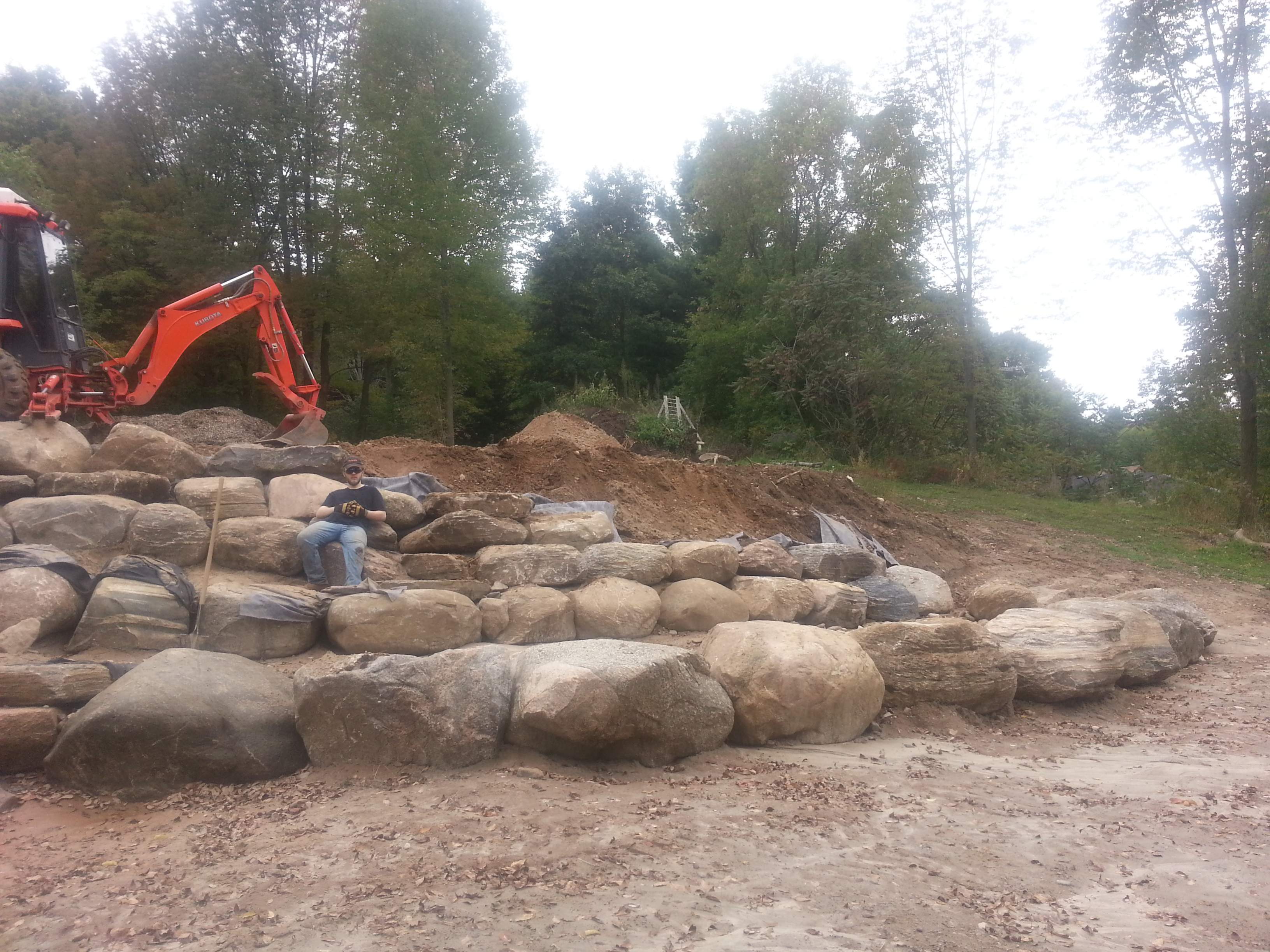

If by ehydro you mean the Auto-DS (Auto Downshift) I think of it as a two speed transfer case. The HST+ has three ranges just like the B26 and I do most of my work in M. I have a fairly steep hill at the rear of my property and the B26 would go up the hill in M empty but if the bucket was full I would have to stop, shift to L and then climb the hill and once I crested the hill stop and shift back to M. With Auto-DS the L45 will slow down and at a certain point without you doing anything or even stoping it will shift from rabbit (high) to turtle (low) and continue up the hill shifting back to high automatically once the hill is crested. This is a big time saver for me as I have moved hundreds of loads of material in my dump trailers from the top of my hill to the bottom. I have also moved several rocks up the hill too. Attached are a couple of photos of my hard working son assisting my with my current rock wall construction.
Midhurst rock wall 1 130922.jpgMidhurst rock wall 2 130922.jpgMidhurst rock wall 3 130922.jpg
The only trailer I have pulled with the L45 is my 7-ton dumper and it didn't have any problems with it. Some of the rocks in the photos are 7' long, 3' high and 4' deep and the L45 dragged them without any difficulty. As you point out all of your front attachments will work fine. I got the 4-in-1 bucket with the L45 and kept the oversize 66" B26 bucket rather than give it away with the B26. I am glad I did as I had a hose failure on the 4-in-1 on a Sunday and was able to just switch buckets and keep going. It's nice to have two buckets when you know you are going to be switching between sticky material like top soil or triple mix and then to mulch.
