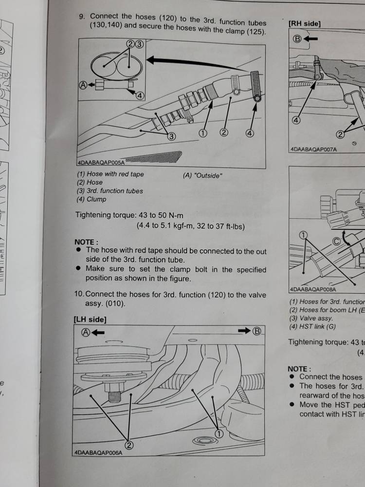

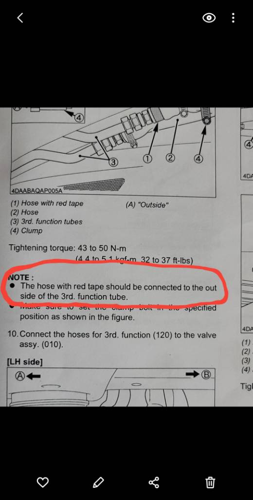

See the pic, the instructions state the hose with the red tape....neither hose has red tape and both hoses have the same ends and are the same length.
I'm assuming the "out side" is the return, how do I determine which is the return at the block?
And does it really matter when both hoses are the same diameter and fluid will flow in both directions?
The kit is Kubota's factory kit. Screenshot_20201229-184331_Gallery.jpg20201229_162223.jpg

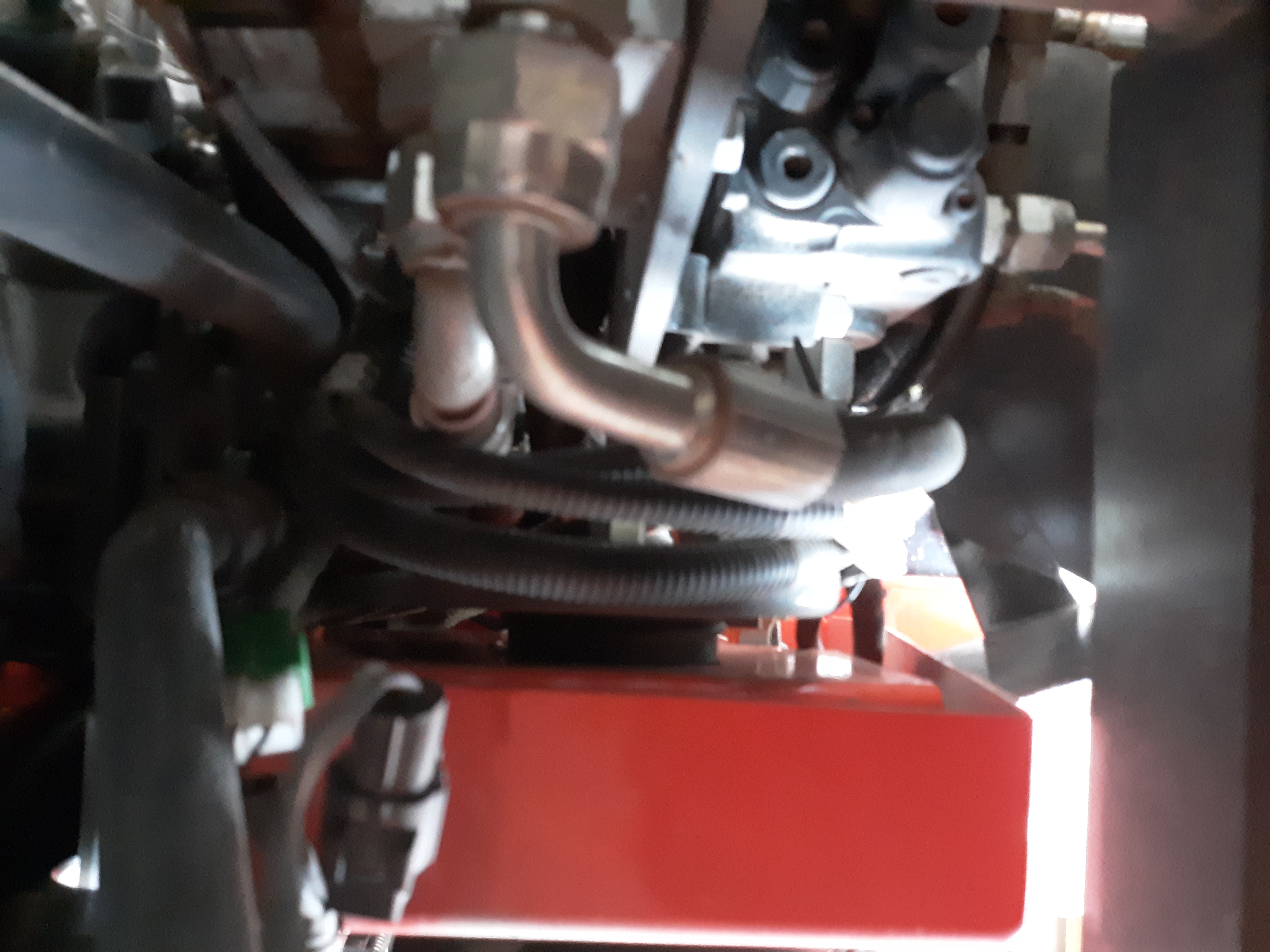

I can look at my tractor tomorrow and take some pictures if you want...........
   / L45 3rd Function Install Help #5

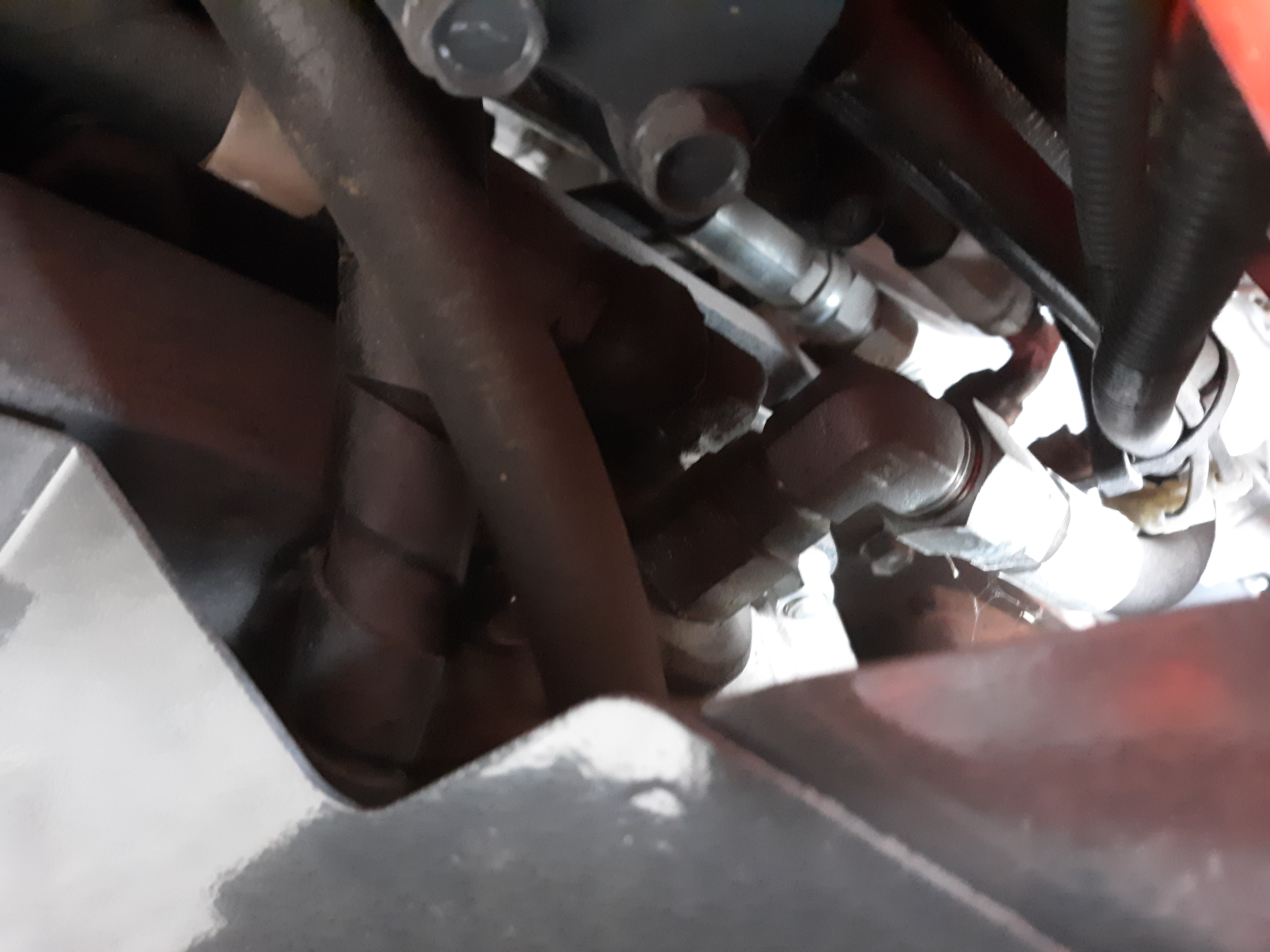

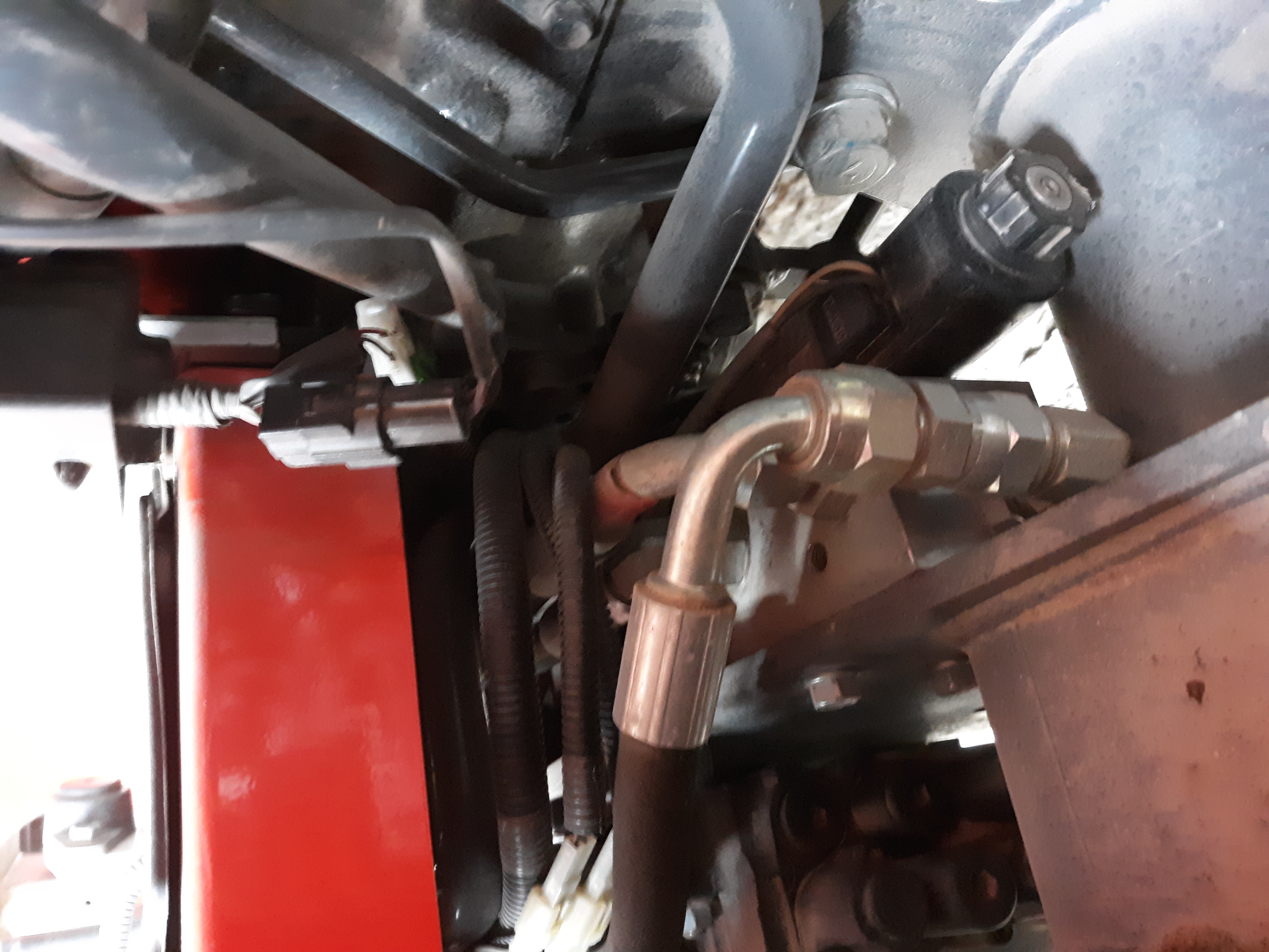

Here you go let me know if you need more the red hose has a long 90 on it that hose is to the front then the other hose has a short 90 both go over trans and up the left loader arm the front hose very short goes to the valve body on the top ...front 3rd 2.jpgfront 3rd f 1.jpgrear 3rd f.jpg
   / L45 3rd Function Install Help #6
And the red taped line connects to the outside steel line on the loader arm......
Thanks. I have the service manual and it is quite lacking. My hoses are exactly the same, length 90s, etc. Knowing the outside hard line is connected to the top front port of the valve let's everything else fall into place.
