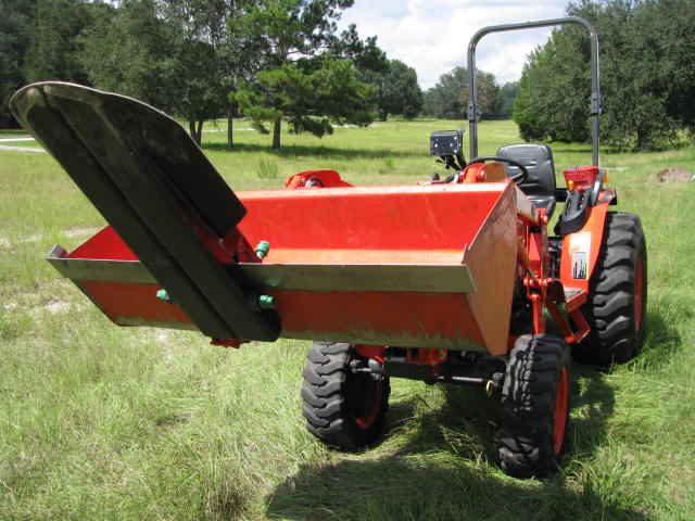

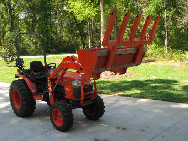

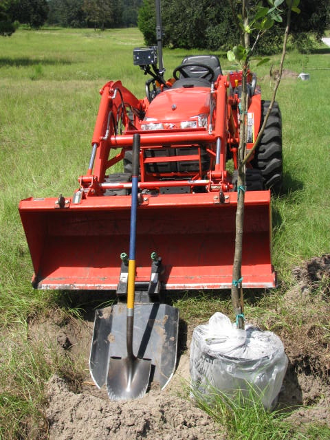

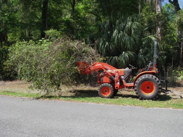

You are averaging thirty (30) engine hours per year. The tractors are reasonably close in weight, which is the key parameter relative to grapple work. I would keep the L4400 and consider clamp-on Debris Forks and Manure Forks to move brush piles and small trees.
LINKS: Tractor Debris Forks
Multi-Spear Ultra Fork
The ULTRAFORKS have less lift capacity but spears slip under brush piles without pushing the brush away. Great for moving leaf piles, bulk mulch and compost. With Debris Forks, to pick up big loads you usually need the pile in front of a tree or other backstop to lift cleanly.
I have used an indestructible Bucket Spade from this firm for seven years. It goes on the bucket and comes off the bucket easily. I expect Bucket Solution's forks are top quality as well. I have Debris Forks from Haynes, now closed.
Five more years of payments? Not I.

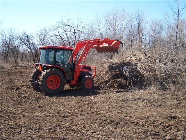

Keep what you already own, If it is capable of doing the things you need done... Put a skid steer adapter on the loader... It will open your future word to many more possibilities ...
And for the amount of grapple work you have available You will appreciate having an Actual grapple, and the ease of switching the loader attachment easily will only allow you to be more productive. KennyV

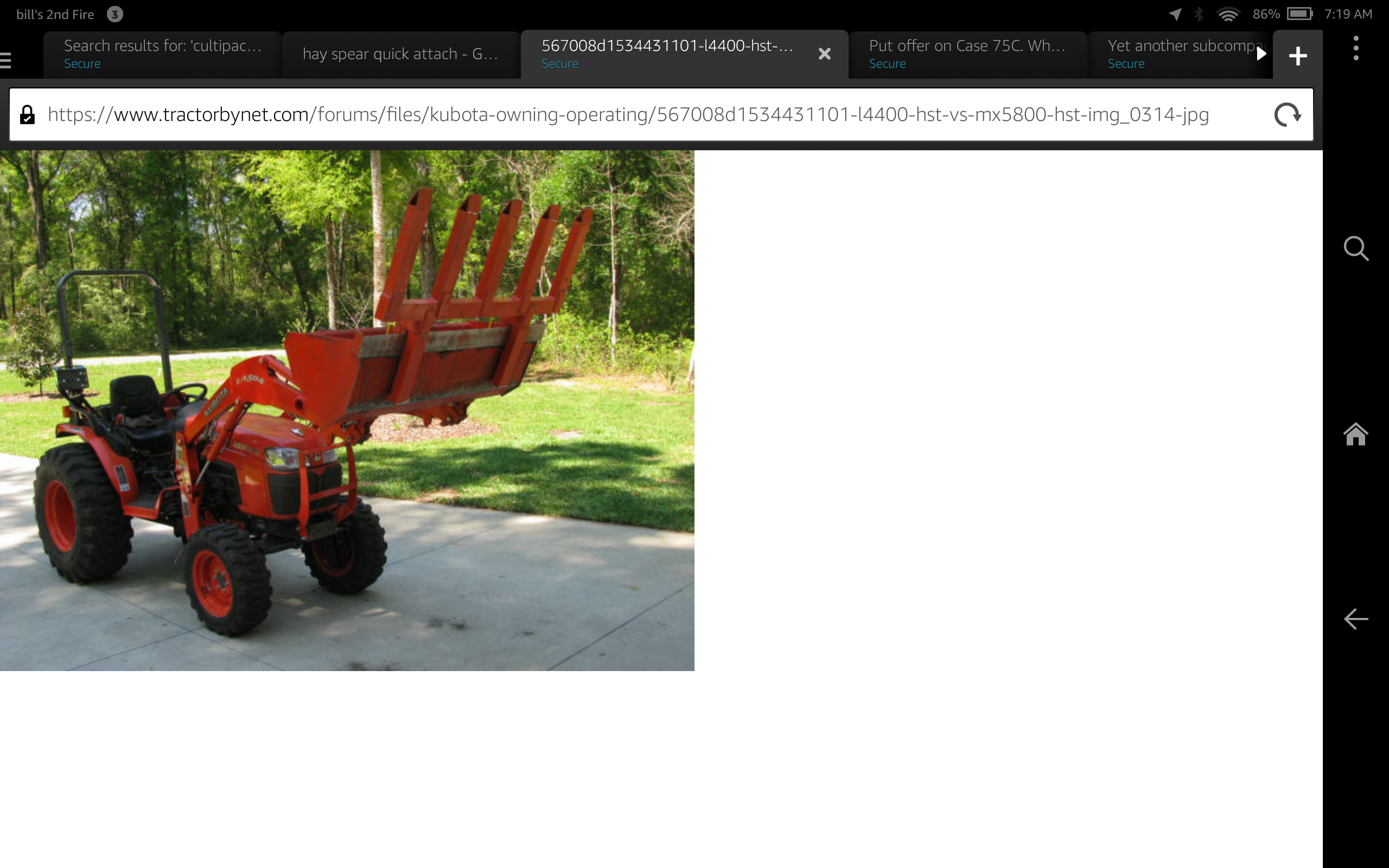

Agree w/ Kenny. However the clamp on forks for a bucket, have the potential to bend the bottom lip under even a moderate load. Regardless.the MX or your tractor would require the expense of adding a 3rd function at the loader front, for hydraulic grapple. W R Long and others offer a DIY kit. Everything Attachments has them on their website.
EDIT:
The other salient point that jeffy did not mention is really critical. The bucket depth must be added to the load. By this I mean that the load upon the clamp on device is even futher forward from the pivot pins. This further reduces you load cabacity. The dedicated grapple positions the load closer to the pins where it belongs.

This photo is ridiculous, load is too far forward from pivot pin, substantially reducing lift capacity and may easity upset tractor balance and stability. Must also factor the weight of the clamped on attachment!!..

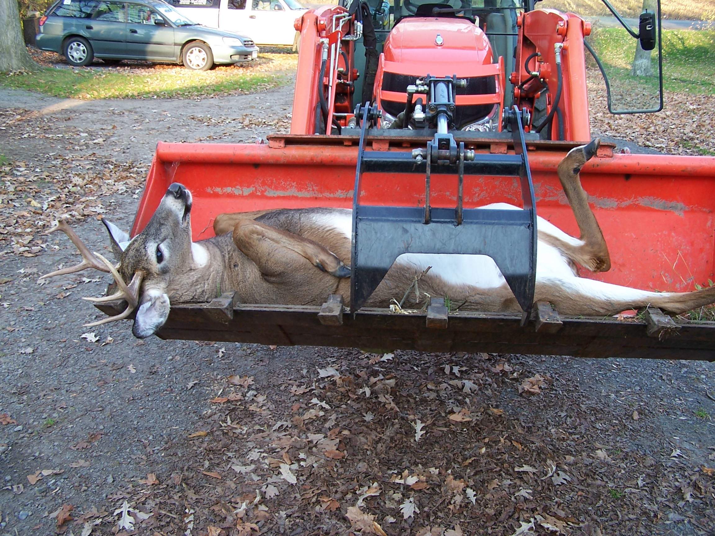

I would keep the L4400 and add a Green's Machine Thumb;easily removable (make it bolt on) and you don't have to change your bucket;that and a tooth-bar make a decent ("poor Man's) grapple.I use mine all the time and it works very well.
