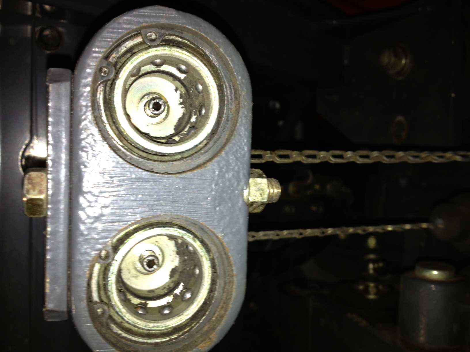

Hello folks. Hopefully just a quick question... can anyone provide the size/number info for the coupler I'd need to attach to the rear hydraulic remote on my L4330HSTC?
Here is a pic (sorry, it's inverted.) I'm having a bear of a time finding the right coupler and I'm trying to piece together all of the necessary parts to attach this to my new Erskine 780RP rear pull snowblower.
Thanks very much!

Pioneer 8010-4
My tractor came with 4, I have 2 remotes.

Thank you very much - that's just what I needed! :)

The male tips are referred to as ISO(industry standard outlet). You'll need to know what size and thread of hoses as there are NPT & metric sizes
