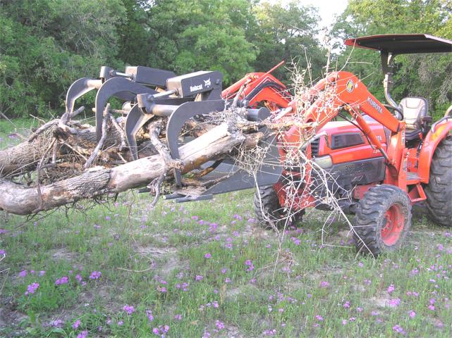

Muscat, 800 pounds with filled tires will probably be OK. The attachment above is a L5030 & LA853 loader with unfilled tires and a 900 pound boxblade on back. I have a Bobcat grapple bucket 845 pounds + 55 pounds of added teeth = 900 pounds. I did start to get tipsy so I will have to put my backhoe on for added weight when moving brush. If I tried to pick up too much it would not lift past the hood. But If you look at the bucket you will see that it is long and the weight is at the end, with your 4n1 you will not have that problem.
I think you will be OK, except maybe when you pick up a extra large scoop of wet sand that goes all the way out to the edge of the teeth. Good luck!

That is a nice looking grapple. I am trying to decide if the 4 in 1 will work for moving brush (I am thinking not) in any case why did you get a bucket type grapple vs a tine type ie brush/root grapple.
Any recommendation on good place to buy a brush/root grapple and what features I should look for? (also want a pallet fork)
