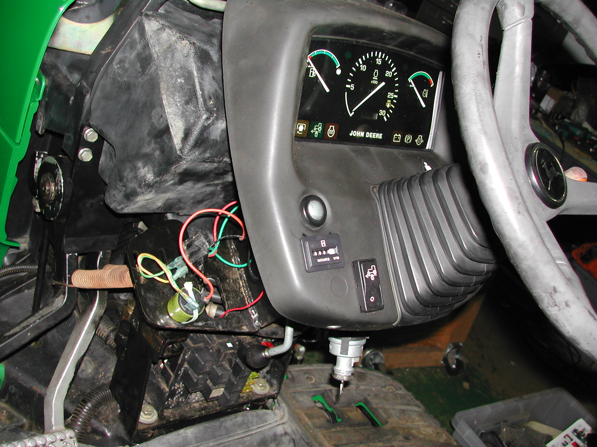

This a photo from a JD4300. Not a Kubota, but JD wants a huge sum for their combo
hazard/turn flasher, too. The flasher is yellow, held down with a tie strap.
Anyway, I subbed an auto flasher, which I had in stock, so saved the $8 they want at
the auto parts store. If you look closely, you can also see that the electonic hour meter
is replaced with a $25 unit, and the turn signal hole is capped off.
My Kioti's turn signal switch powers my work lights, front and rear. Never saw a use
for turn signals on a tractor. When you drive down the highway, you should use
hazard flashers, which disable the turn signals.
