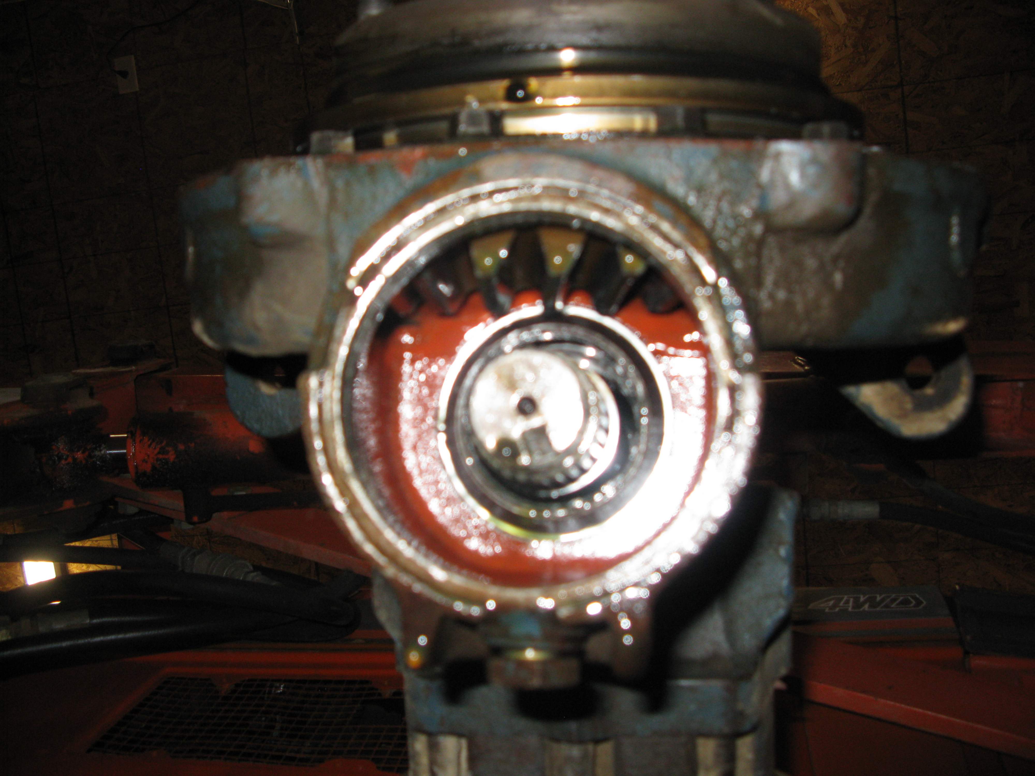

This is what I found after pulling the bottom CAP off the bevel houseing.
NOT A PRETTY SIGHT!

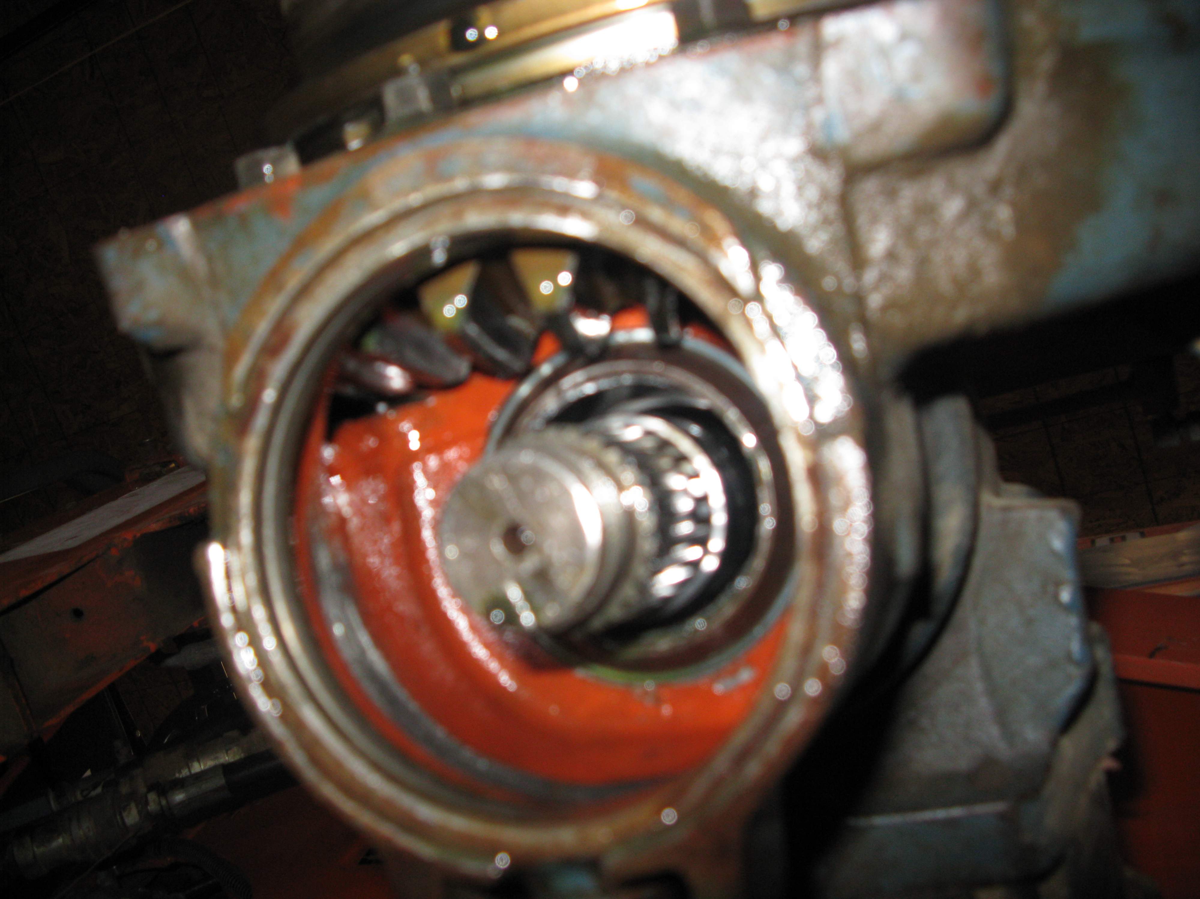

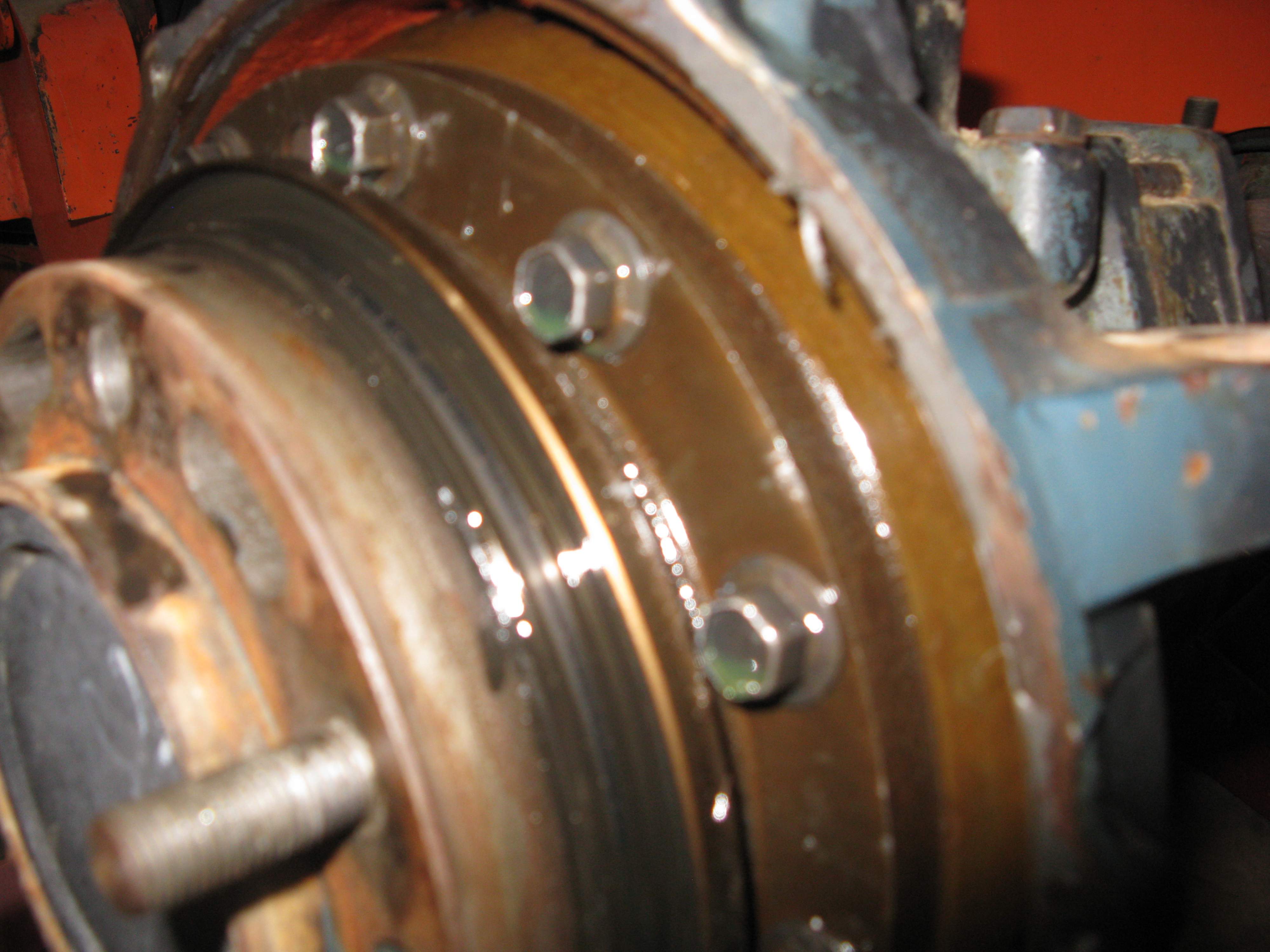

Pic shows beginning of removal, note the metal shavings inside the planetary system. HOPING the wheel bearings are not too ate up from metal shavings. NO play in hub though :eek:

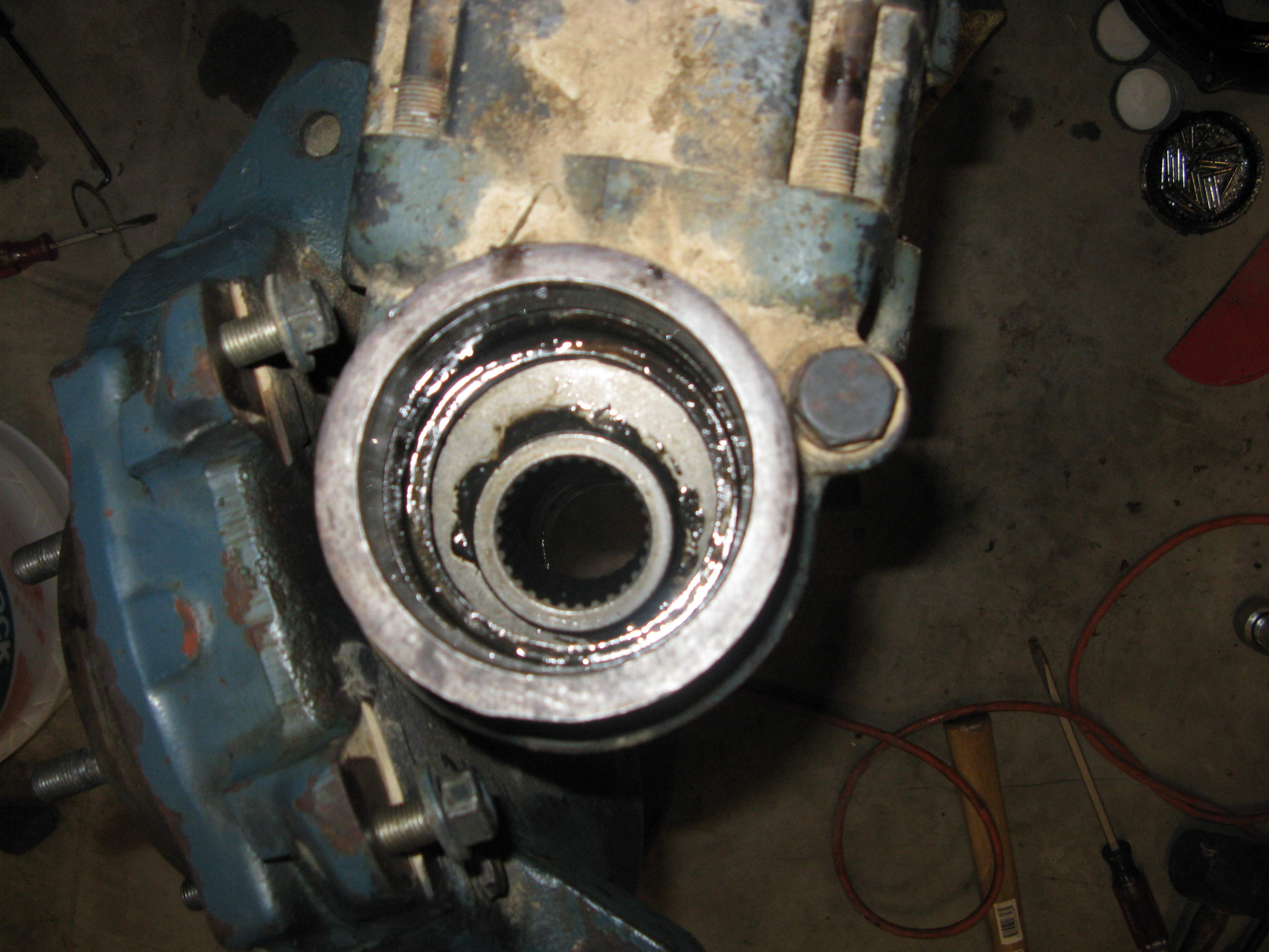

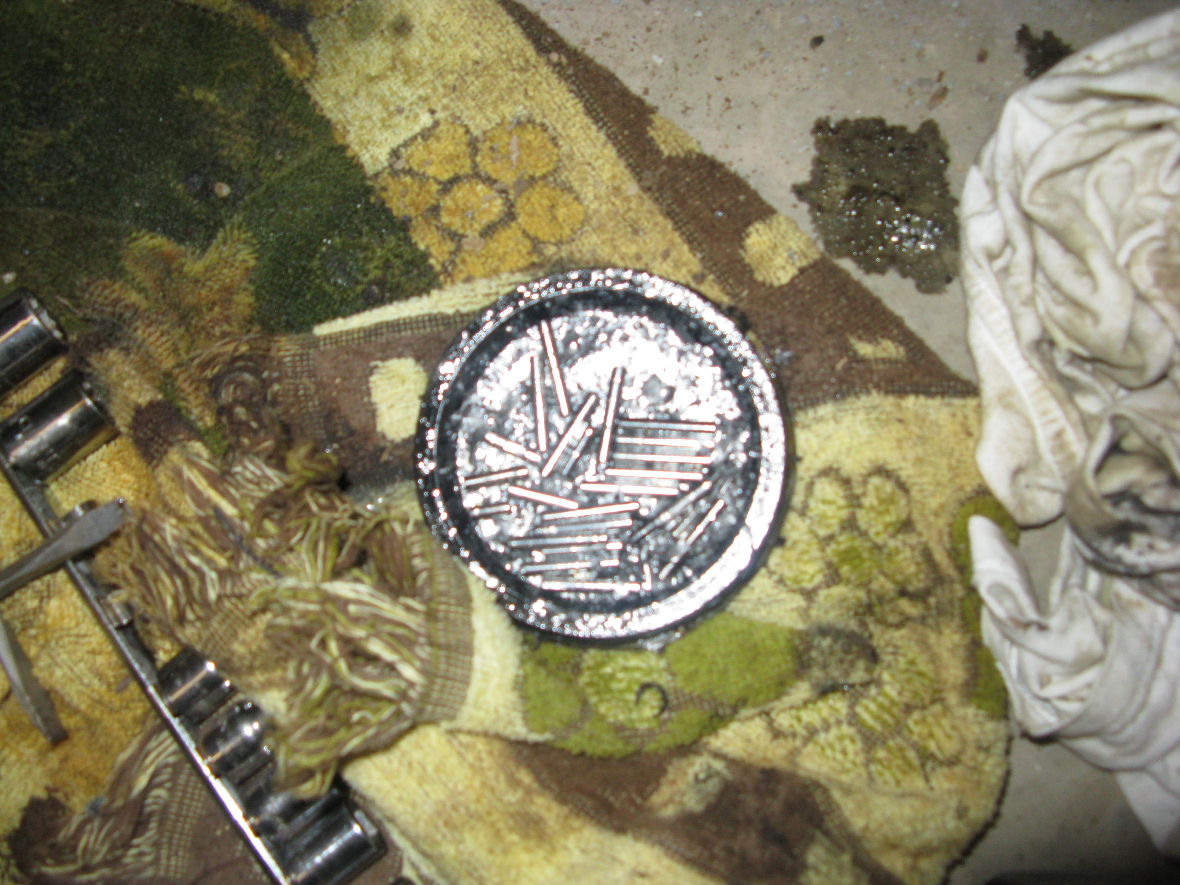

This photo is taken upside down from the floor up. Interesting photo, note the SHINY RING of wear where the bevel gear was (sloppy) and eating ever so slightly into the bevel housing. The second photo is the lack of needle bearings. Sux.

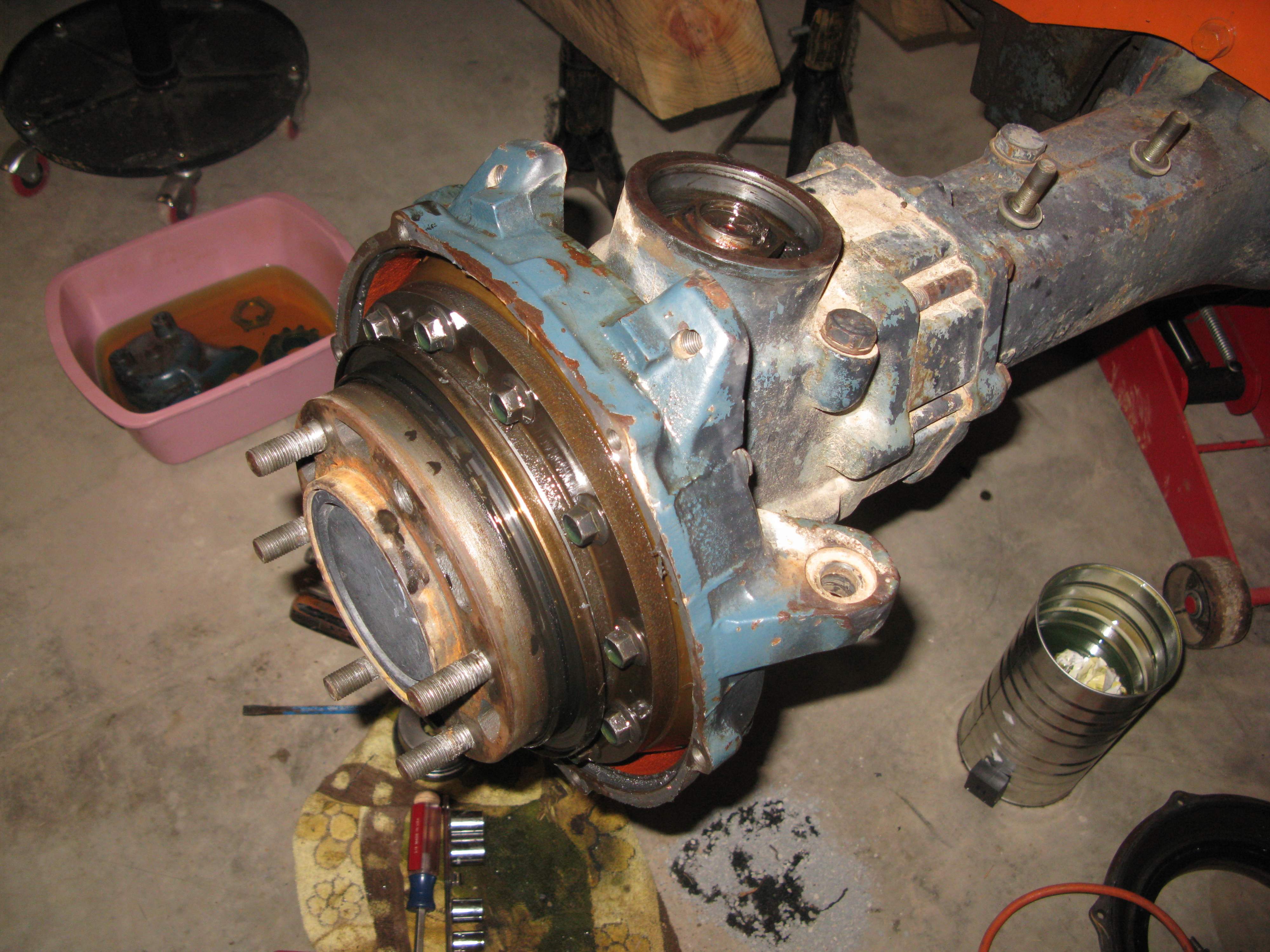

I am hung up! This is as far as I could take it. It took several Love Taps to get this far and it feels as if it should slide off the bevel case. Can anyone help me with ideas?
Thanks in advance

Yes I have parts diagram as well as workshop manual. Some suggestions from other members have been pretty simple, "get a bigger hammer" which is spot on with where I'm at. I had another comment about the possibility of there being some "mushrooming" from the needle bearing failure. As for the workshop manual, it explains it as coming off without a hitch? Regardless, it have to come off or I have one big concrete weight.....
