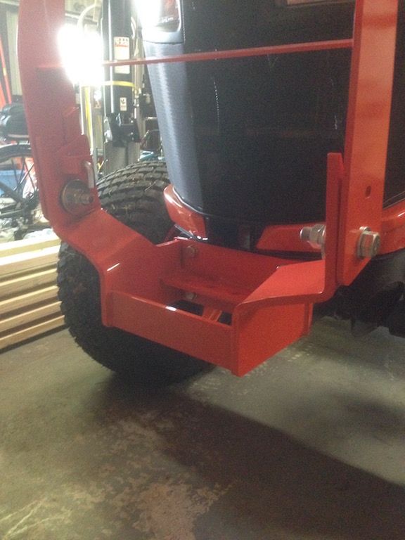

I have the L3940 Grand with LandPride RCR1272 rotary cutter. Here in central Indiana, I mow mostly flat land. No weights, no ballast, and I prefer not to have the FEL installed so I can see better and maneuver easier. Philip.
