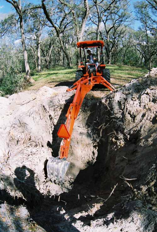

Nice work Mike. I'll have to take some pics of my rock garden that I've been building out of all the hundreds of huge boulders I've removed so that my Bush-Hog can mow merrily along without bashing rocks everywhere!!! :D :D :D
I have removed some stumps and rootballs that weigh way more than the entire L-39 does and the hoe just refuses to say NO!!! :d
