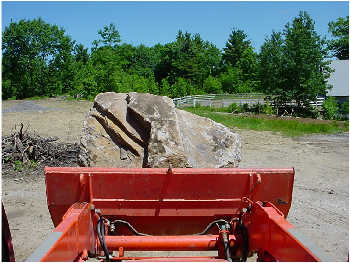

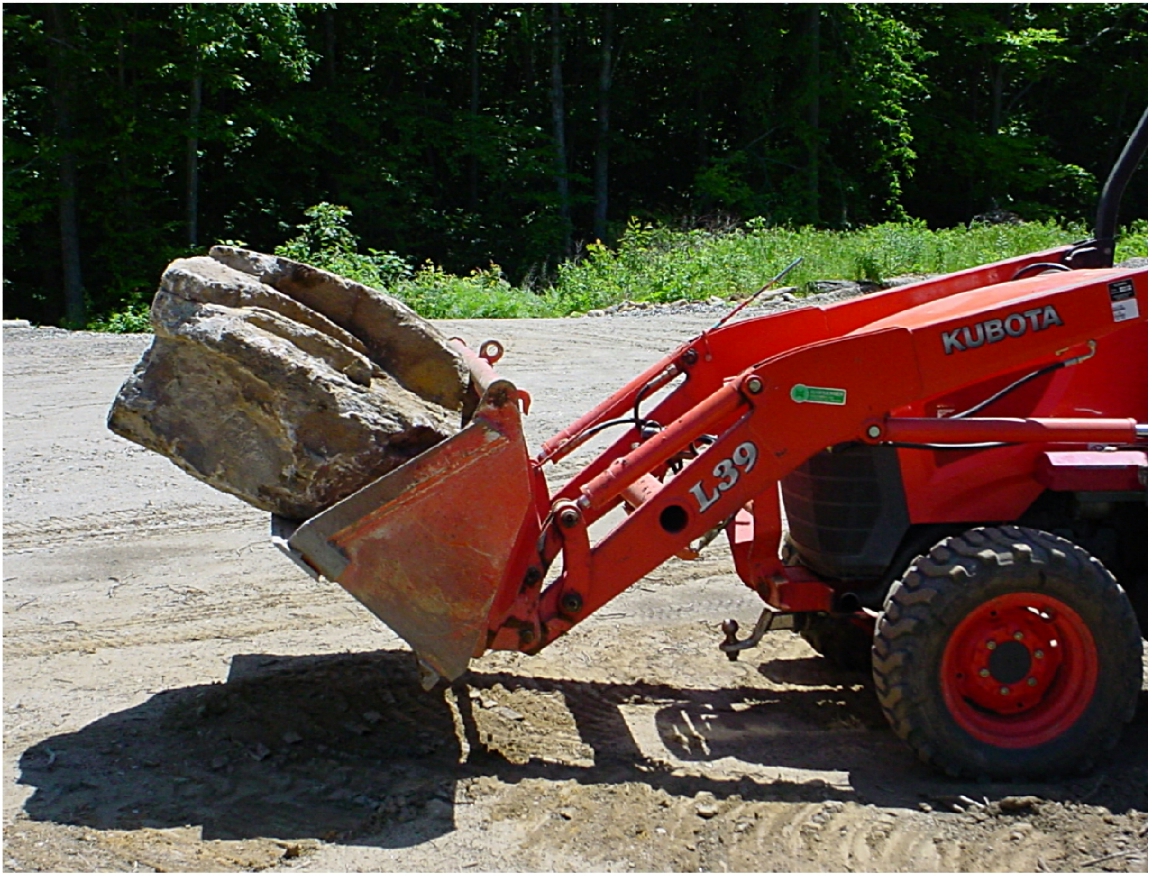

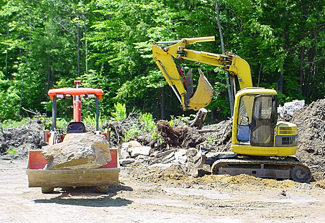

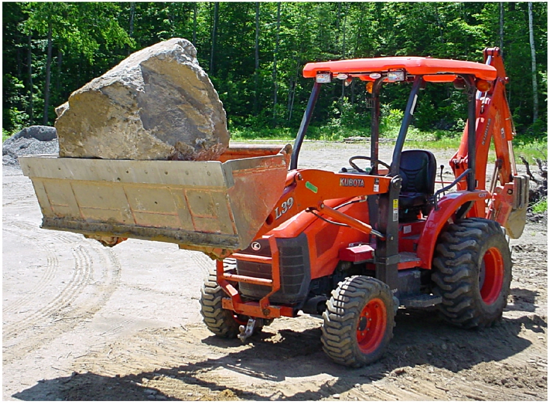

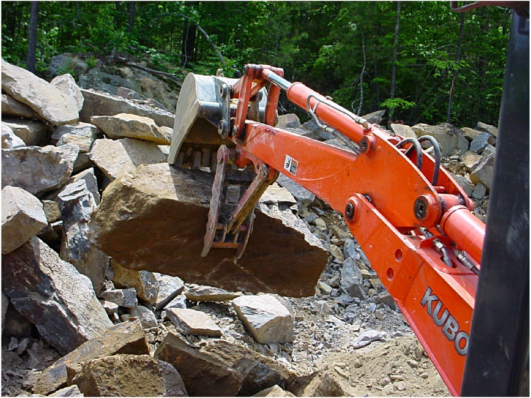

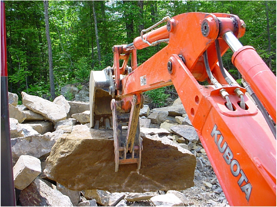

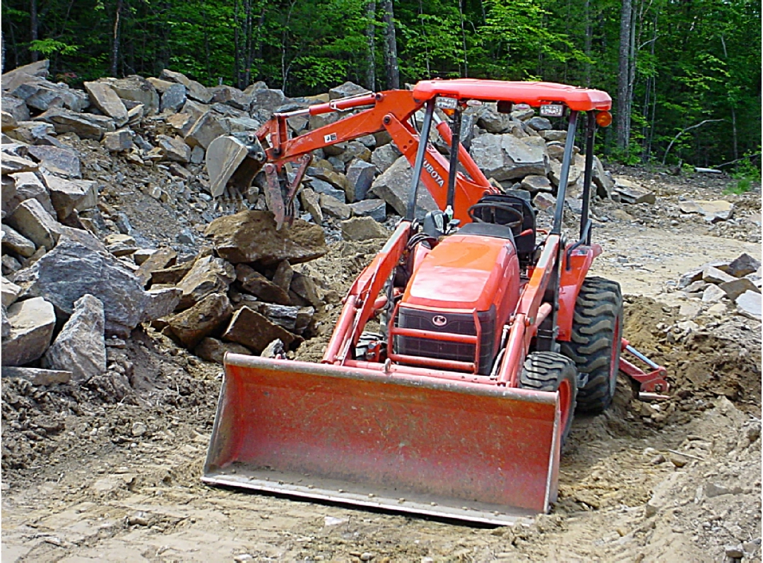

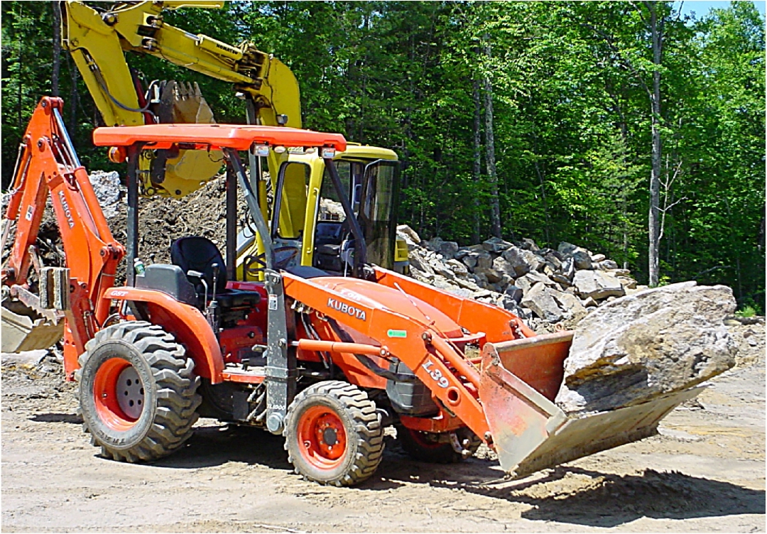

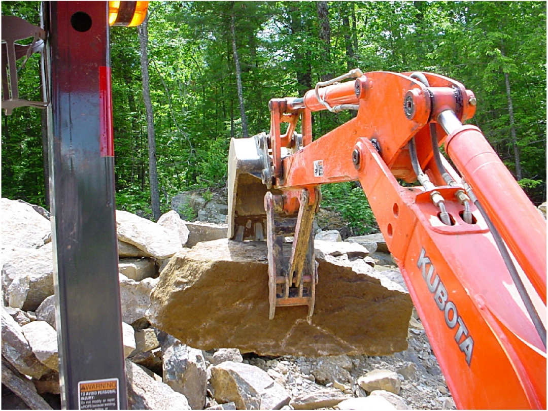

After only 4 hours of work the excavator sprung a hydraulic leak, so it was back to working the L39 hard.
The excavator feeding the L39 operated by my wife should get some material moved once it’s fixed.
PS That's a 2100 - 2500 lb Rock in the bucket. Granite weighs 160 LBS Cu-Ft.
I am running about 2900 PSI hydraulic pressure with a 1 pint accumulator off the main pump to reduce hydraulic shock loads when carrying such a load over a bump. Note a JD 110 runs 3000 PSI so I doubt you hurt anything but the warrantee.
It is best to use a calibrated gage if you crank up the pump pressure.
To get 2900 lbs (at least on my L39) this has been my experience.
Only go 1/3 turn on the relief valve spring. The diesel at idle should not slow to the point of almost stalling with any hydraulic function. If you lift the rears off the ground even on an unweighted machine, you have way too much pump pressure. One tire lifting off with offset load is ok on an unweighted machine.
My +1100 extra lbs weight also keep me safer and stable. I strongly recommend adding about 1000 lbs weight.

Great photos, Mike. Seems like the L39 takes it in stride.
What are you doing with the rocks? Looks like you have plenty.

The blast pile is sitting on the future foundation and driveway site. They will eventually be used for our oun retaining walls and the rest sold to landscapers.

That 10’ hoe is amazing. Not as fast or as versatile as an excavator, but for the size of the machine, wow!
I wish I had a 4 in bucket as well as the grapple.

Mike, looks like you bent your cutting edge a tad. ;)

Right now yes and a dump truck and a D8 dozer.
Later I think the L39 is the Swiss Army Knike I want. Just hope the blade stays sharp.
The bucket will get beat up more this year. I will get it reinfoced this winter or sooner. The top tube is getting beat up.
I dropper about a 100 pound rock on one of the curl cylinders today. It slid off the back of the bucket. No dent, paint fixed it, but I have to be real careful with the excavator. A big rock will cream the hood or hydraulics.
