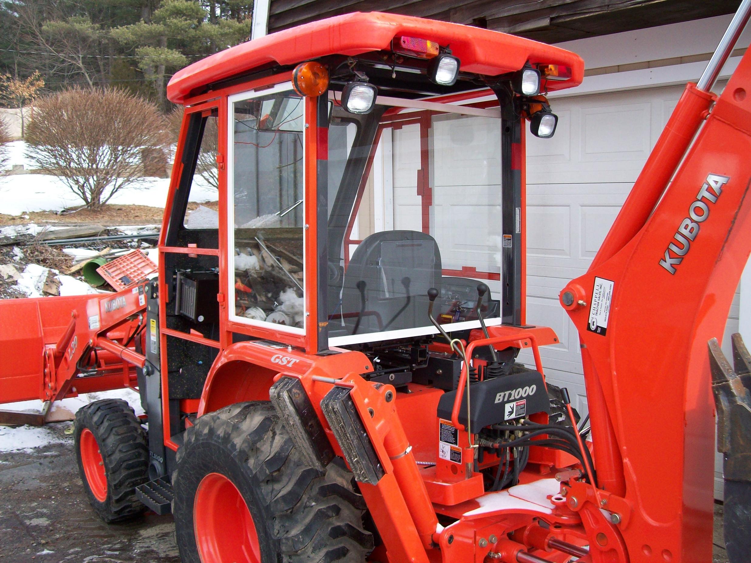

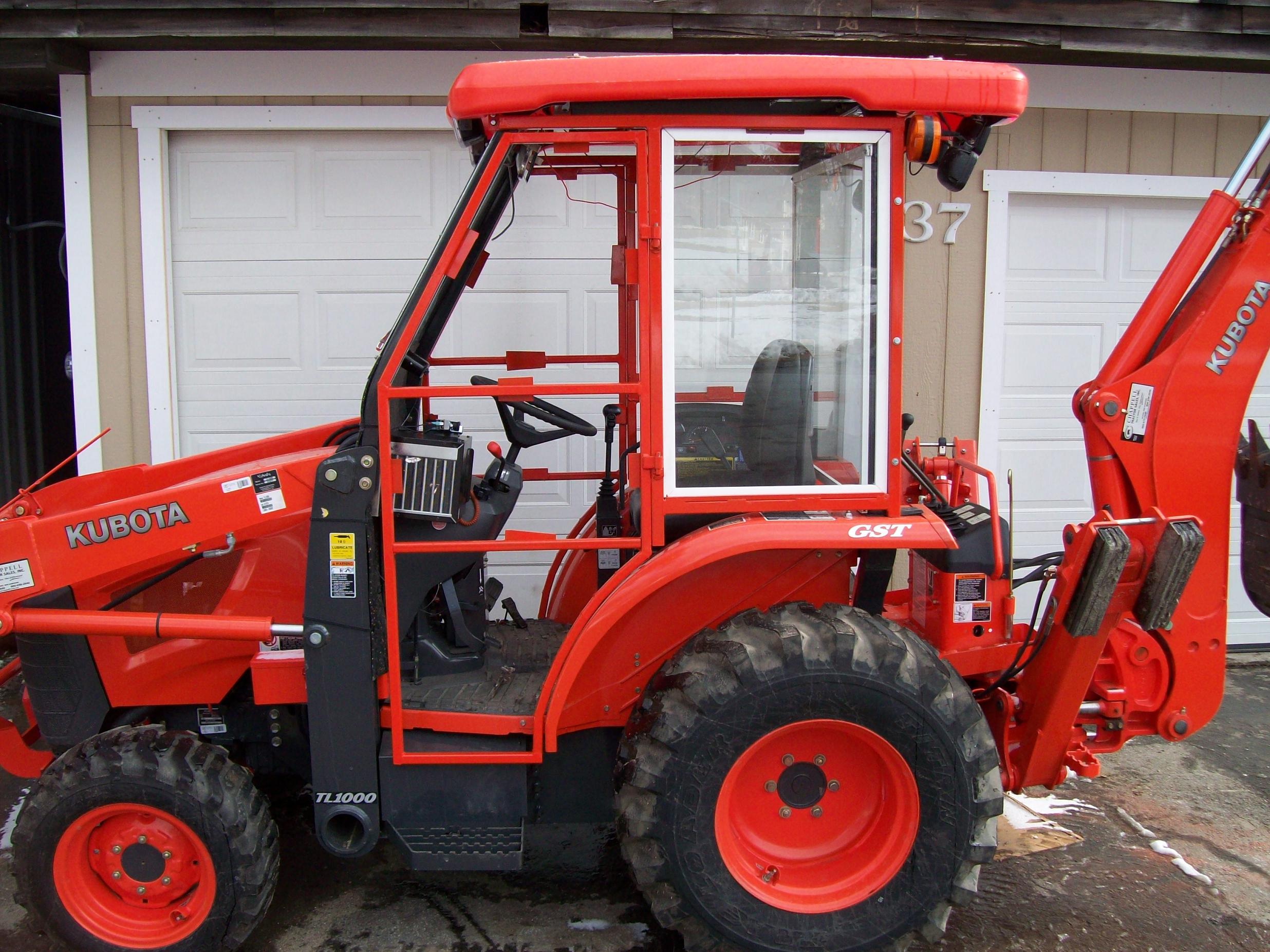

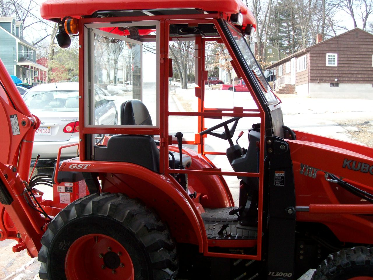

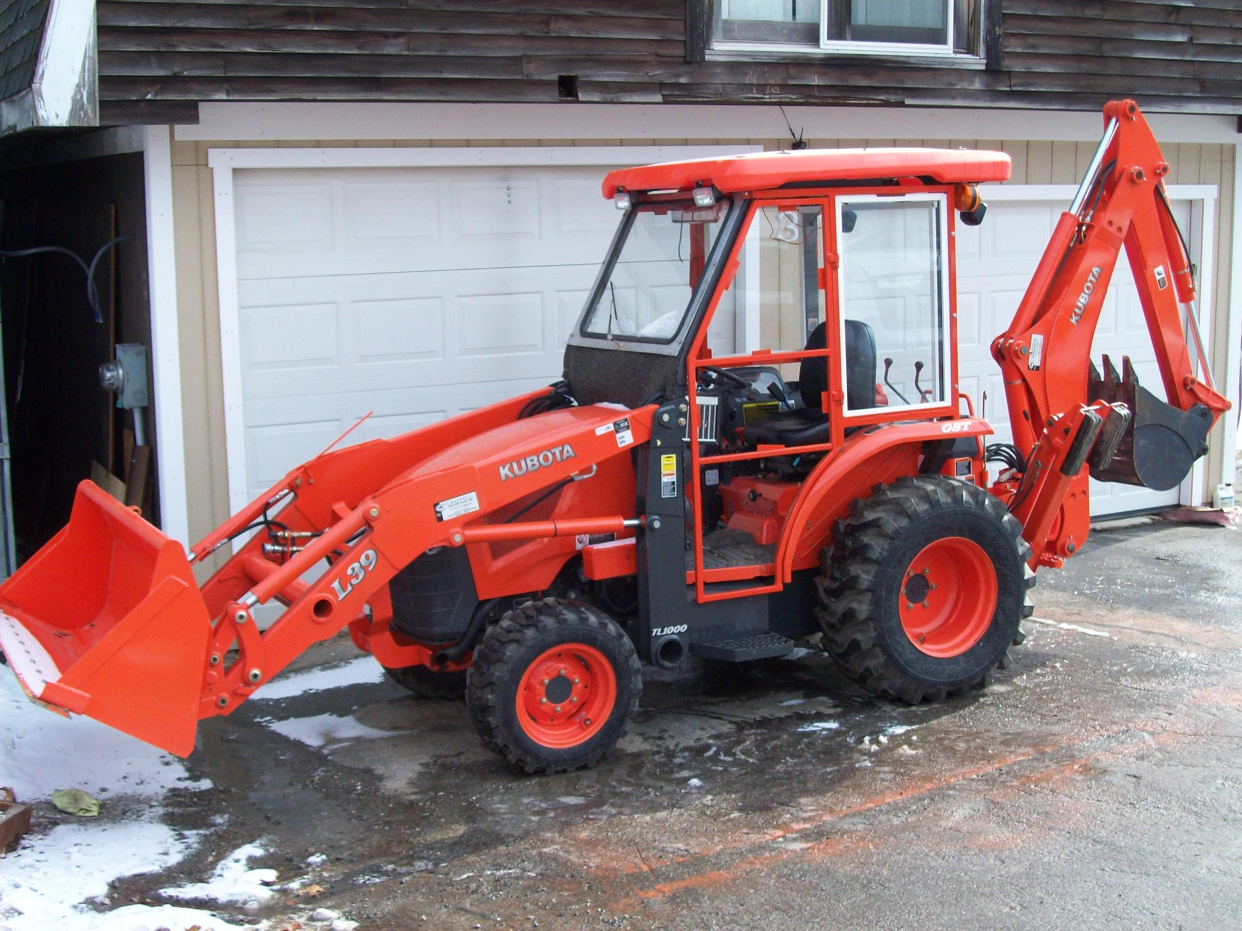

Ok so I started my cab on Sat and now it is Wed. I am waiting on door glass but this is where i am so far, Total cost 850.00 with heater,steel,wiper,and radio. I am still looking for a better windshield wiper assembly

The front window i took a peace of aluminum and cut the center out and had a piece of glass cut for the opening,all the rest i had glass cut and made a frame out of "lattice c channel" the stuff the use to hold lattice under a porch. The door glass should be here tommorrow. all the windows are 1/4" safety glass.
