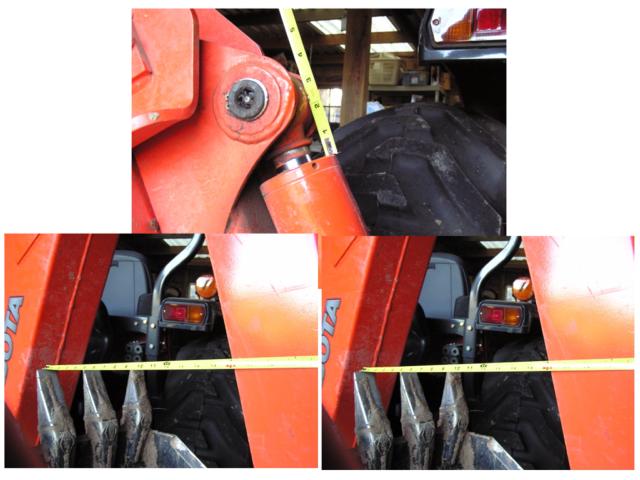

I have a new L3830 with a BH90 backhoe. With the backhoe curled up it drops about one foot over four hours. Does anybody know if this is reasonable or if it should drop at all? It also starts to drop while running the tractor.

I could be wrong, but I doubt that drifting/leaking down of the stabilizers, stick, boom or bucket over time is going to be fixed, unless it is a gross condition.
Same issue with the tractor's loader or 3PH...those may (or may not) drift down over time. My 4690 hoe does the same thing your BH90s are doing.
The symptom could be caused by leakage within the cylinders, but it is more likely caused by a little clearance withing the control valve sections. Which apparently is normal.
There have been a lot of posts here at TBN about this issue, related to front end loaders. If I remember right, someone even dug up a spec, that quantified the amount of fall of the FEL in inches per hour that was considered acceptable or normal.
One way to correct this "problem" is to install pilot operated check valves on the cylinders or somewhere betweent he cylinder and control valve. Doing this eliminates the control valve leakage issue. Nothing beside a rebuild of a cylinder would correct an internal leadage issue with the cylinders. It is doubtful that the issue on a relatively new backhoe would be worn cylinders though.
I think most important is to look at what is happening and determine if it is really a problem, or if it is actually a "normal" condition. I myself find my expectations sometimes don't match what I am seeing, and rather than get worked up about it I try to lower my expectations to match what things really are like. I don't know if this makes any sense.
Final thought. Does you backhoe have a boom lock? I think of the boom lock as a physical indication that the backhoe manufacturer expects some leakdown of the boom cylinder over time...otherwise it would not be needed...(simplistic maybe, one could argue it is a safety backup device...)
Bottom line, it is an inches/hour VS feet/minute question...somewhere in between these speeds the transition from normal to problem occurs.
Can anyone quantify this with a number?

Henro and Tanman, I check the relaxing of the stabilizers and bucket after 13 hours. Temperature was in the 50s.
In 13 hours the stabilizer dropped 1/2 inch as measured from the hydraulic cylinder. During the summer it has dropped about halfway down during a week of non-use. the right one drops more than the left.
The bucket seem to drop to a point and then stop. On the 13 hour test the bucket dropped 5 1/2" as measured from the dipper stick to the end of the teeth. See Attachment.
Are the rest of the BH owners experiencing the same drop?
Tanman If they get yours not to drop at all let us know.

I don't think I have ever seen ANY hydraulically operated equipment that didn't leak down over a period of time. There is NO WAY that valving will hold static pressure for an indefinite amount of time. Neither will the cylinder packings.
That's why you are supposed to store your FEL with the bucket on the ground, your backhoe with the stabilizer legs down and the bucket/stick on the ground. Actually, it's better for the hydraulic system to store, at rest, the system with the internal pressure at or near 0 psi.
When you remove your FEL from your tractor, you will notice that the stored position is actually a point where the cylinders have NO pressure on them, sort of an equilibrium point. If there was any pressure in the lines, you would not be able to couple the QD fittings again.
A good example of leak down is the new $58K roll off trailer I just got, the hydraulic system relaxes the winch cable over night to a point where the cable is actually drooping and has to be tensioned in the morning. Over the weekend, I always relieve the pressure on the system before I let it sit. That is recommended in the owner's manual.
