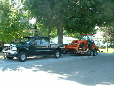

I usually trailer it 400 miles round trip about once per month. I've hauled lots of tractors and safety is #1. Make sure your tow vehicle is sized for the task. I've seen quite a few people use a 1/2 ton pick-up to tow over 10K and it is hard on the truck and it is very dangerous. I tow with an F350 Powerstoke rated at 12,900 lbs tow capacity.

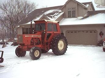

I appologize for the story but here it goes: 2 years ago I had a big Allis Chalmers 210 that weighed over 14,500 lbs. I sold it to a farmer from New Mexico. He came all the way to Michigan to pick it up with a fairly new 1/2 ton Chevy pickup pulling a tri-axle gooseneck that weighed nearly 6,000 lbs. I thought that I was on "Candid Camera". The total load was over 20,000 lbs!!! He loaded it on the trailer, and chained it with 2 old rusty log chains. The truck engine strained to pull out of the drive and he was off.
He called later in the week to tell me he made it. No brake downs but he couldn't get it up over 45 mph.
I couldn't believe the state police didn't catch him. I'm also grateful that he didn't have to stop quick or swerve suddenly. Althought the truck was tuff as nails I'd hate to be the next owner.
Attached is a picture of the tractor.
Sorry for the long winded post.
