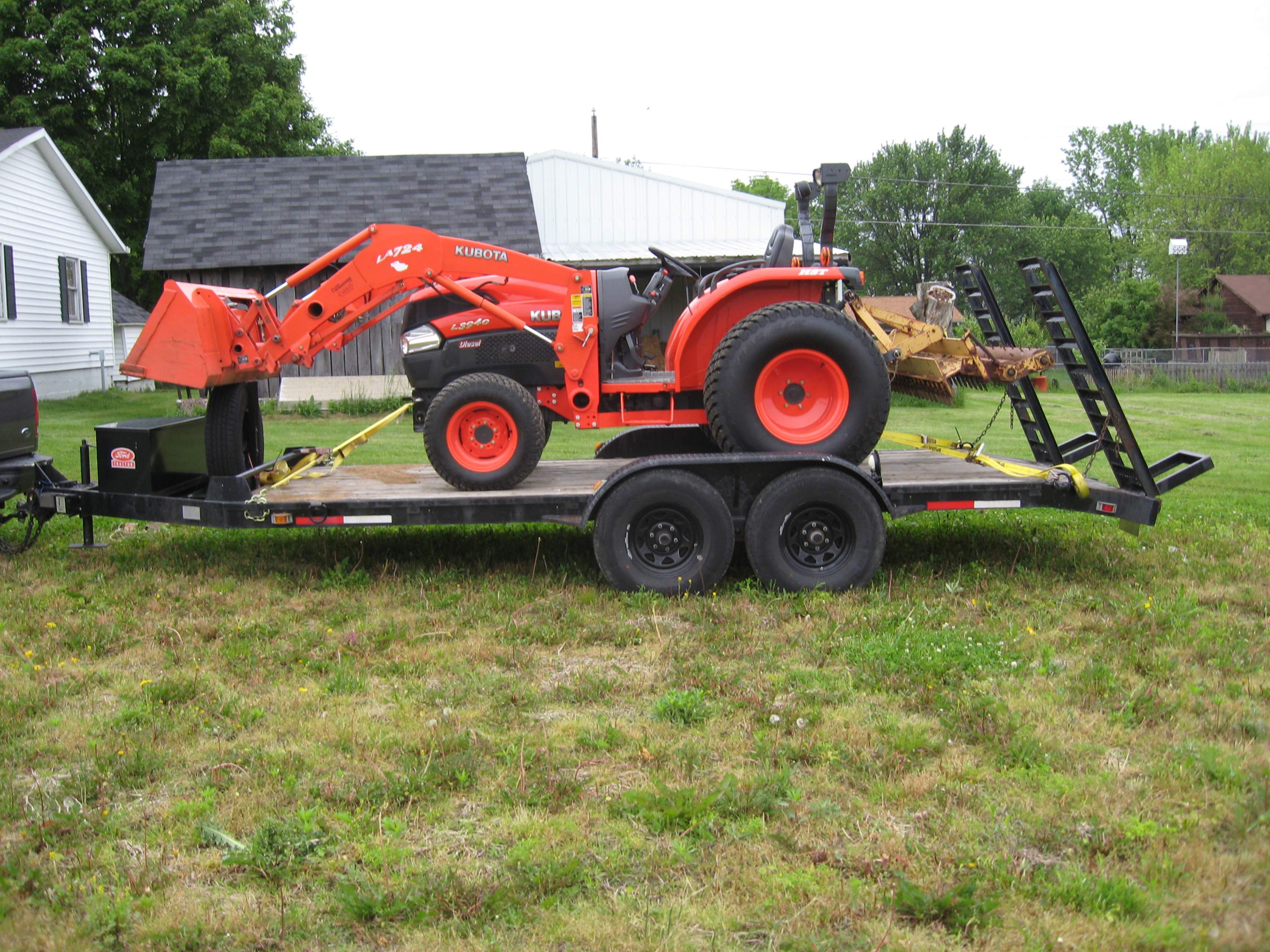

I have never seen it in the specs, there would be allot of variables. Loader size, position (height) of loader, size and type of bucket, type of tire, rear implement or counter weight, etc. I have often been curious about this too, please share your results. I tend to think tractor alone would be 60F/40R, with loader 75F/25R. I always weigh my truck, truck and trailer, loaded, unloaded, just for interesting information, sometimes you learn something. I currently have a 16' + 2' trailer, and I can barely fit my tractor, fel and implement on it. In fact, the fel bucket goes over the front of the trailer a little bit. I don't think you could do it with a 16' dump trailer, but hey, you got the tape measure and your tractor. Good luck. Philip.

so on the 16' dump I'm looking at from the inside of the dump box to the CL (centerline) of the REAR trailer axle is 11'-6". If I curl my forks from the front of the forks to the tractor rear axle CL is 11'-0".
If the trailer is a 14k or 12k would this overload the rear axle/ bee too much weight on the rear axle tires you think?
   / L3830 GST w/ FEL weight distribution #10
I am going to assume that your dump trailer has two 6000 pound axles, same as my trailer. It is going to be very hard to overload two 6000 pound axles. What is the distance from the hitch (ball seat) to the axle center? This is usually a long distance. My problem is making sure load is spread out correctly so I do not have too much tongue weight on my truck. I have never had to worry about over loading the axles. Philip.
