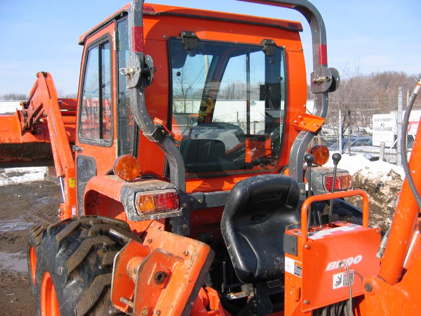

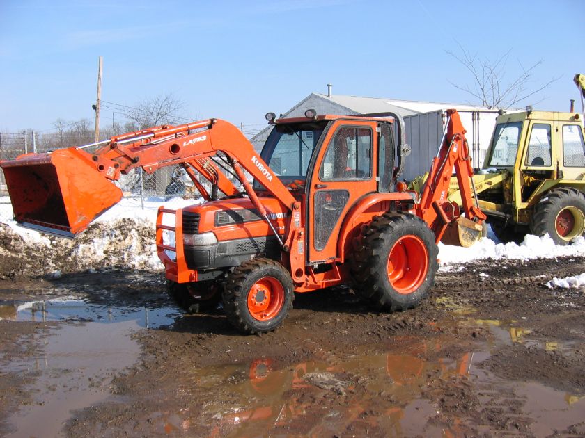

I don't know anything about attaching a BH, but these old file pictures of an L3130 show it will work. I bought the same Curtis cab unassembled for my L3830, took about 6 hrs to install. It's not very quiet, but with a set of insulated headphones it sure is comfortable with the heater in our western Canada winters.
