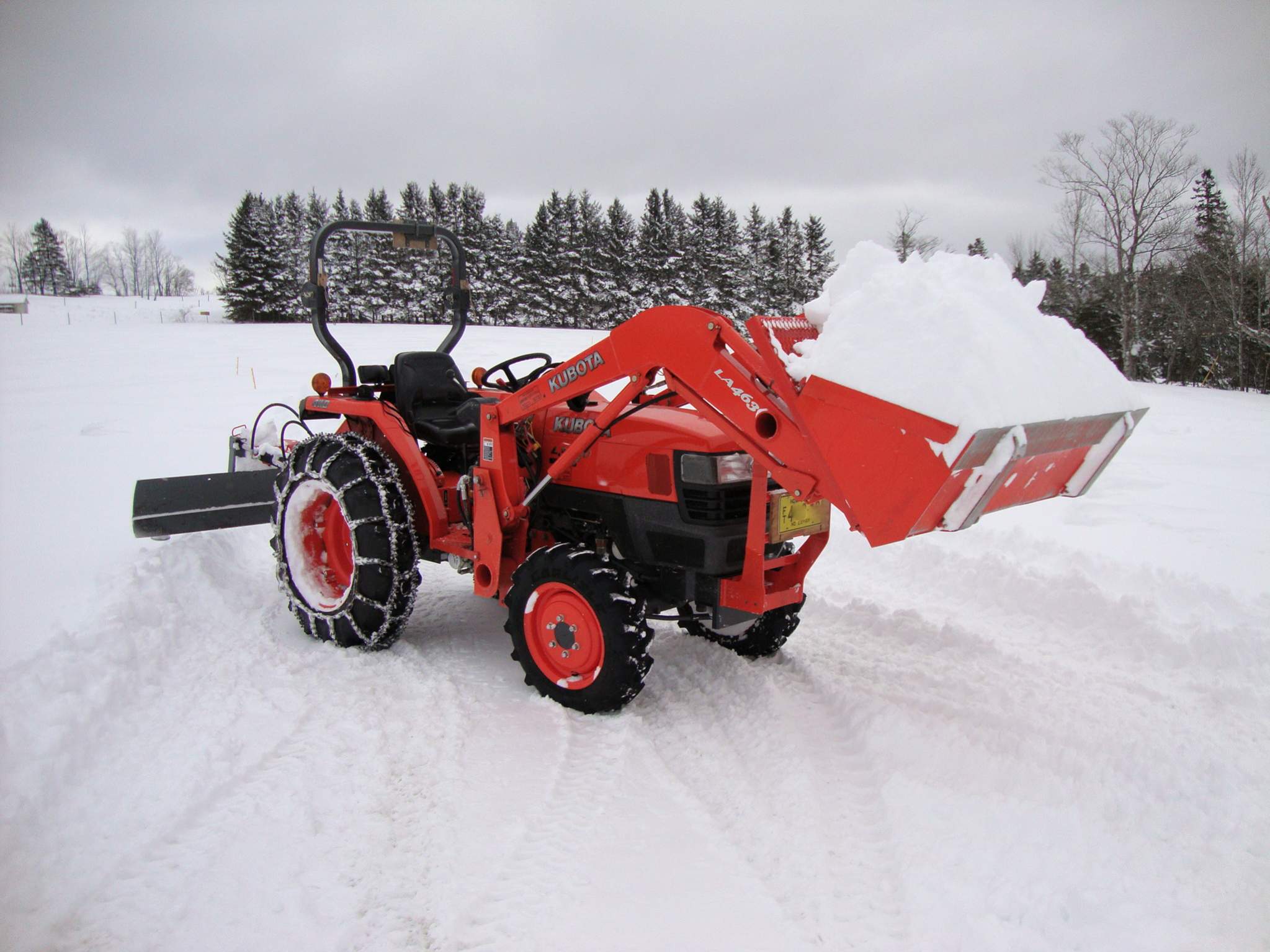

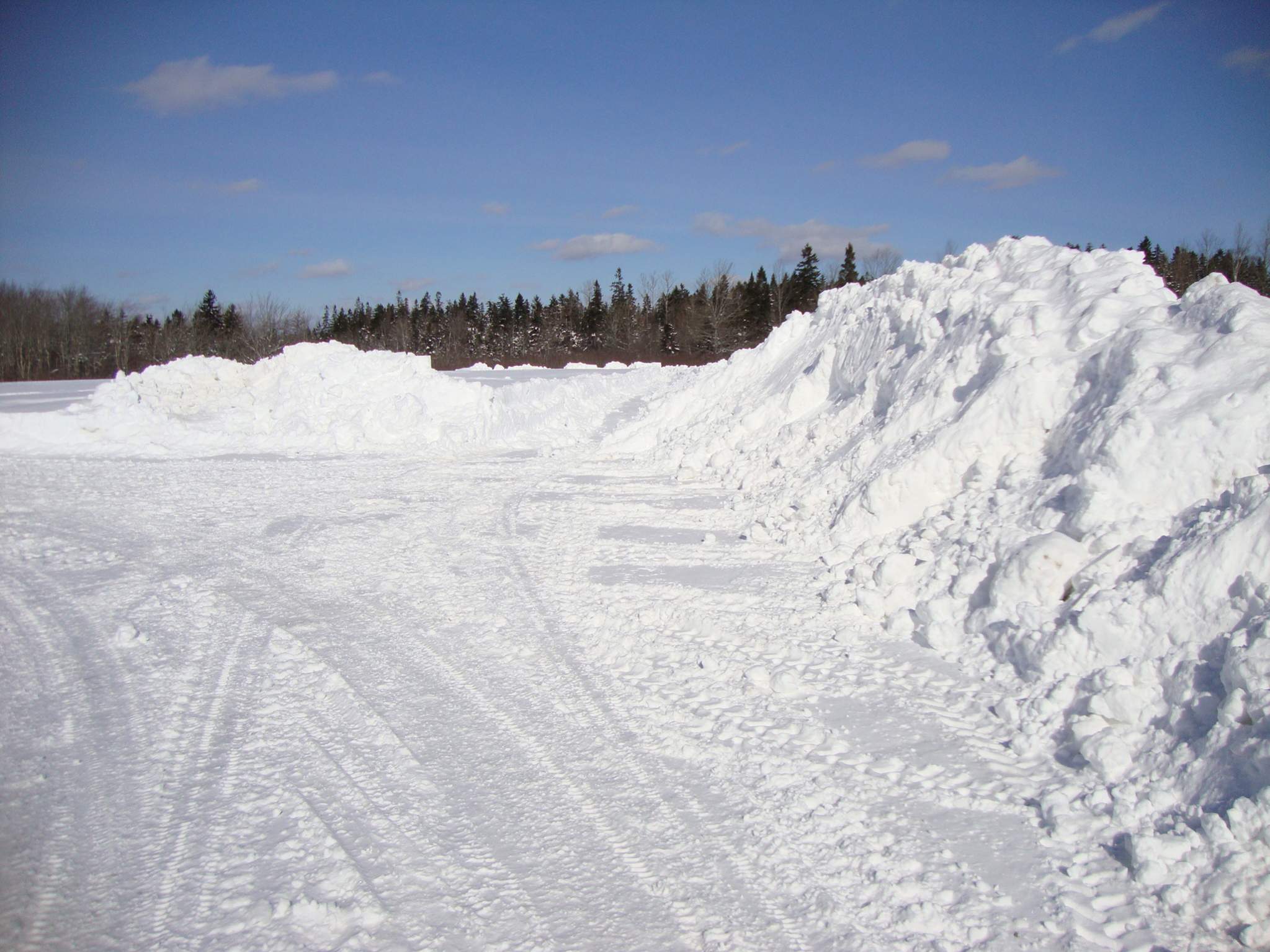

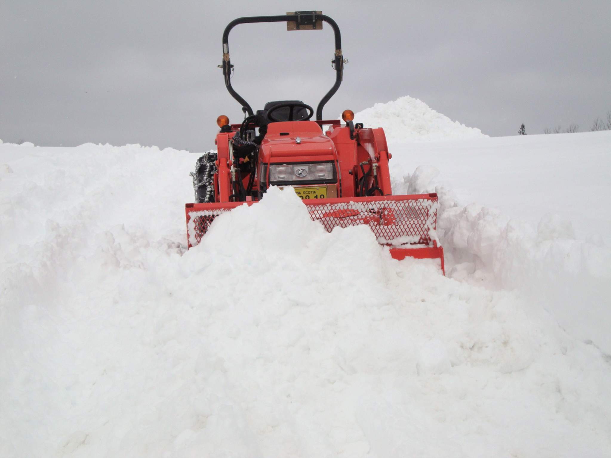

If you've only got 800 sq feet of driveway, a snowblower is overkill. Mine is 20 by 300, and the FEL bucket handled it quite well last year. This year I added a rear blade and cut my time in half. Bucket skids help a lot, as does a snow screen for the top of the bucket.
Plan where you're going to dump it early in the winter, and you'll have no problems. The L3800 has enough power and lift capacity to move some serious snow, as well as moving banks back in late winter if you need to. I've moved upwards of 2 feet of snow at times, more snow just takes a little longer.
Clear the full area every time you work, if not it'll get narrower every time until you have no room to work. That's a problem.
Sean

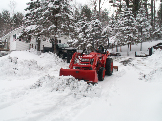

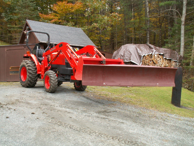

   / L3800 to plow snow #7
Snow plow works good only thing you'll have to keep the snow banks push back,more so if your in drifting area...blower one shot deal.
My setup..rear blade,front blade..one pin and use of bucket.
