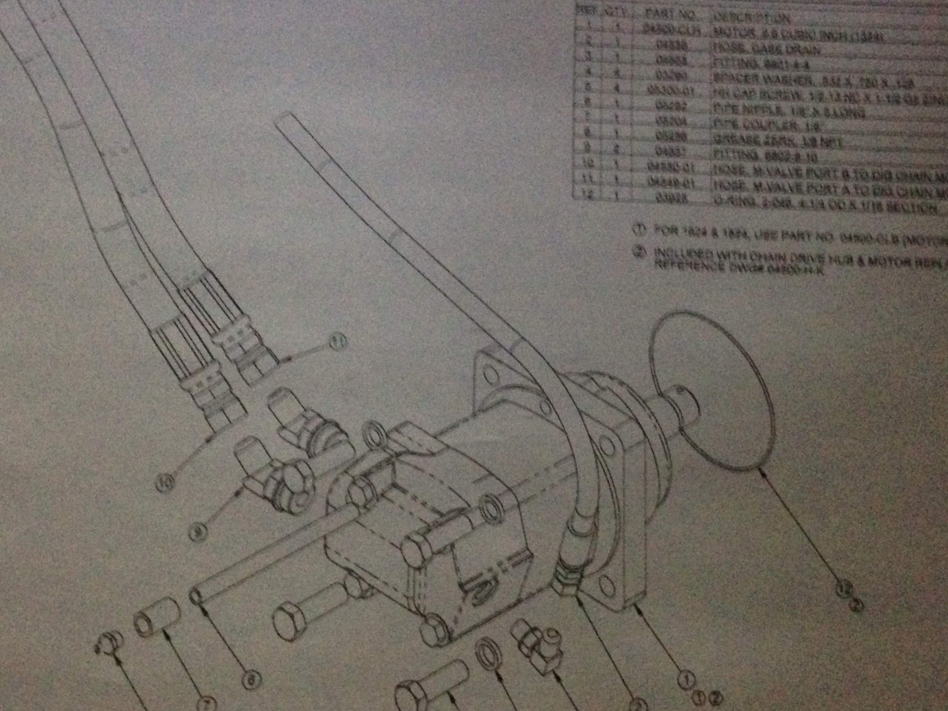

I have a walk behind trencher that we are converting to mount on a tractor. My question is if the current trencher hydraulic motor has a case drain, then where is the best place to route that line to the tractor. I know that it can not be routed to the outflow line. Any help would be appreciated.

Attached is a picture of the hydraulic motor used to run the chain. The single hose is the case drain for the pump. image.jpg

First I would try the trencher out by digging a trench to see if you have enough hydraulic capacity to do the job. Temporarily you could just run the hose back into the transmission fill hole and that would get you by. (Close the hole up with a rag to keep the dirt out.) If you can't find a hole in the transmission case to drain back into you could always buy another transmission fill cap and modify it to run a drain hose into.
I just reread your 1st post and am thinking that the tractor probably has enough hydraulic capacity to run a walk behind trencher. If you tell us which model of trencher and tractor JJ can probably tell you more about this than I can.
   / L3800 case drain line #4
The case drain should go back to the reservoir/sump unimpeded.
Maybe through a modified fill cap.
Just about any hyd flow will work. GPM's dictate speed of operation.

If you don't ever plan to install the factory remote valve kit, you can use the return port on the right side of the rear transmission case. It's covered by a blank plate that is a triangular shape, rounded (if I remember right). You could probably machine up a block that bolts over the holes, and then put a quick disconnect on the block.
Might be easier to just rig up something that takes place of the fill cap though. The return line won't see any back pressure feeding into the reservoir, so it shouldn't need a super tight fit.
   / L3800 case drain line #6
If the drain line QD ever comes off, you will blow the motor seals.
