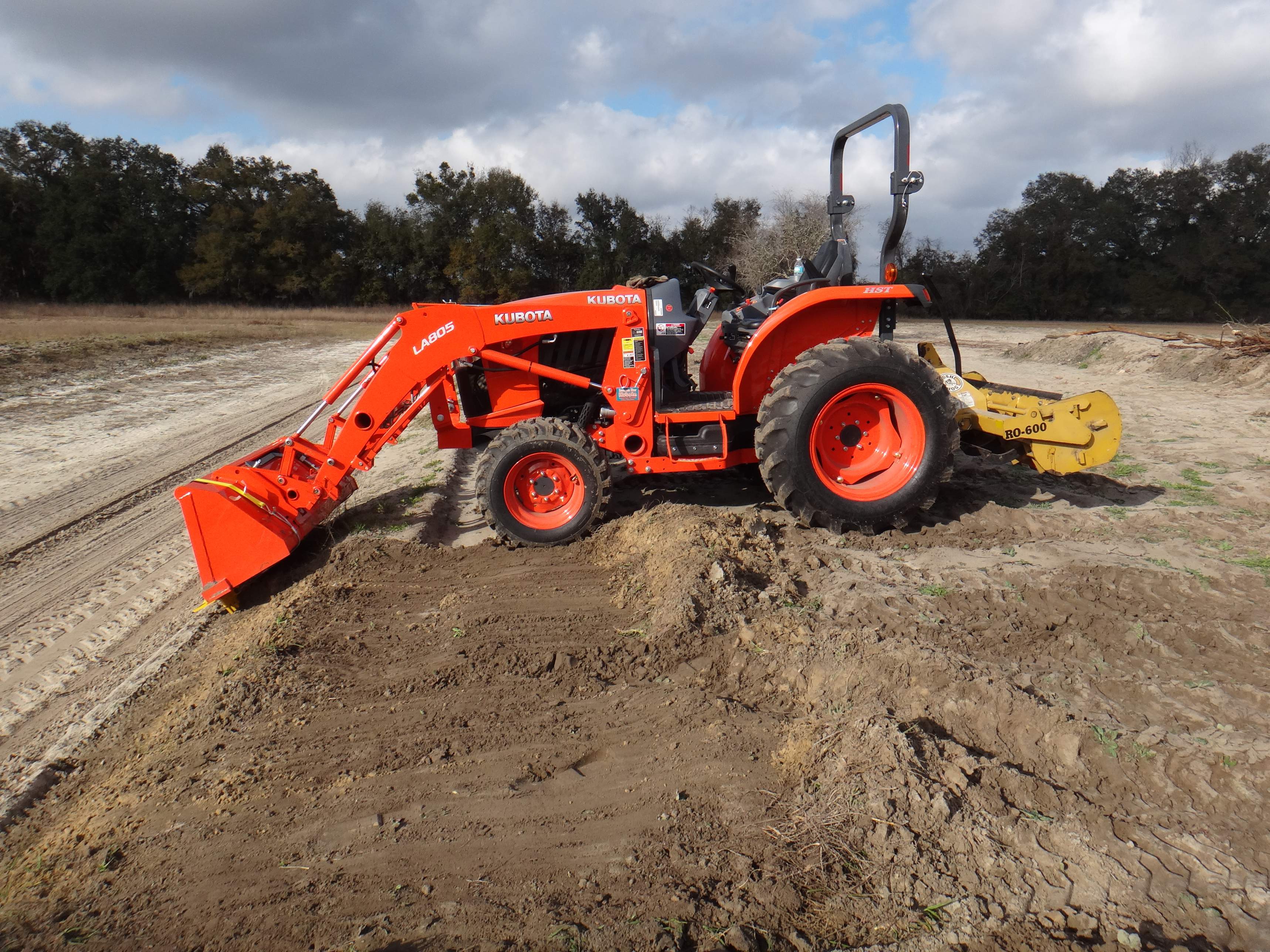

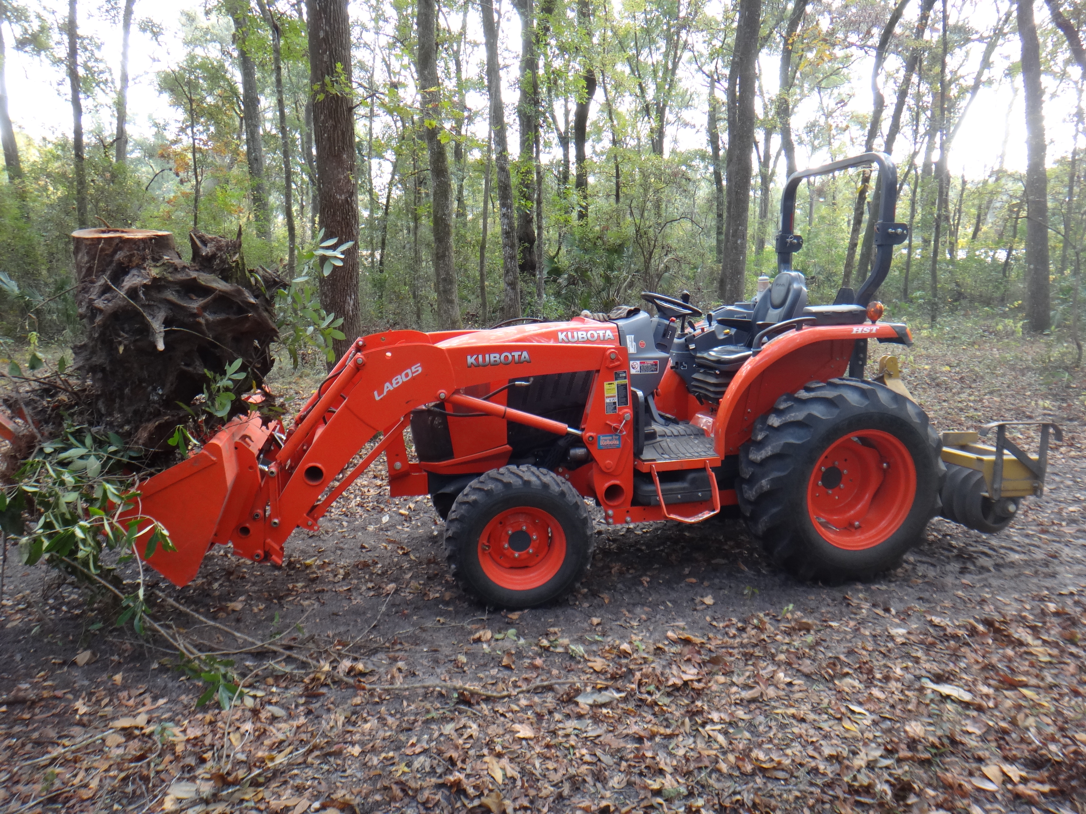

I had a Kubota B3300SU, tractor-loader package, purchased new. After 400 engine hours decided I needed more FEL lift and more weight for stability. Sold the B3300SU and purchased my current L3560 with LA 805 FEL + SSQA L2296 HD/RB Bucket.
I spend considerable time doing trail and 'commons' maintenance in my 400 acre, upscale residential community. I purchased the B3300SU for its ability to power a 60" Bush Hog while still passing between closely spaced trees, especially Oaks. Once I decided I needed more weight, my research showed to go from 1,929 pounds, bare tractor, to 3,494 pounds, bare tractor, only increased width from 58" to 60". I never considered a L4060/4760/5060/5460/6060 because of the increase in width to 66.5", 10% additional, which I knew was going to limit my passage between trees frequently.
So, yes, the L3560 is more compact than the larger Grand L's, which share a single chassis. And, yes, it feels more compact than the larger Grand L's. For me and my woods conditions, the L3560 has a perfect size and the larger Grand L's would be cumbersome with the incremental weight being slightly better but the 10% greater width a BIG impediment.

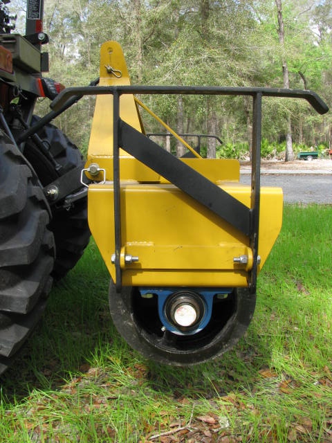

The LA805 lift is great. I have air filled R4s. When not doing Three Point Hitch work I routinely carry a 60" / 700 pound ETA Cultipacker on the Three Point Hitch as counterbalance. Cultipacker is a compact, easy to mount, implement which milti-functions well as ballast. When I anticipate heavy FEL lifts I mount my 60" / 625 pound Rollover Box Blade as counterbalance. While not as heavy as the Cultipacker, the ROBB protrudes farther to the rear and provides more effective ballast. Most of my FEL loads are dead trees and tree debris. I am prone to cut the trees into 1,000 pound loads for the FEL, or to drag them from the rear/center Drawbar, rather than lift 2,000 pound loads with the FEL, however sometimes the one ton lift of the LA805 comes in handy.
With the LA805 I suggest you order the L2296 SSQA Heavy-Duty, Round-Back Bucket in lieu of the default bucket.
The quiet engine, telescoping Lower Links and pinned stabilizers, and the multiple good features included in the HST/PLUS transmission, of which Stall Guard may be the best, are a blessing to my aging body every day.
