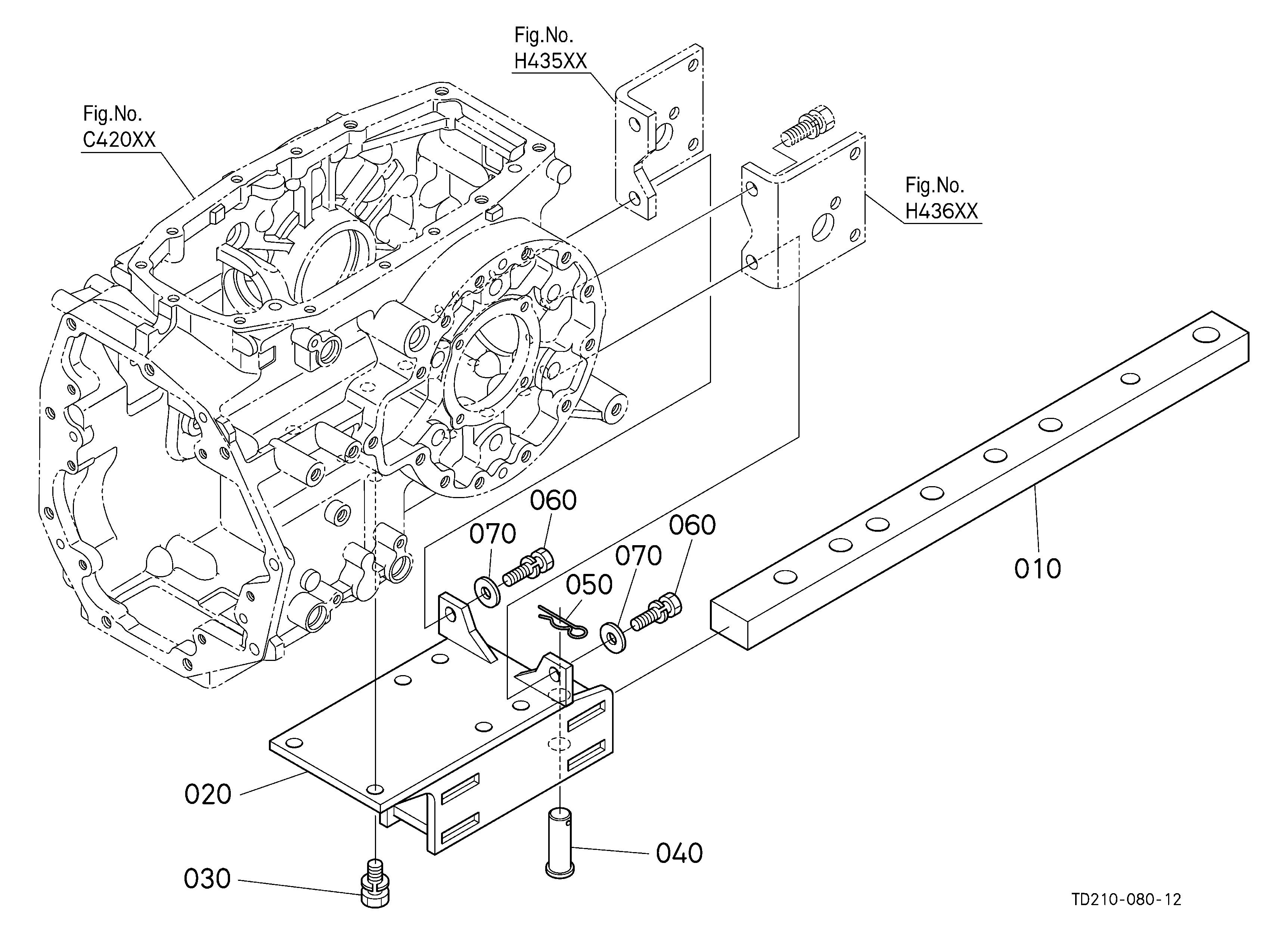

I have an L3560HSTC Limited, and just picked up a chipper so I'd like to be able to run the PTO while not in the cab. The LE doesn't come with the underseat switch that enables it, and I'd like to buy one. I know that I can do some fun stuff with bungee cords and wire splicing but if it's not that expensive I'd prefer to go the plug-and-play way. This video from Messick's mentions the part and even links to a shared cart with the unit, but that cart is expired. I've searched Messick's site and just can't find what I'm looking for. Does somebody know the part number of the unit so I could pick one up?
It should look something like this:
   / L3560 stationary PTO underseat switch part number?
That appears to be it! Thank you, I couldn't find that diagram no matter how hard I tried!
This is the part, it seems: Kubota #TD170-47920 SWITCH
   / L3560 stationary PTO underseat switch part number? #5
Also need to be in neutral with brake on.
