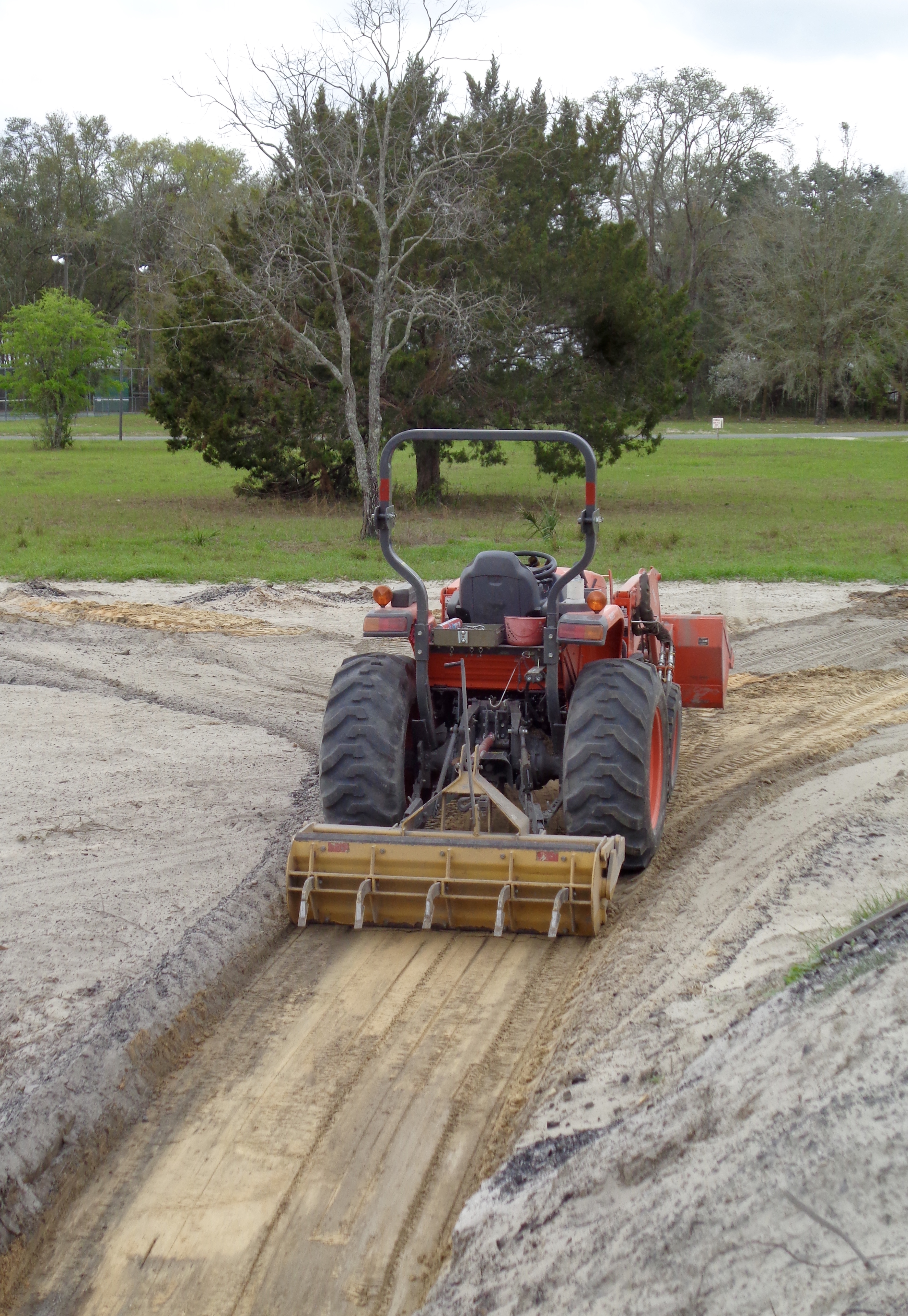

My L3560 has an outside-to-outside tire width with R4 tires of 62". As the Box Blade moves about somewhat as the tractor moves forward, a 60" operating width Box Blade completely covers 62" tires tracks. A 72" Box Blade will do equally well. TSC's CountyLine implements are made or assembled by Tarter in Kentucky. If you look closely at the implements they have Tarter labels on them.
For heavy-duty applications a heavier constructed Box Blade would be my choice. I suggest researching Rollover Box Blades for heavy-duty grading. PHOTOS

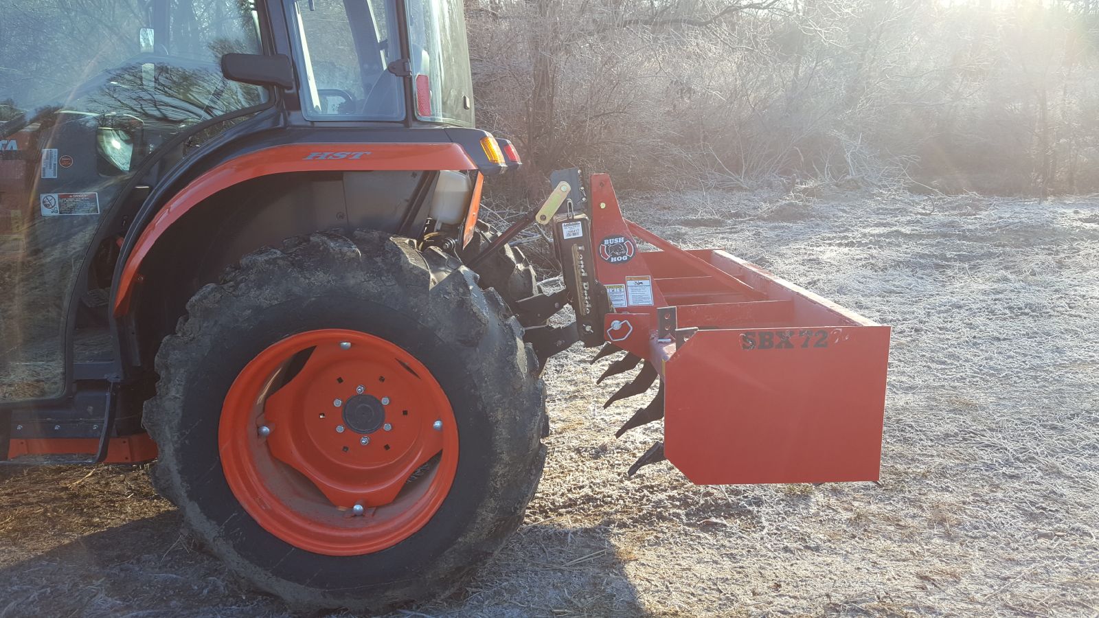

I had a L3200 & upgraded to a L4060HSTC. I had a 72" King Kutter box blade on both (will be equivalent to County Line or any cheap farm store box blade). It did ok & I dug a lot of dirt with it. It struggled badly on my driveway & our dirt road. It was just to light even with a bunch of steel strapped on for more weight. I got a good deal on an old heavy 74" Gannon & have been much happier. Its heavy & cuts so much better.
I still have the 5' King Kutter forward rotation tiller. It works fine except is a foot to skinny (bought it to match the old tractor). I really should try to upgrade it, but can't be bothered. It works fine for grooming horse arenas, which is all I use it for now.
Spend the money on the box rather than the tiller. I bet you dont end up using the tiller nearly as much. Look used, especially for a good box blade.

CountyLine private label for TSC and Tarter brand Box Blades weigh the same. The key metric is weight per unit of operating width.
As cutting performance is fairly proportional to Box Blade weight the two issues you face are: 1) Will you Box Blade be heavy enough as counterbalance to make maximum FEL lifts with LA555? 2) How much time do you want to spend grading?
Box Blades tend to be abused. There are occasional reports here of Countyline TPH towers separating from the implement, which I am sure are true, but under what conditions of use? Abusive use? I would not buy a Box Blade if I thought it needed supplemental weight added, which is inviting problems. If your intended use is light or medium duty grading, and you have the time for additional passes, which would not be needed with a heavier, deeper Box Blade, the CountyLine/Tarter brand may be ample. Even I, an implement wonk, would have to allow for: " I occasionally find 10-15% off TSC coupons which can bring the CountyLine under $800, nearly half the cost of the Land Pride."
Your money, your time, your call.

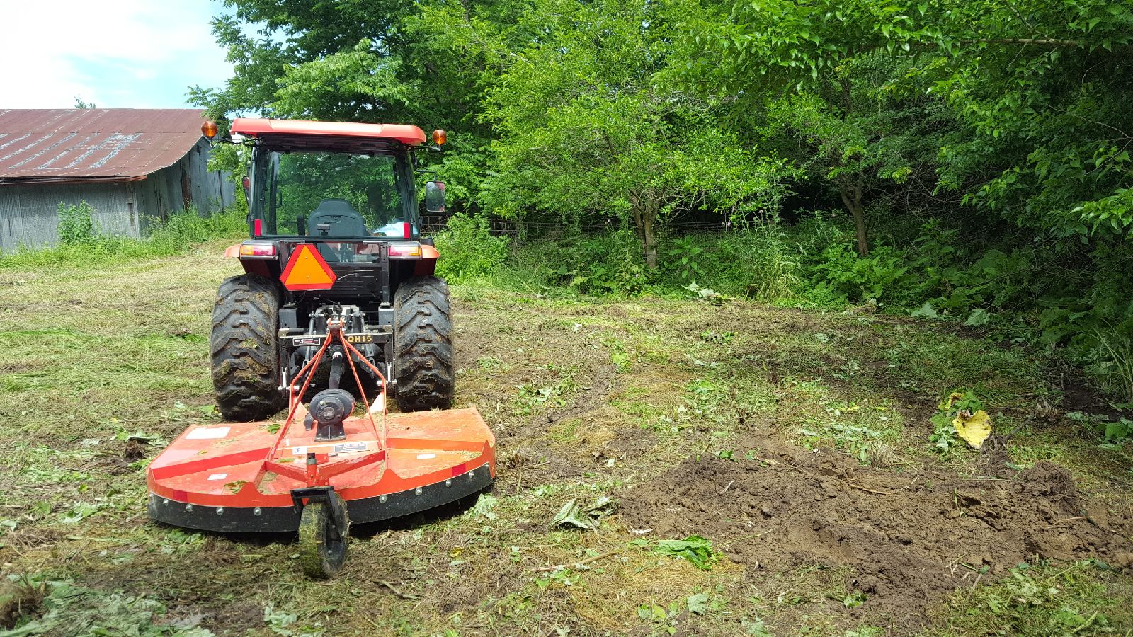

I have the L3560HSTC. Here is the mower I use:
I have only used the mower through one mowing season, but so far it has worked great. The tractor has had no issues pulling it. I have mowed through weeds/grass as I has the cab.

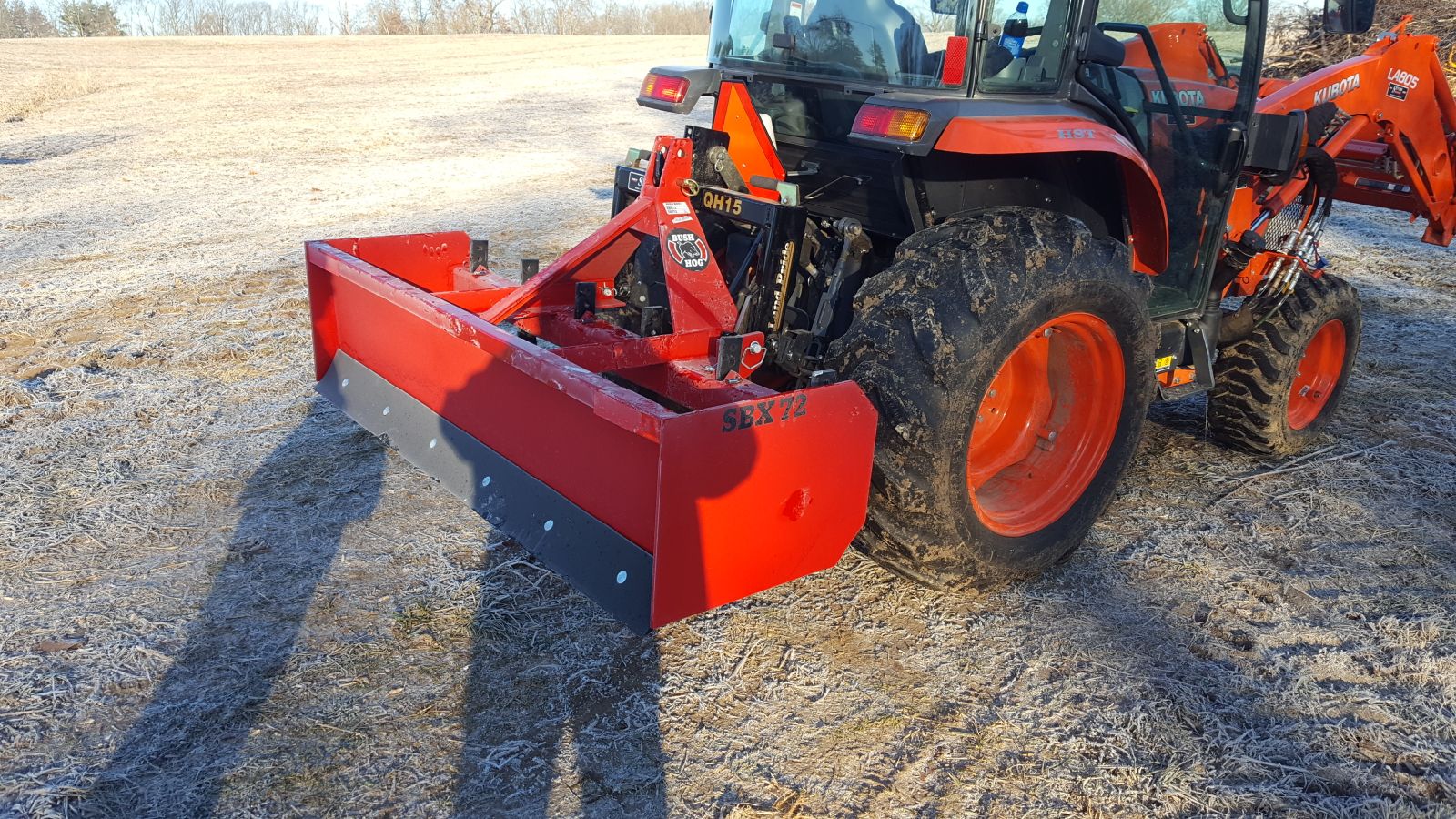

We just got a box blade a couple of months ago and been loving it. The box blade has been very handy. We got the 72" Bush Hog model.
Hopefully this will help you see what your tractor can handle. One final note, I would spend the money and get the nicer implements that are going to last as long or longer than your tractor. When we were looking at box blades, you can see a different difference in quality and you will pay more for the quality.

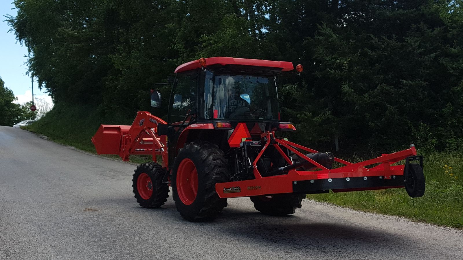

congrats on the property and equipment. I've been using finish mowers since building here in '89. First was a belly mower on a Cub 154 Loboy. I was OK but I prefer rear mowers. Around 1991 I bought a new 5' Caroni and used it steadily for 10 years. Since then it's been a beater for the little Ford it was bought for and is finally ready to retire. I did find another used one last Summer that is in better shape. I'll save good parts from the original.
Next were two LandPrides. First was an "AT" side discharge and the second a rear discharge. Good stuff, quite heavy.
A little over a year ago I stumbled onto a very used Caroni 91" that I couldn't pass up. The whole underside needed re-baffled and it needed other repairs. It was well worth the effort. I wouldn't hesitate to get a Caroni.

Tarter gate & King Kutter are the OEMs fir TSCs County Line label. It varies from time & place. But you'll often see King Kutter branded manuals on some of em around here. Really they are pretty similar, at least for box blades. Weight is a very good proxy for strength in this case & they weigh about the same. Weight is also important for cutting.
While I dont regret getting my King Kutter box blade I did replace it. Heavier is better if your tractor can lift it.
Box blades do get abused, but it's not like they are fancy precision things. Used may look ugly but will function just fine at a fraction of the price. Of all the impliments 3pt blades are going to be the best things to get used. No bearings, shafts or moving parts to wear out.
Does it have its scarfiers? $200ish for a new set
Is it bent? Walk away unless it's really cheap.
Is the cutting edge worn out? $300 for a new one (they can often be flipped though). Walk away if its welded on though.
