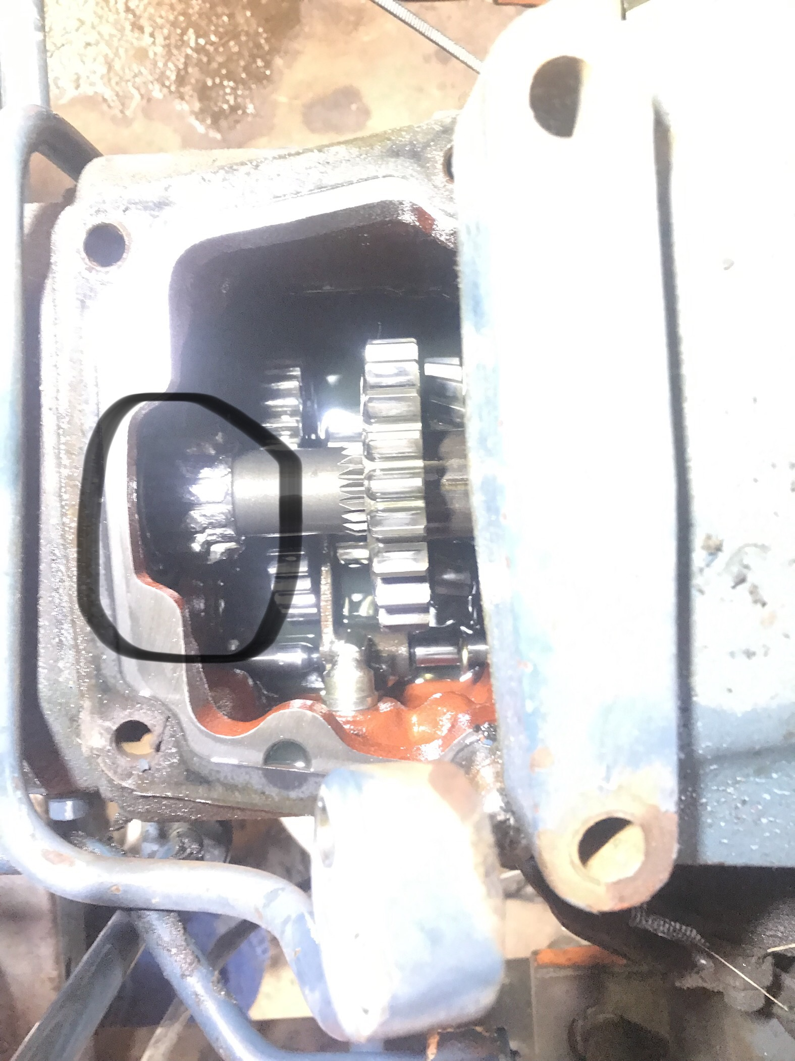

The clacking noise in low range indicates a damaged gear or bearing in the range selector (maybe part 1 or 4 in the attached drawing). Should be able to see something if you lift off the hydraulic unit under the seat. To replace things in there the tractor needs to be split at the front of the differential case - not a huge project, but not trivial either. Maybe Wolfman has a WSM? Several models use the same parts L295, L305, L345, L355.
Check availability of the needed parts before splitting the tractor. The 2-row gear is expensive half price one here but some pieces may take time to find. Left in high range it should run quietly a long time.

I know this is an older post, but I unfortunately fell victim to this same issue and it was the range selector gear.
