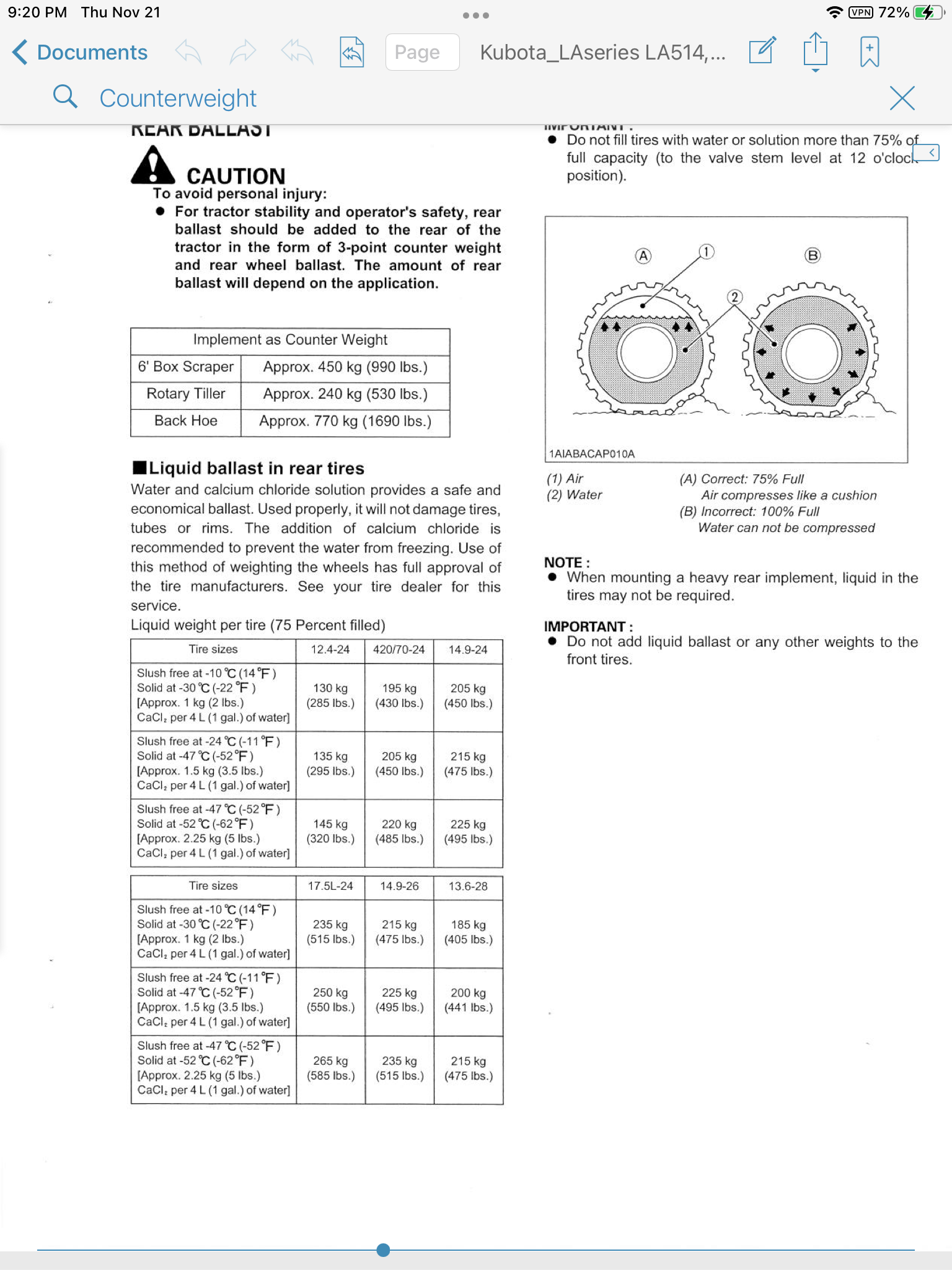

Please, don't comment on what you do or whst other manuals state. Does, anywhere, in the manual for Kubota L3540 read that you need to put a weight box on the 3pt hitch to use the FEL?
No manual in hand, trying to see what the manual, for this tractor literally says about this.
Thanks

The manual generically discusses ballast in the form of liquid filled rears and cast iron. There is no mention of 3 point ballast for loader use.
3 point ballast may be discussed in the loader manual, but I didn't know what loader you have or have access to any of them.
   / L3540 counterbalance, what manual say? #3
The info you desire will be in the LOADER Operator's Manual.
Not the tractor operators Manual
For a LA434 Loader, the rear weight is between 350 and 700 pounds. Based on rear implement attachment.
I just checked!
   / L3540 counterbalance, what manual say? #4
The operators manual for your machine says absolutely nothing about needing to put a weight box on the 3pt hitch to use the FEL. As menioned in earlier posts, counterweight information is contained in the loader manual.
Here is the page from my loader manual. It is for the LA514, LA524 and LA854. I believe these are the loaders that are used on your machine.

I think both are right, just from different perspectives.
Adding weight to the rear wheels will keep them more firmly on the ground.
Adding weight on the 3pt will also keep them more firmly on the ground.
Adding weight on the 3pt will reduce weight on the front axle.
From the manual above:
