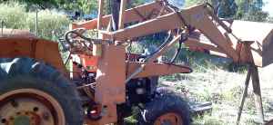

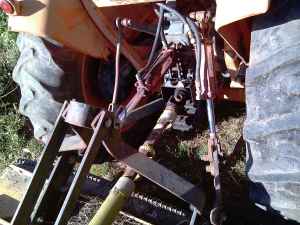

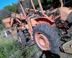

Would love to have a tractor but dont have the cash for something nice. I came across an ad and the owner says "2nd gear is bad". He wants $4500 including a L1720 loader. Dont know the hours but it has been kept outside and looks pretty beat. Pics are attached.
Can I resonably use this around my property for landscaping work without second gear? Any idea what it takes to repair?
What do you think of the price? Any advice is appreciated!

I had a 245DT, you NEED 2nd gear.
No idea on cost.
E/S
   / L345DT with trans problem #3
I own a l-305 the 3 cyl version with the same bucket plus a back hoe it is a great machine.when I run empty I use high 3rd gear.when diging into a pile I use low 1st gear. you could use high 1st to mimic 2nd gear.make sure reverse works as I think it is the same as 2nd. I would say buy it for 3000.00 or 3500.00. use it while you search for a way to fix it. the bucket will lift a large round bale over 1500 lbs.it will lift over 8 feet.
   / L345DT with trans problem #4
...the owner says "2nd gear is bad"....
That *might* be the only thing he'll admit is bad in the ad... "Buyer beware" Might be worth a look if you are really good at fixing this kind of stuff.
The best stuff that I buy off Craig's list, still needs way, way more work then the seller ever leads on to. If I didn't weld, I would have be screwed a couple of times. That's a bunch of money... test out the tractor a whole bunch before you commit - If you don't know what to look at, take someone knowledgeable along with you. I personally would walk away from this one, looks pretty rough to me.
   / L345DT with trans problem #5
Keep looking, that thing will be a money pit! You can find better for the same or a little more money.
