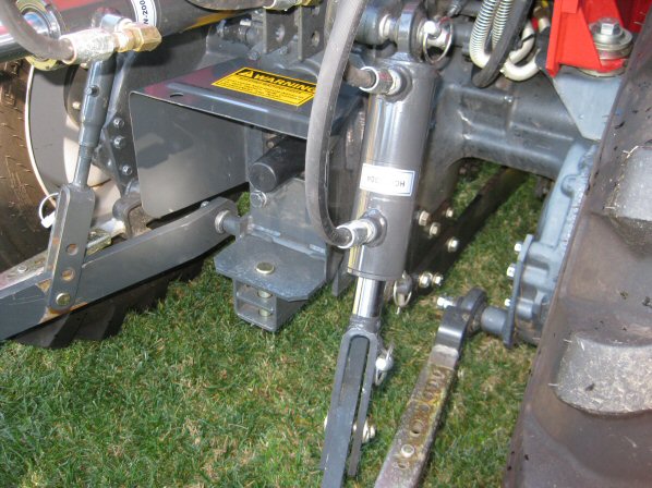

A hydraulic side link is the easiest way, not the cheapest at $250, but it is the easiest. ;)

All I said was that it was the easiest, Am I wrong? :confused3:
Obviously you are supposed to have the implement on the ground to manually adjust the top or side link.
So when one is grading, you are saying that in certain situations you are supposed to get off of the tractor every 10-15 seconds to adjust your hitch to be able to have your blade in the proper position? If you want to be able to adjust an implement in the air, under a load, on the fly, a hydraulic side link is the way to accomplish this. Just about every commercial company that does more than a little grading has hydraulic top and tilt cylinders, but I guess that all of those guys are just lazy. :rolleyes: Having top and tilt cylinders wouldn't have anything to do with getting a job done right and in a timely manor. They are really just for lazy people that don't know what their doing. :rolleyes:
