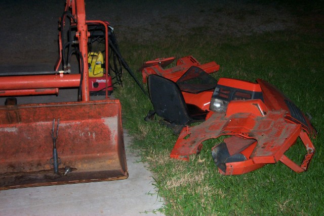

Dismantled it to find out what was wrong (local dealer was backed up several weeks on repairs). First step, remove loader and all the sheet metal.

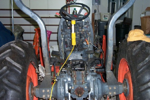

When it was stripped to this point I could reach down into the "guts" of the tractor and I started to pull out large and small pieces of metal. How bad was it going to be???

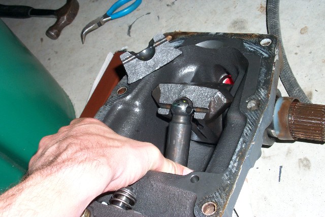

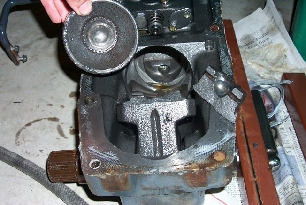

The casting which the 3 point piston rod pushes against had failed. I was able get out all of the metal chips and piston rings but I could not find the roll pin. I later located the roll pin when I changed the filter.

The piston was then pushed out of the bore and bounced around in the gearing before coming to a rest in a "safe" part of the gear case. It was not reusable but the tractor's gears looked great.

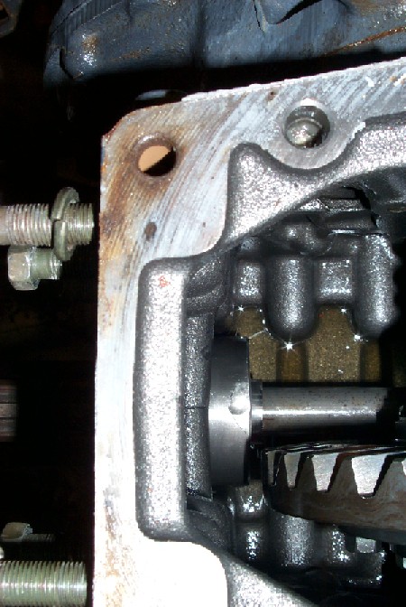

The inside of the housing that retains the PTO shaft rear bearing took a good hit from the piston or rod but I chose not to replace the PTO housing. The bearing is set back from the damage enought that I think I will be all right.
The new parts/pieces ran about $150 and were easy enough to install. I tapped the new piston in with a 2x2. After it was all reassembled I readjusted the external rod that runs from under the seat back to the left side lift arm. Works great. Now I have about a month of tractor work to catch up on.

I am clueless on what caused it. Tractor has 800+ hours; only hypothesis dealer had was a failed pressure relief valve. I don't think so. The lift arms were bunjee'd at the time so I dont' think they rode up a tire. Only implements I have had hooked up for past 3 months were pull type mower and box blade (sand). The casting failure looked sudden although I suppose its hard to tell on an internal failure like this since rust/dirt in a stress crack will not be present??
Since it was so apart I was going to split the tractor front to back to fix a developing leak/overnight drip. However I found the top two North/South bolts to be very loose. These were accessible thru the rubber inspection cover located by the clutch pedal. A little tightening and no more leak.
