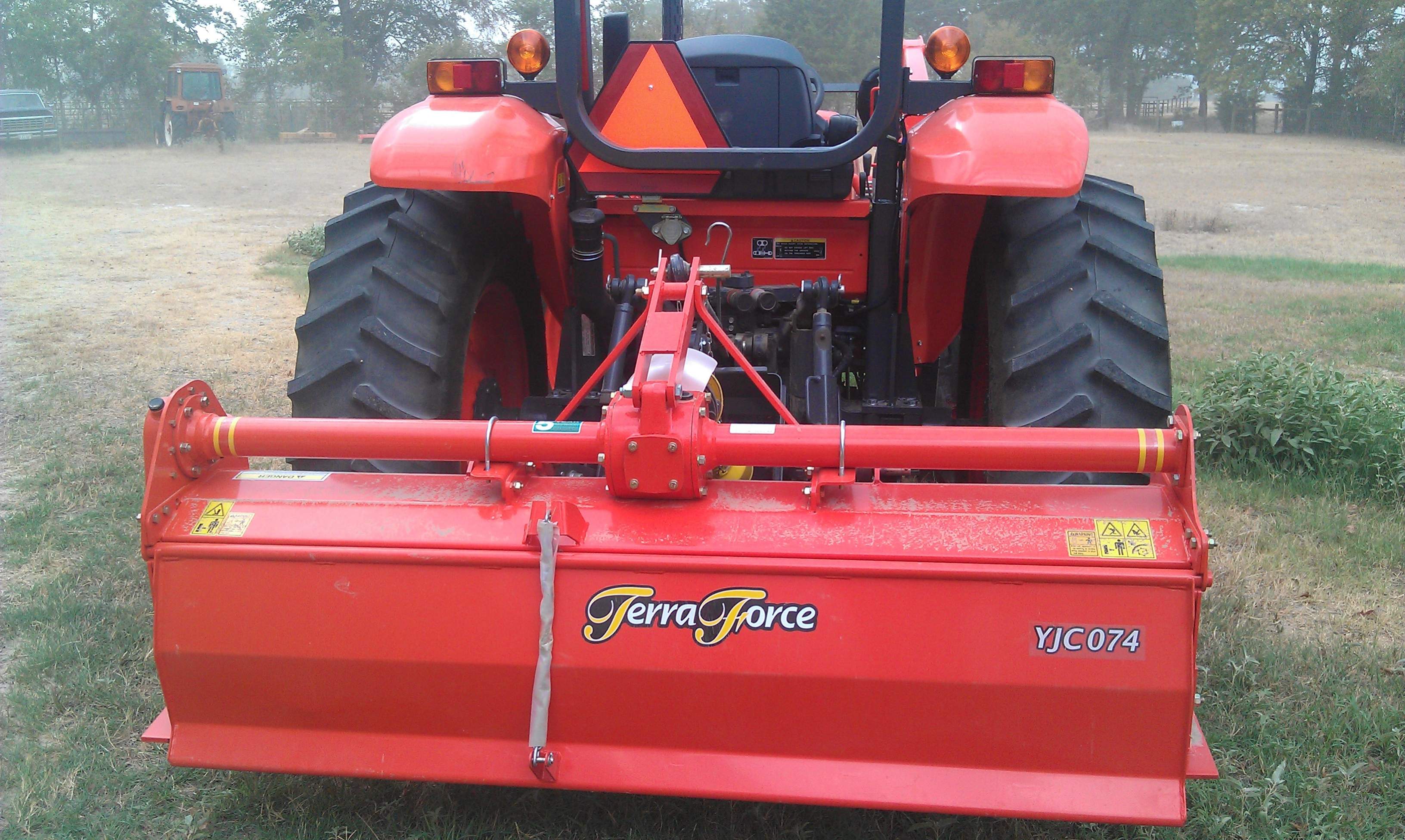

I think the deals are getting better on used disc,cause Tillers. With the Tiller can really get those gardens turned over with less passes. Same goes with the food plots,also the Tiller really works good on hog roots unlike the disc. The disc are bulky to get into smaller gardens were maybe the Tiller is better cause not using the tractor speed as with the disc but just the pto speed. Just my suggestion..But to reply to your question gonna depend on what type of soil and how agressive you have your disc set,if you have to work multipul passes once the soil gets loose tractor mite spin trying to pull 6.5'.Just my 2cents

i say look into getting a tiller insted of a disc.

Having a tiller for the garden would be great but a lot of our food plots have some stumps that are hidden right under the soil.

Stumps, rocks and roots won't be an issue if you get a tiller with a slip clutch instead of shear bolts. You will have much better luck, results and practical uses with a tiller. I use a Woods 6' reverse rotation tiller with a slip clutch on my L3940. I'll never use a disc unless I need to turn acres and acres of soil. I use my tiller on a 1 acre food plot for deer. :thumbsup:

Does it have alot of stumps or just a few? I have hit stumps with mine(never hurt anything),if I know there mite be some out there and kinda know the area were they are I just idle down some. You dont have power down(3point) so it will just jump around some and can pick up(3pt) some until you get over it. I sometimes just put my tractor in neutral and let the Tiller push it along and it will just ride over the stump pretty easy(without the rodeo):D....

I have GL3240 GST. I bought the largest one the owners manual said I could use and have no problems pulling it. I believe it states no larger than a 6ft and no more than 770 pounds. On vacation and don't rightly remember. I'm pretty sure it is a 6 foot, 20 disc. I also bought a tiller first. It turns NC red clay into portland. So I bought the disc and started using it, then dragging to even it out. I've had to recut the tilled areas with the disc to rebreak it. As the username implies, I'm a rookie and could have done something wrong. hope this helps
