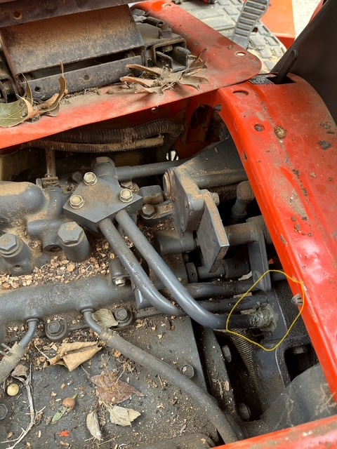

I have a hydraulic leak in one of the hard lines on the block to my rear remotes. See highlighted circle in pic. Someone has used jb weld on it in the past but its leaking again. I cant find a part number for the block or on a diagram. Can anyone help with a part number. Its an L3240DT.
On another note, thoughts on removing it, cleaning up the jb weld and then welding?
Thanks
   / L3240 Remote Line Leak #2
This should be it, I believe:
Can't really see how they connected the hard lines to both hydraulic blocks. Looking at this pictures from another part that's for sale, it might be brazed. Not the same part number though.
   / L3240 Remote Line Leak #3
Yah that JB weld is a mess for sure. Hopefully that was a previous owner, not you. Never use that to repair hydraulics! Messicks can also help you with parts. Very helpful folks with diagrams online too.
