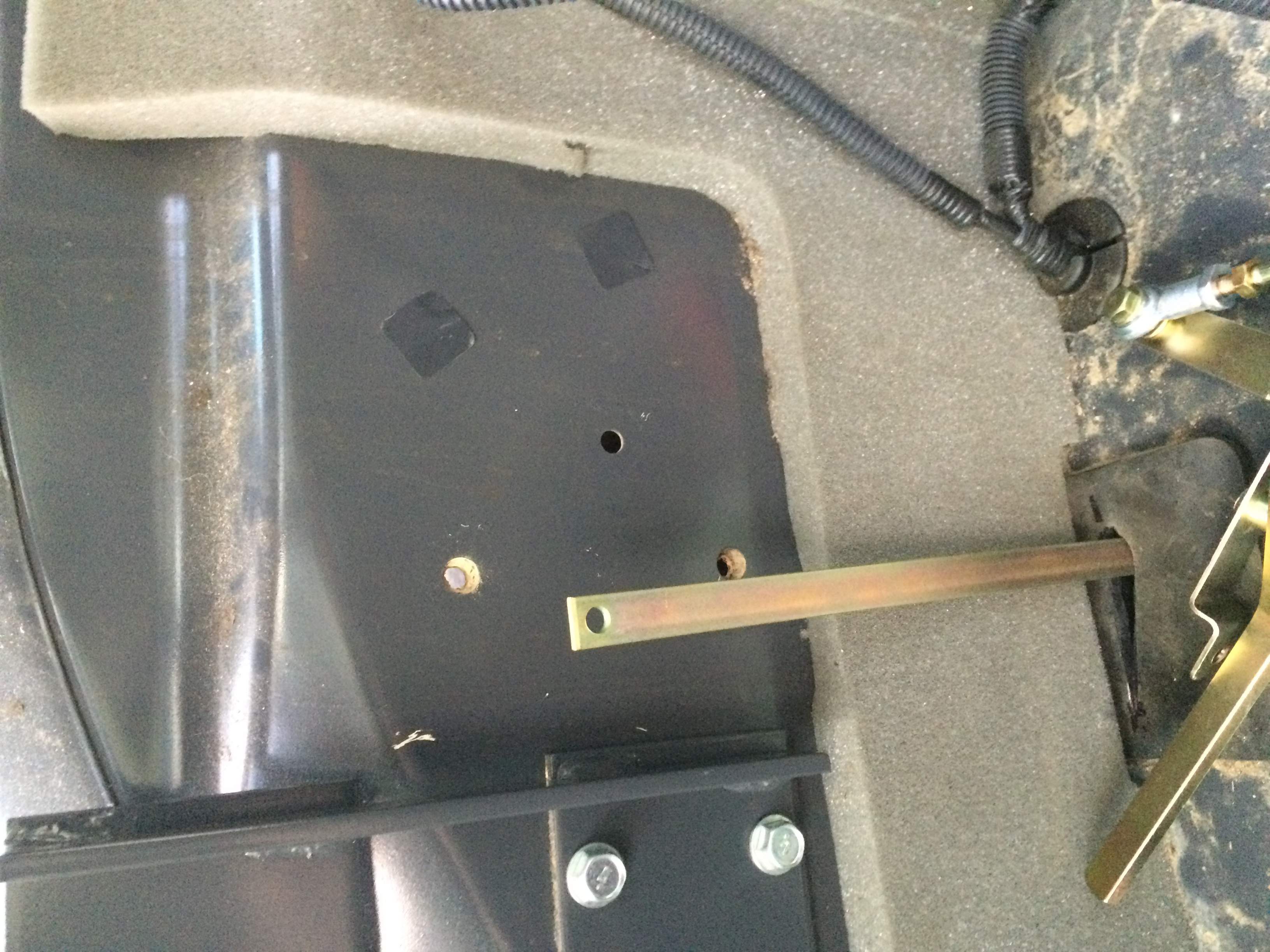

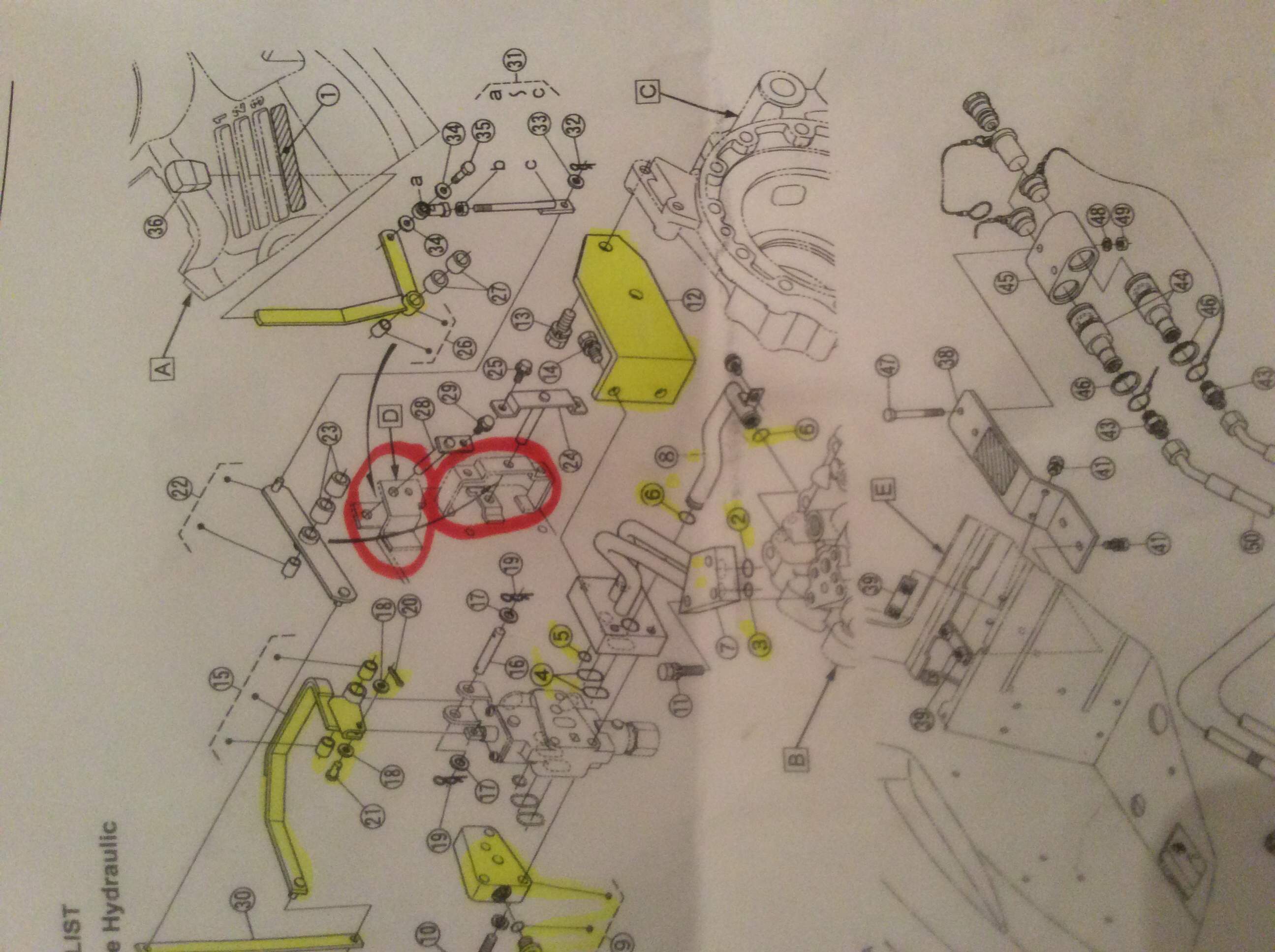

Trying to install the kit I bought for installing rear remote on my kubota l3240. The issue I'm having is with the lever assembly. The parts I circled in red in the picture I can't seem to find in the box or anywhere on the tractor. Any ideas?

I put one of these kits on my Brother's L3240 a few years ago. I thought maybe I still had the paperwork but can't find it. I am unsure from the pics you've attached. I don't have any memory of those parts either. I'm very sorry I can't help you. :(

Cab model? Not exactly the same but very close. The gray parts were attached to the fender on mine.
   / L3240 rear remote question #6
Yep, I think your right C4, they were already on my Brother's tractor too.
