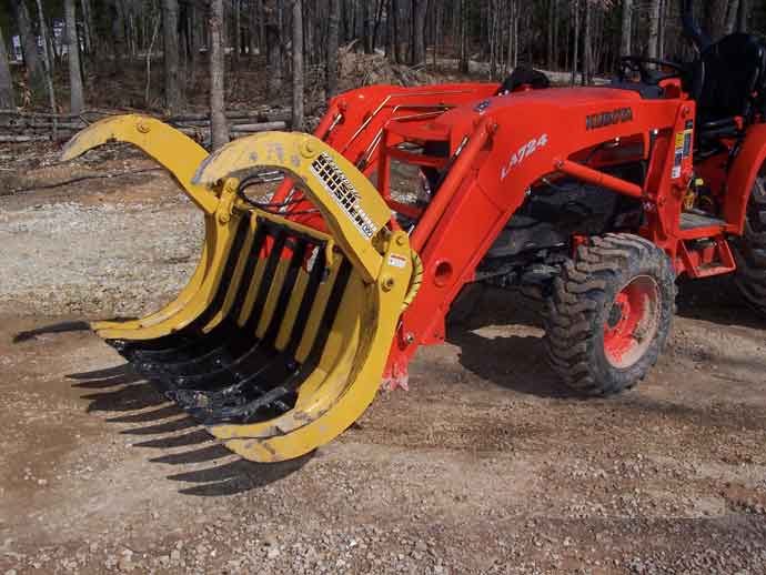

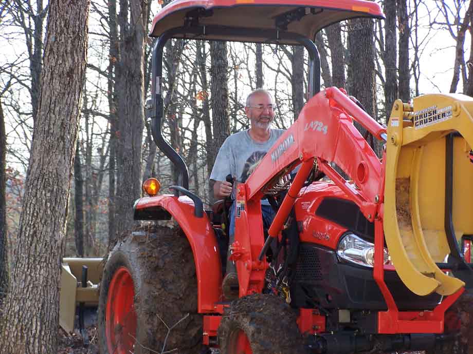

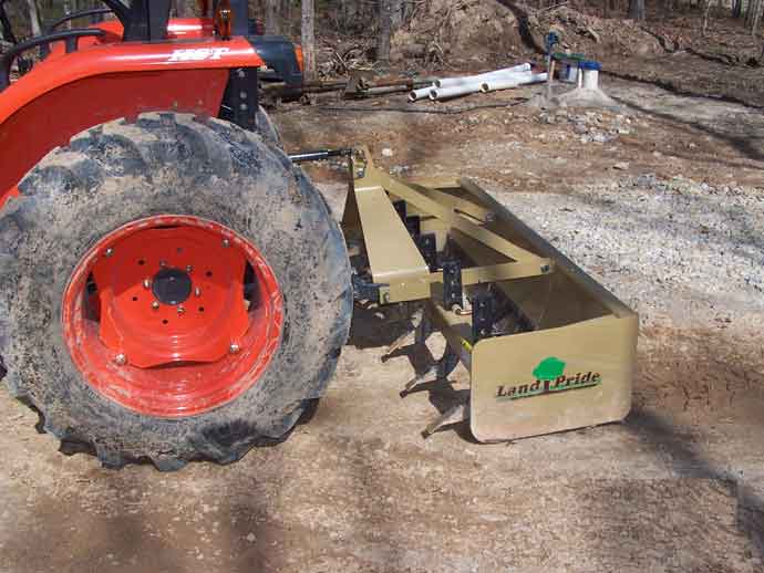

Sorry . . .
Here are a few pictures !!!
I'll add more later.

Great photos!
Wow! You got quite a bite on you.... front and rear:eek: I'm not going to mess with you!
When I began picking up some really heavy stuff, I discovered I had to do the following:
Increase front tire pressure to max stated on the tire sidewall... to keep them inflated under heavy load, prevent rolling tire off rim on tight, loaded turns
Add 1000 plus pounds weight on 3ph carry all to keep rear tires (which are filled) firmly on the ground.
Suggest you consider same.
You have some FUN ahead of you!
