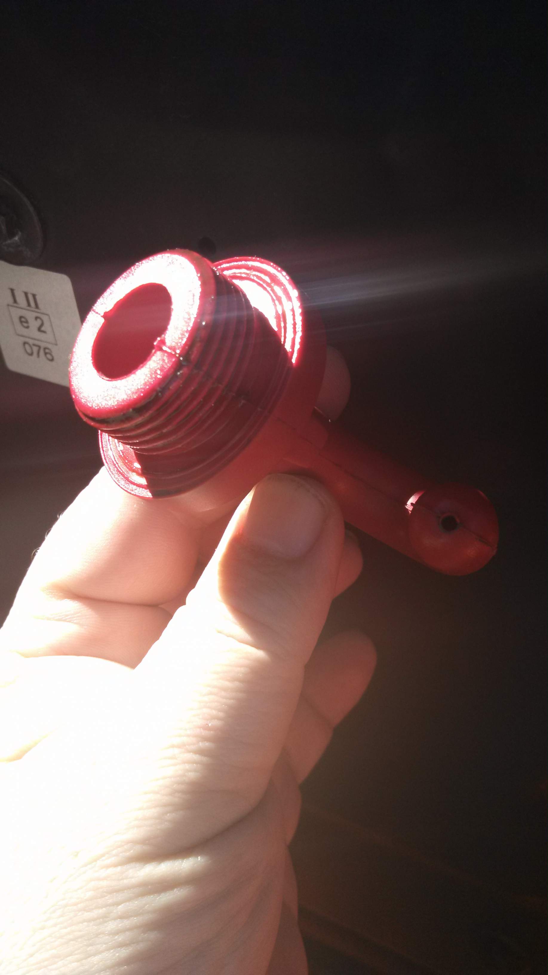

I tried something else yesterday, But I can't say for sure what the results would be on the 'bota. I did this with my Kioti. I put a #6 machine screw in the air vent. On the Kioti it is the rubber screw in stopper on the fill port. on your Kubota the fill port is not the air vent, the air vent is up under the seat. It is the "shepards crook" looking rubber piece with a hole in the end. Anyway I lost maybe 2 or 3 ounces of fluid when I removed the large vertical hydraulic filter. Not counting the actual fluid inside of the filter of course, but very little fluid dripped out while I was changing the filter. Now I don't know how much would have come out without the screw stuck in the air vent and I wasn't going to get up and remove it to find out. Here is a picture of the vent on the Kioti. Note the small hole in the end IMG_20130922_150416_989.jpg

The shopvac trick is to put a shop vac (turned on) over the hydraulic fill hole. It creates a vacuum inside the case of the tractor. Prevents loosing any fluid when doing a filter change or any other hydraulic work. It dont completely eliminate loosing fluid. But minimizes it big time.
