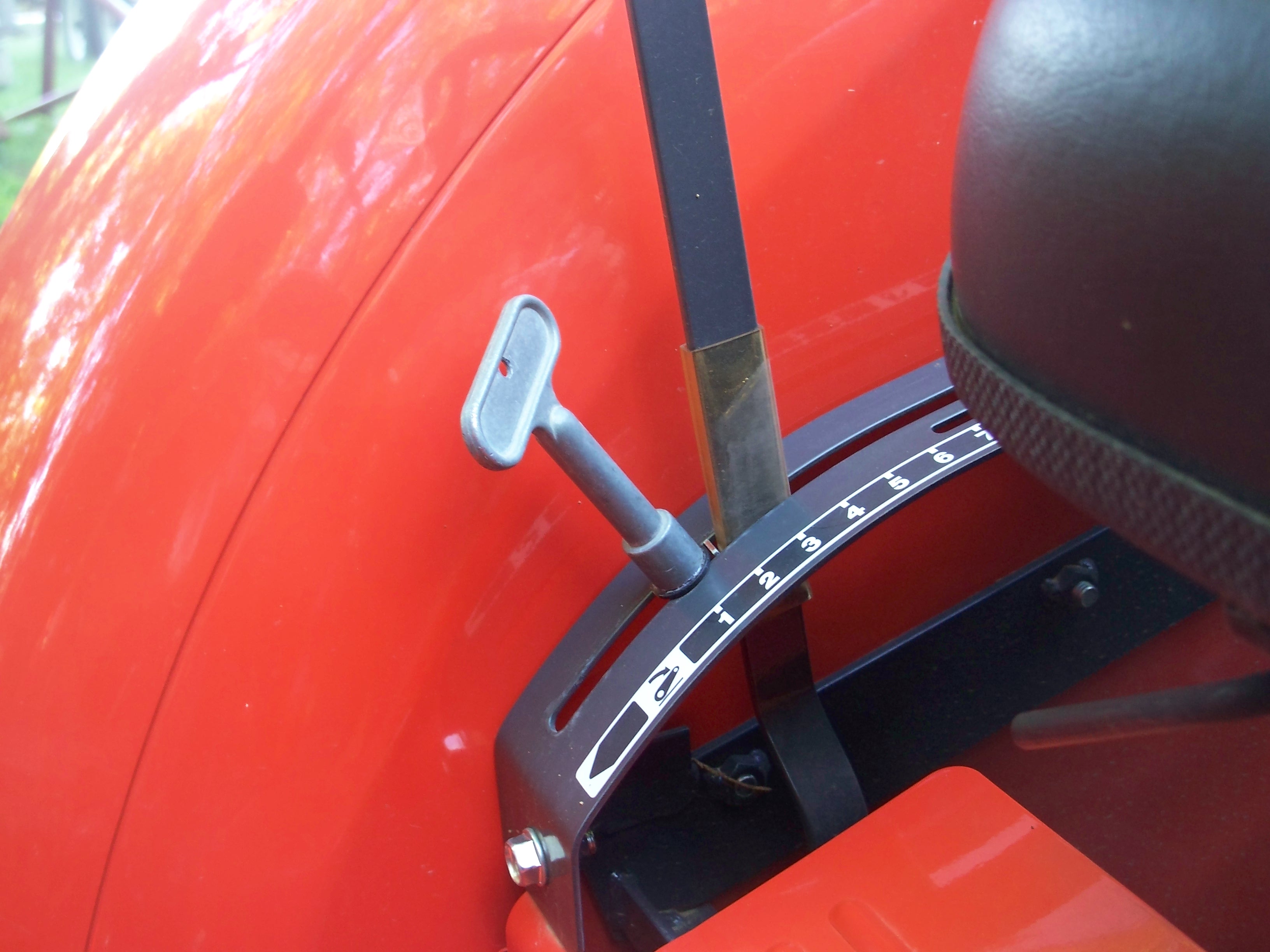

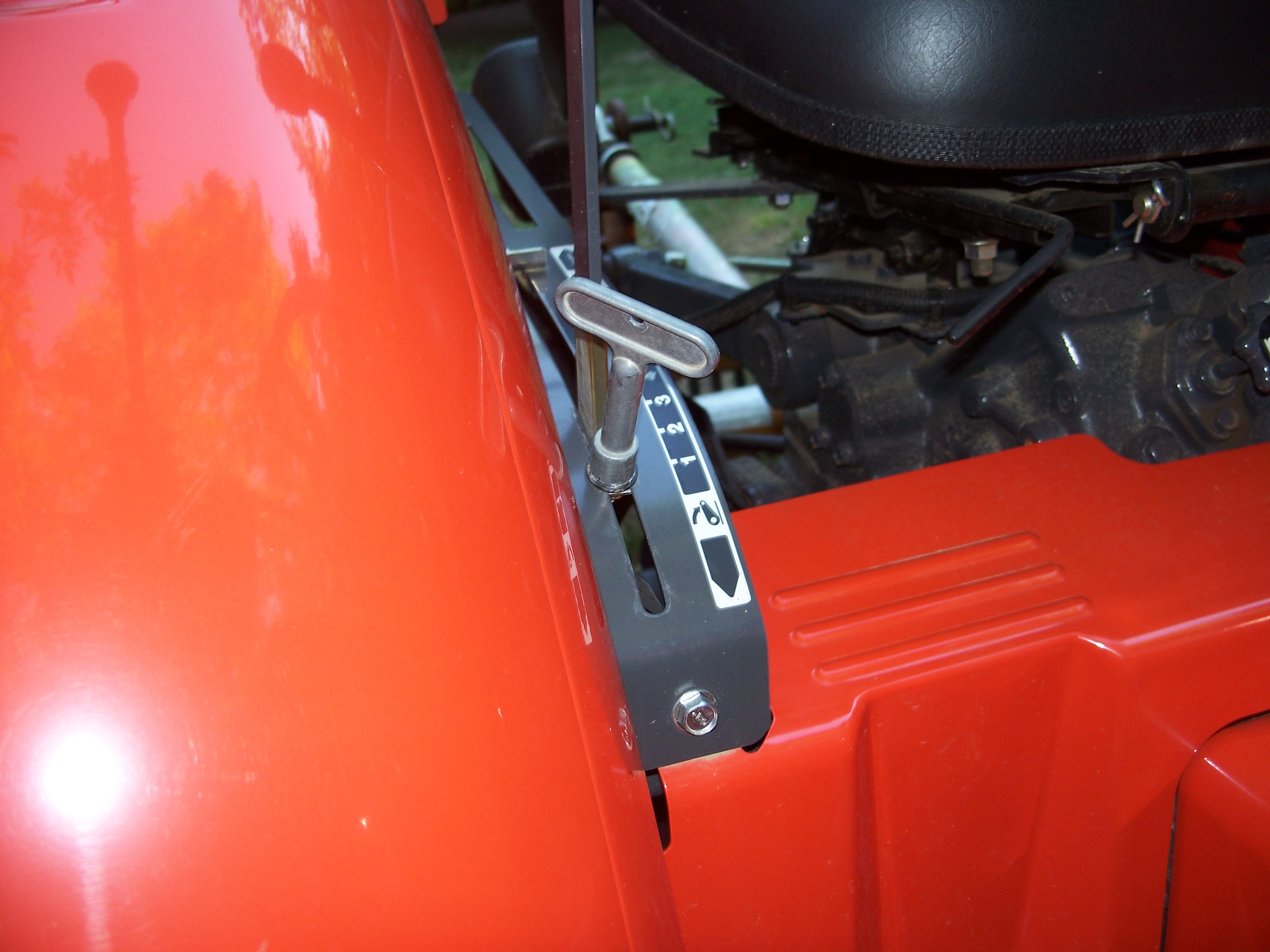

Well somebody at Kubota should be ashamed.
The itty-bitty depth preset knob for the 3-pt. lever on the L3200/3800 is, to put it gently, a JOKE. They might as well have left it off as it's not usable without a pair of pliers. No, I do NOT have weak hands; quite the opposite.
I removed the tiny plastic knob and replaced it with what we used to call a "water key", for turning exterior spigots on and off on commercial buildings.
I had to buy a new bolt and some Devcon Metal epoxy, and epoxied the new bolt to the key. At some point I'll drill it and put in a roll pin.
A day later I was much happier. Easy to turn and adjust and the key is not in the way. I'm sure other items could be adapted for this use.

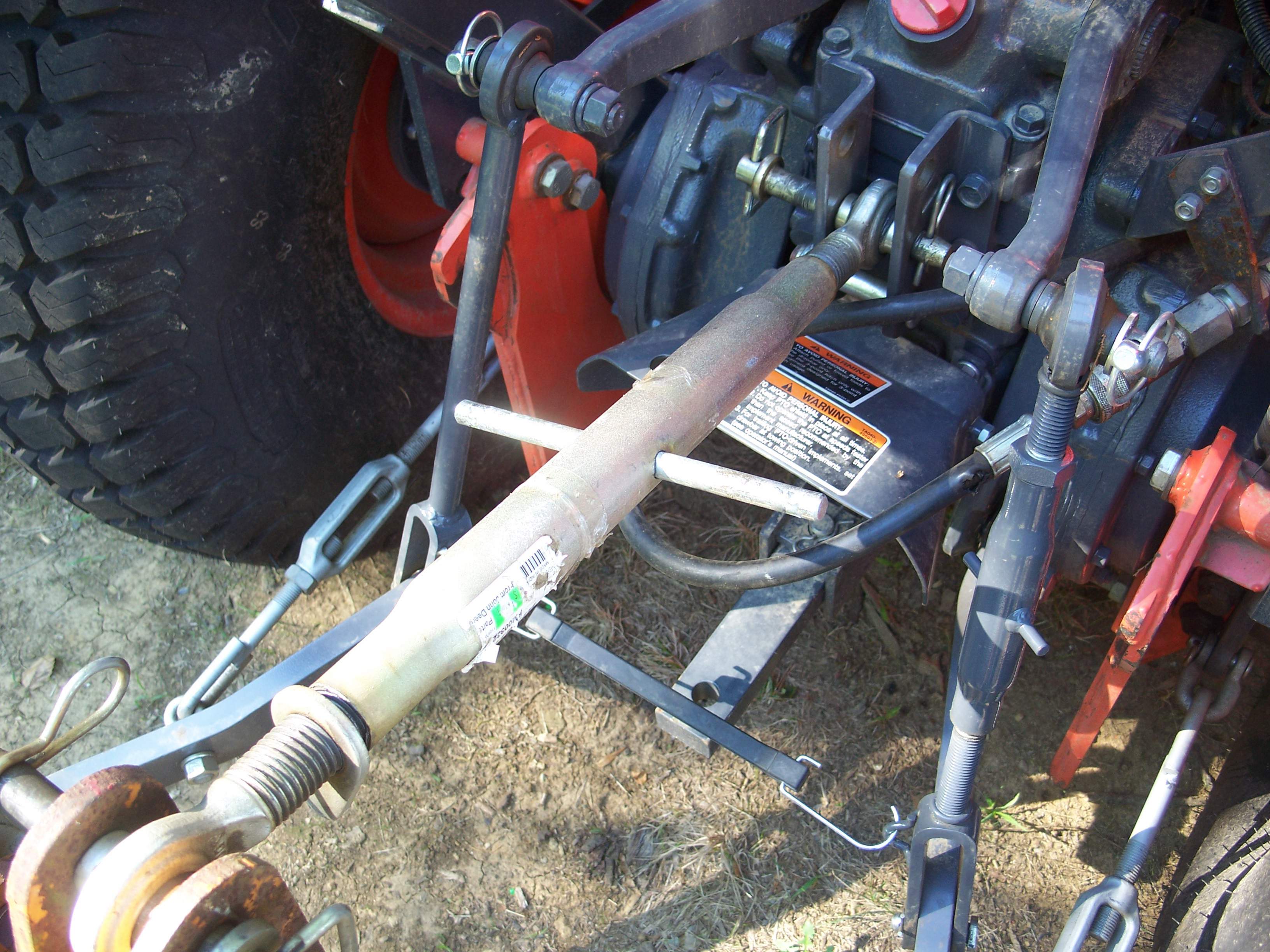

Thanks, 1savoy. While I'm really happy with the machine as a whole, there are some niggley problems that diminish the fun.
I'm going to cut down my 3-pt. lever and modify the loader control stick so I can get on and off from the right side. I'll have to get a RH fender handle from a Grand L.
Two other issues are the top link and adjustable side link; pretty cheesy. I prefer those I've seen on the Deere 20 series tractors better.
I've already swapped the top link for one I picked up at my John Deere dealer, that's burlier and much easier to adjust.

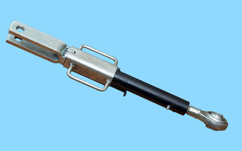

I'm actually referring to the lifting rod that's on the right. I'd rather have something with better mechanical leverage, that can be adjusted without a wrench, like this one below. A new Deere 3320 I looked at had one just like it.
The check chains don't bother me since I've set them at a width that luckily happens to work for all of my attachments.

I put a short length of pipe in my toolbox, the hole slips over the pins on the right side three point link to turn it easily.
I cut about 6 inches off the FEL lever, much better now. Shortened the gear shift rod too(mine's a DT model) so now I can get boots behind it when it's in 2nd or 4th gear.
