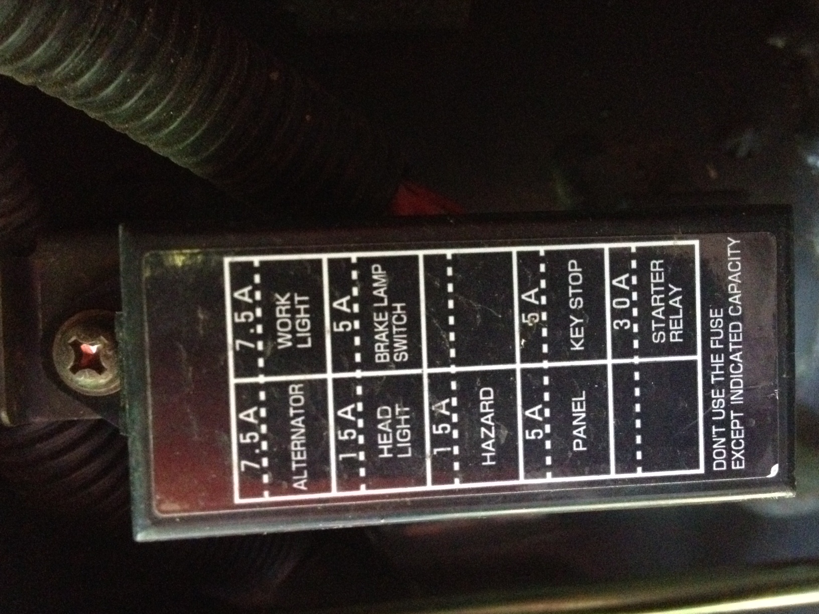

Could an L3130 HST owner tell me which fuse goes where?
My fuse box has had the diagram worn off that shows what fuse goes in which position. This is the fuse box by the clutch that contains automotive type fuses.
As far as I can see the owners manual does not contain the info... neither does the shop manual.

   / L3130 fuse box diagram worn away #3
Rest assured that it is not my intention to lead you on the wrong path. I have a Kubota L4400, and a illustrated diagram of the fuse box panel that you are referring to is outlined in my Operator's Manual toward the last few pages. I realize that your tractor model is different, but perhaps you might take a look toward the last few pages of the manual that you have. If this doesn't help, perhaps the parts department of your local dealer will be kind enough to photocopy a diagram of the fuse panel? Best wishes. Hopefully another 3130 owner can offer a better solution?
   / L3130 fuse box diagram worn away #4
I hope this is what you need.
That is EXACTLY what I need.
Thank you!
