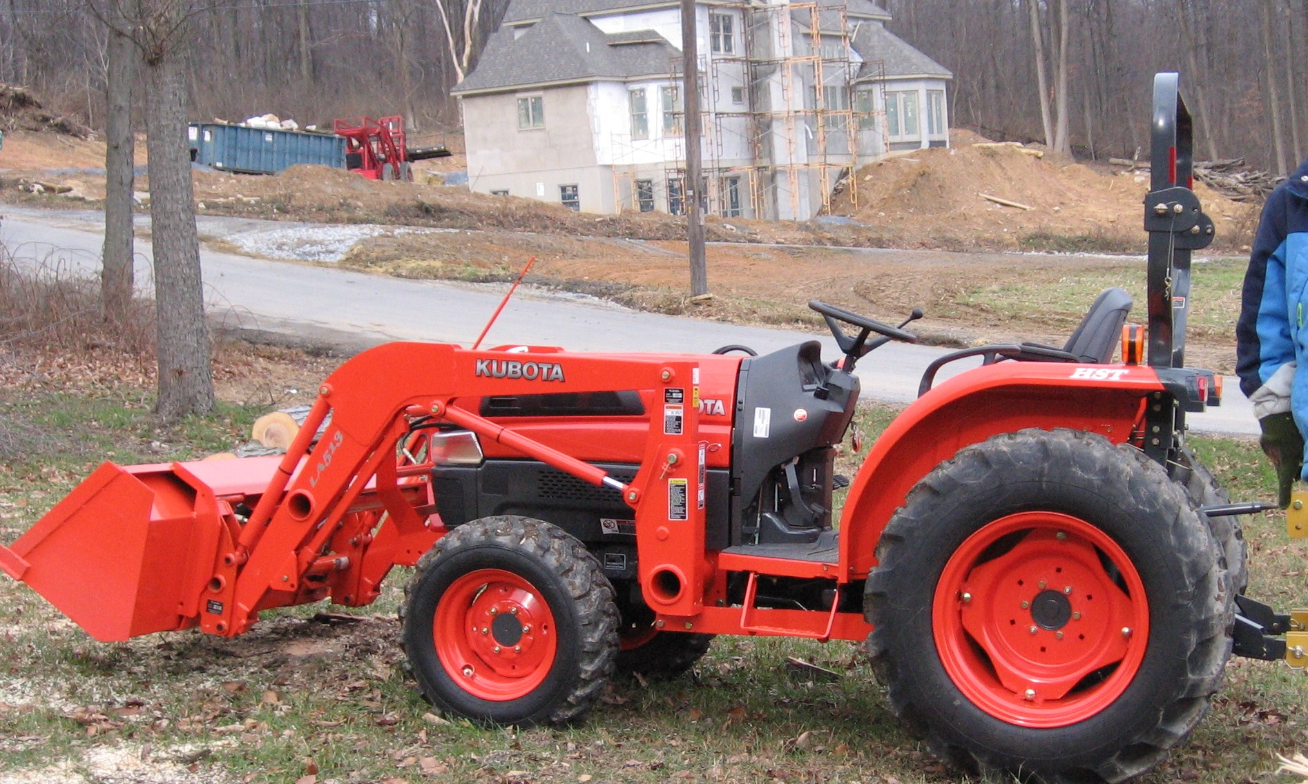

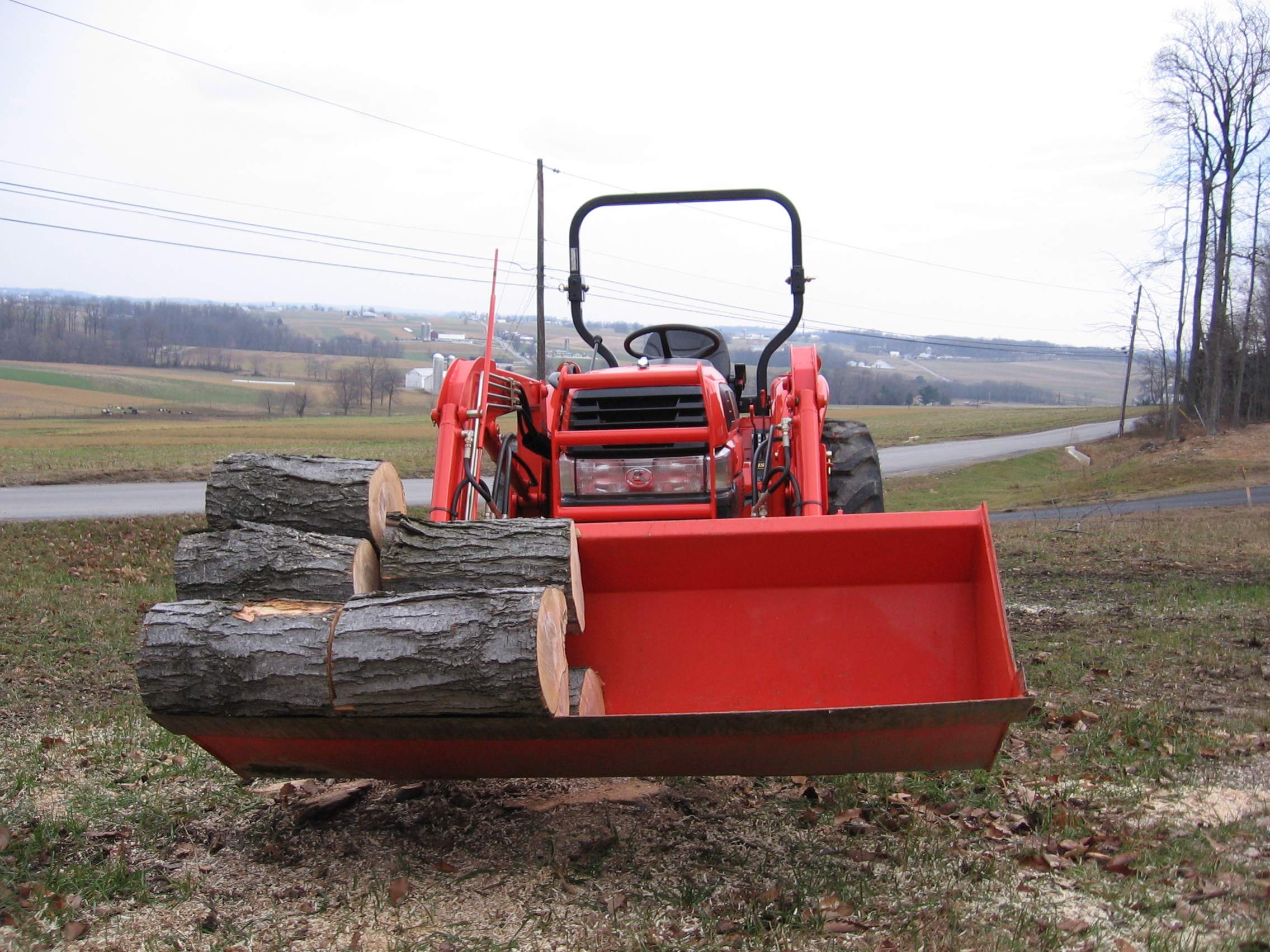

BTW though I would show off a bit with some pictures of the tractor and my property. Other than the bucket issue I really like the tractor!
