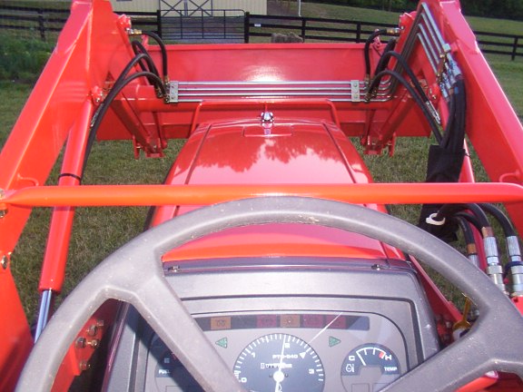

<font color=orange>A view like this</font color=orange>... Or <font color=blue>Blue</font color=blue>.
