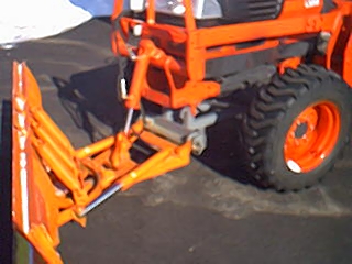

Winter of 2001 I purchased a used Meyer's 6 1/2' snow plow. To mate the plow to the Kubota,
I first had to fabricate a sub frame. The sub frame was made up using 2"square tubing(1/4" wall)
and various sized angle iron. To the plow, I added a hydralic cylinder,power up,down, and float
functions. Winter 2002, I added power angle function, and extra spring (3 total) to the trip feature.
I have a 500' drive plus large turnaround area. The plow and tractor combo,work well together.

Can't see the pic - something must have happened on the upload - but I really want to! I want to try to do this for next season, so I thanks for your input!
Mark
   / L3010 Meets Meyers Snowplow
Sorry! I didn't have a picture for you on your first visit. I have since re-submitted one,hope you enjoy it.

That is really nice!
Love to see more pictures of the sub frame and how it is mounted and so on, if you ever get the chance to take and post some.
Nice installation!

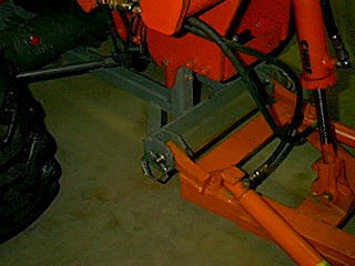

Took another picture,shows more of subframe.

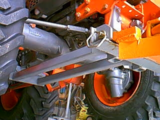

More L3010 plow subframe pictures.

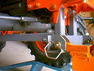

More L3010 plow sub frame pictures.
