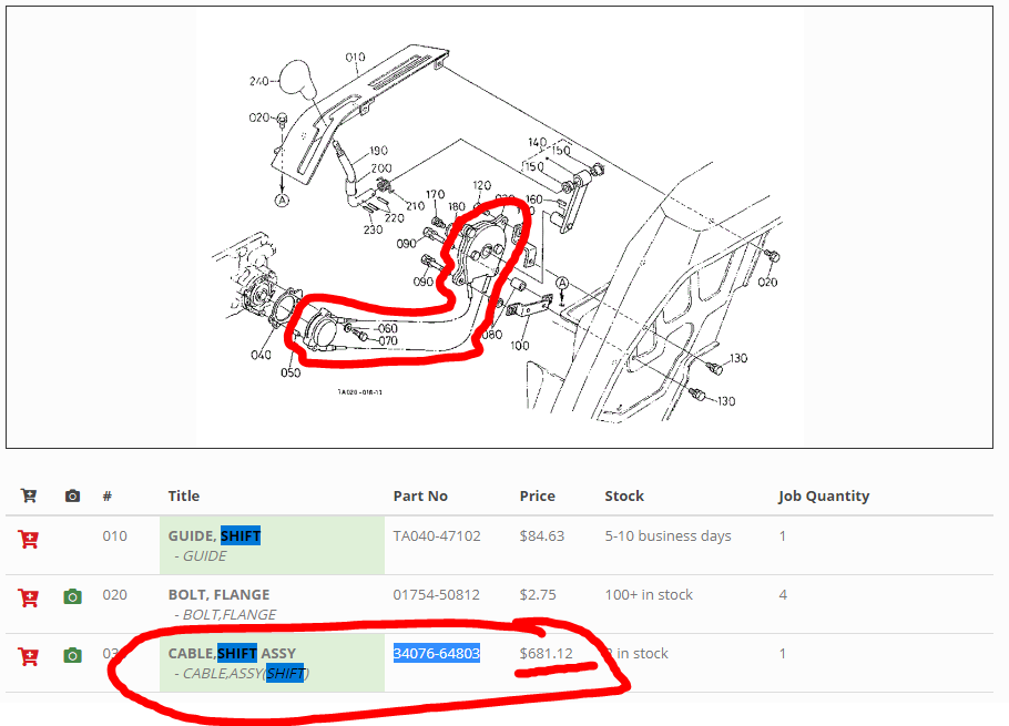

Yes. I found the problem....it is one cable of the cable shift assembly. I took it off the tractor by removing the rotary valve housing, then I separated the upper housing that the shifter attaches to and removed the cables. The white upper cable going into the rotary valve is frozen within the cable.
So here is the issue: You can't just replace this $10-$50 cable, you have to purchase the whole cable shift assembly from Kubota for $680.00!!! Unless someone knows where I can source these cables? Right now I am trying to free it up.
Thanks.

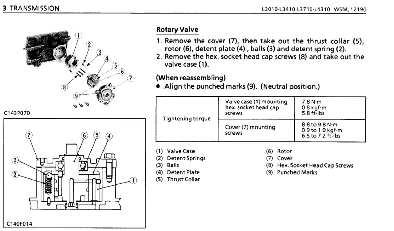

Does anybody know how to re-assemble the rotary valve without the two indent balls falling out? It is killing me. Here is a picture with the springs. The balls are supposed to stay on the springs somehow while you insert the indent plate. I have no idea how.
Thanks.
