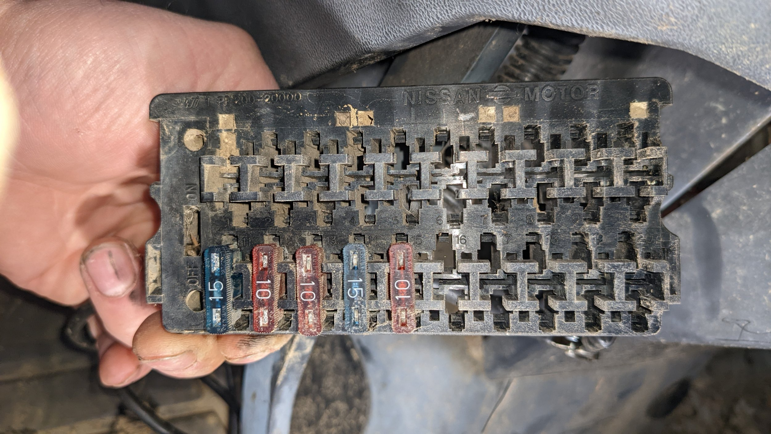

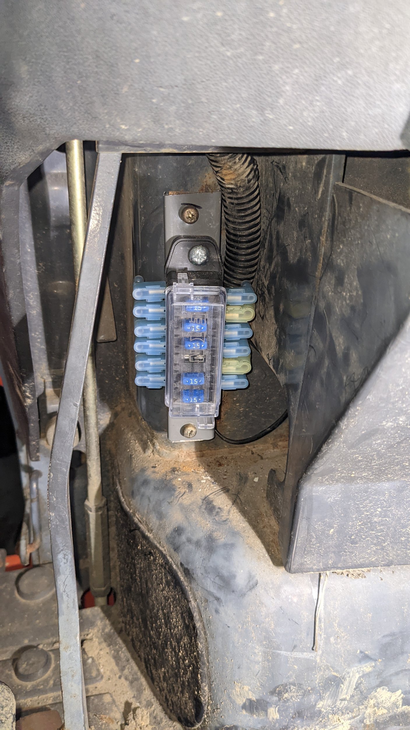

Hey I went through some issues on a L3010 that I borrowed off a friend and thought I'd share this on a somewhat recent post about this issue. No lights worked in the machine and the emergency shut off knob had to be used to shut it off. Fuse block terminals were rotted out so I replaced the fuse box with a 6 circuit one from Autozone. I soldered 2 bridges inside of it so I have 3 key off and 3 key on circuits. I had to cut all my wires back about an inch to get good copper. I have just blank connections on the unused terminals so nothing can ground out. Everything works great now.

I know this post is a few years old, but I'm having the same issues with my 3010 fuse box. The bottom of the box is so corroded that the terminals broke off.
I was thinking of replacing with an OEM box.
Can anyone tell me how you get the wires out of the old box and into the new one so I can still use the original connectors?
I'm thinking OEM since I don't have a wiring diagram.
Thanks

Your choice as always, but reusing the connectors is just keeping much of the problem in the system.

I just wasn't sure how the connections are made within the fuse box, but I thought if I could get the old ones out without destroying them, I might have an idea how to install the new connections into the new fuse box.
Can't seem to find any images or information on how to do it.
