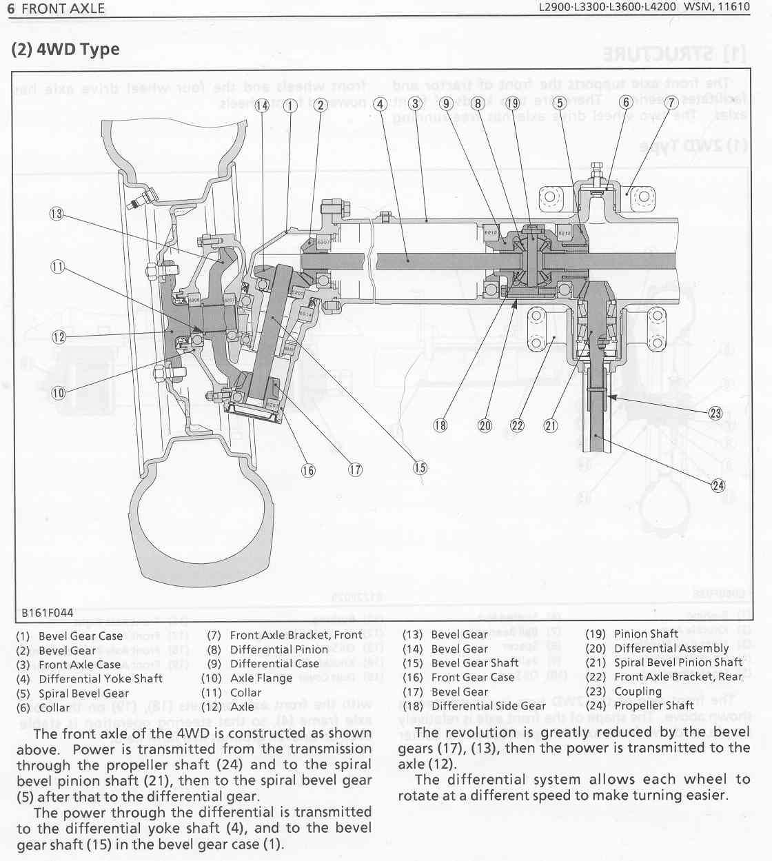

I've owned my L2900 for about 7 years and when doing a front axel lube change I noticed alot of play in the front right wheel. I'm assuming wheel bearings.I contacted the local dealership and they estimated $600 to $1,000 plus pick up and drop off.
I'm pretty mechanical and am considering tackling this repair myself. Has anybody done this repair? Does anyone have schematics or service manual instructions for this repair? Anyone have tips / tricks for any tough proceedures? Any other suggestions on what may be causing the wheel play?
Also, while I have the axel disassembled I want to replace the axel case seal (where the axel rotates for stearing). This may have been the cause of the wheel bearing failure. Any tips / tricks, schematics for this repair?
Any help would be greatly appreciated!
Thanks,
Dirk

Dirk...
Looks like it should not be too big a problem. For those labor prices I would certainly do it myself.
Here is a print from my WSM. KennyV.

I have done a couple of them. It is easy if you have a few tools. Good snap ring pliers are a must. A couple hours per side will pretty much take care of it. The WSM is very helpful and everyone should have one for there tractor if for no more than keeping the bad dealers honest.

-Go online and down load a schematic diagram of the front axle case. This will show you all of the parts and assembly order.
