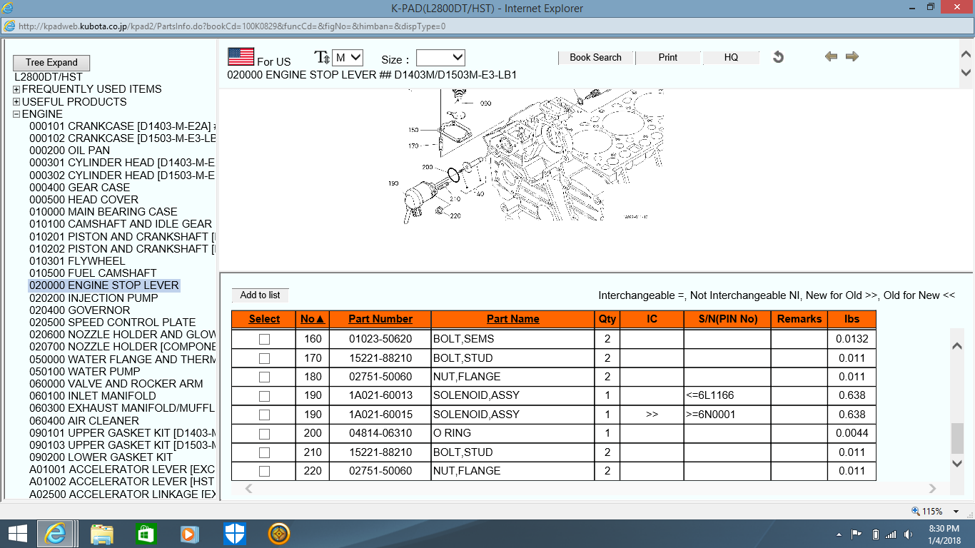

Been nursing the fuel solenoid for a while but it needs to be replaced. The parts fiche shows 2 different part numbers depending on S/N but the numbers don't seem to correspond to my S/N which is 57615.
Any idea which is the correct solenoid.

No ideas about the S/N????
   / L2800 fuel cut off solenoid,,, which one?? #6
I would lean towards the first one since 57615 should be earlier then the 6L1116. Call up the parts guy to double check.

Still scratching my head trying to figure out that logic. Different number of digits, combination of numerals and letters? Anyway the issue has been figured out. Need the engine serial number instead of the tractor serial number. And both of those parts on the fiche have been superseded by a new number... 1A021-60016
