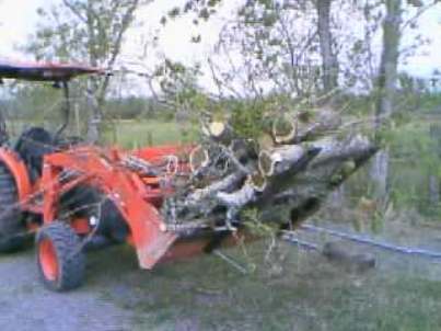

I purchased a set of paynes clamp on pallet forks. I almost sold them after buying QA pallet forks but found clamp ons to still be very useful for some jobs such as adding additonal capacity to the FEL bucket when hauling tree limbs or lumber that wont fit in the bucket.. The small stuff goes in the bucket, the larger/longer debris goes across the forks. Keep in mind here this load if fairly light for its size. Click on the poor quality phone pics for a larger image.

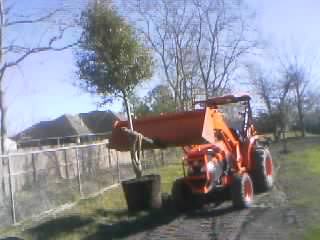

Using just one fork has come in handy as well when planting medium size trees.
Many here on the forum gave good advice regarding the pros and cons of clamp on forks. If you do not approach a load straight on they have a tendency to move regardless how tight you clamp them. They also have weight limitations.. I somehow bent one with my LA 463 so I have to be real careful when using them on the LA854 loader.
If you are doing a lot of heavy pallet work I advise against them, purchase QA adjustable pallet forks..
Good luck.... Chuck.
